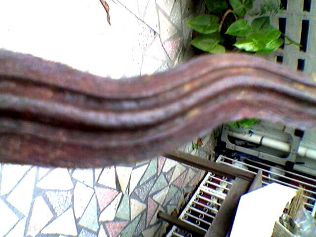

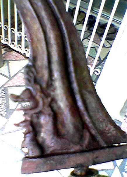

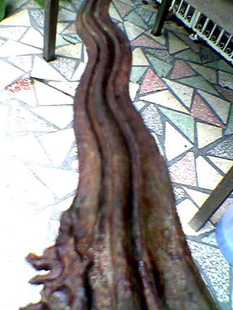

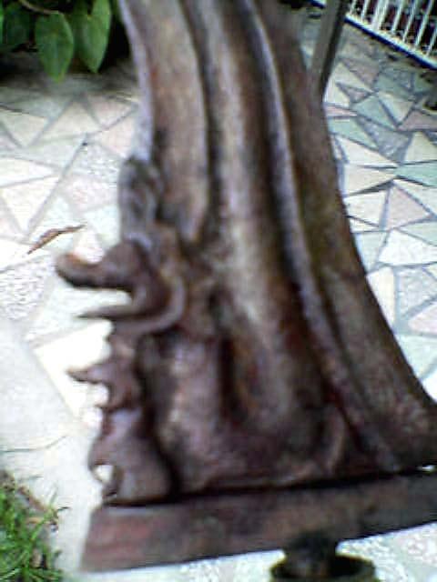

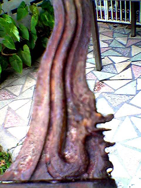

Sorry guys, the title is just a gimmick . All photos taken through my hand phone camera so pls expect some blurred pictures. How I wish, I could have brought a proper camera but not allowed for the second time. This keris belonged to a very reputable Bugis family, newly dresssed (1960s) in Malay style. This keris has some interesting history to it. To my surprise, I was shiverred to see the blade. Could it be a Javanese blade, A Semenanjung blade, Sumatran Blade or a Bugis blade? I would give age to about 1600s, non laminated blade with two mosters namely a Dragon and another motif down under it, which I could not identify.
It has deep fullers to the tip at both sides, just like an ordinary Malela blade. Any comment?

The blade is in a bad shape of maintenance -- rusted all over. It's ironic that a pusaka held in such high regard would be treated so badly. You might want to gently advise the lederly owners to have it cleaned.

Agreed with rahman, the rust is obviously very bad.
Although the piece is esoterically imbued, maintenance is still required.
In Malaysia, (KL), Rasdan should be able to do a good job treating pusakas.
Picture of the entire blade with the ganja should be helpful to find out something about this piece. Picture is too blur to tell much.... Sorry.
It looks like the top is a naga and the bottom is a singa barong...(from the blurr pic.)

Is this the keris that u had been telling me before? Im suprised it is a naga. If this is the piece, i can sure say that it is authentic. It seems unusual to have both naga and singa barong on one keris. However, i dont think we can accept this as a malela. Its the wide groove alongside the naga that makes it looks like fullers. Thanks for sharing, however, now that u had shown the keris pictures, in a few years, naga-singa kerises will starting to reach the shores of malaysia from madura. Perhaps someone can help to identify wheather the naga is javaneese or malay. On the other hand, i havent seen any singa on a malay blade.

Naga kerises normally can be found on Javanese, Maduran an Balinese pieces. There are instances where the dressing were changed into Malay/Bugis dressing. There are examples at many museums. But a naga-barong, this is the first time I'm seeing. Thanks for sharing...

Nice keris, bad rust You should clean it the first time you have a chance. The keris's shape (dhapur) certainly not the ordinary one. The two deep fullers are intended to raise the middle part of the keris, so the middle part resembles the body and tail of "naga" snake. It is not the sogokan. Perhaps the blade was made in java, but i'm not quite sure before handle the blade by myself The bugis peoples are well known as the good sailors and merchants, and their ancestor had travel throughout the archipelago.
One more thing, I believe the blade is very finely laminated. You may see the fine layers of iron under magnifier, AFTER you clean it. So, just clean it Mykeris, after you get the permission, of course
