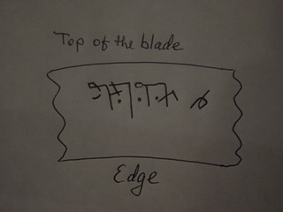

I once asked for help in reading the inscription, but had no luck.
Now, with the proliferation of multilingual forumites, I may have a better chance.

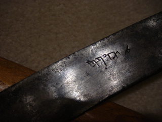

Gentlemen,
Though it is not executed in a particularly literate hand, the inscription appears to read AGHA 'ALI.
When a given name, in this case 'Ali, is preceded by the word AGHA on an Ottoman weapon or piece of military equipment, it may generally be taken as the name of the head- or leader- of the military corps or unit to which the owner belonged. When the term AGHA follows the given name, it is more generally an honorific like 'lord.' Since this type of yataghan was often used by Ottoman village constabularies, it may be that 'Ali was a chief of police.

Its Arabic script, but upside down and poorly written. I'm not sure about 'Ali though, there seems to be a dot abve the letter 'ain, although that could actually be a letter 'meem'.

It does look like a mim, doesn't it. I had to run it through several steps in photoshop to get it clear; there is a narrow opening at the beginning of the character. I suspect the dot above it is fanciful as they often are in cases like this one. The whole bit is rendered phonetically and without much attention to case. Interesting though that the engraving itself is quite competent-- this would seem to argue for a skilled but non-literate, or barely literate, craftsman.

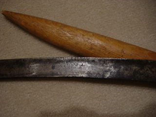

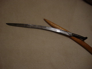

ham, yes Ottoman palace environment got and used many Farsi words, i think agha or aga as Turks write, is Turkish.Perhaps from the ones which passed to Farsi later. It had and still has one more meaning, "big brother" in Turkish,which I think is not used in Farsi. even Turkish inscriptions from 6th c. a.c. in today's Mongolia uses ata=father, ana=mother, ene= sister(not used today), aga= big brother etc.. In steppe, father was the certain and only leader of all family , and after him was coming the big brother as the potential leader after father's death. The respect shown to big brother and loaded on the word, caused it later to be used for militaristic and feodalistic chiefs too, to obtain the same respect against ordinary people(especially after Turks came, settled and had feodalism in farmlands of Iran,Mesopotamia and Anadolu).
Ali agha means the sword belonged to a guy named Ali, who is a bit or more over the average wealth and respect in a Balkan or Anadolu village or a countryside town. (Doesnt necessarily have to be the owner of a whole village or huge lands, but could be too)
Nice piece. The scabbard wood original or later? Looks surprizingly well preserved for a scabbard whose leather cover has worn and been lost. The lack of the craftsman's literacy didnt surprize me at all.It is too normal for the era and a village or small town. I am sure, the owner wrote what he wants to a paper, and ordered the craftsman to inscribe it onto the blade, and the guy who had never gone to school or written anything on paper, just tried to copy the shapes he saw.
