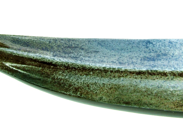

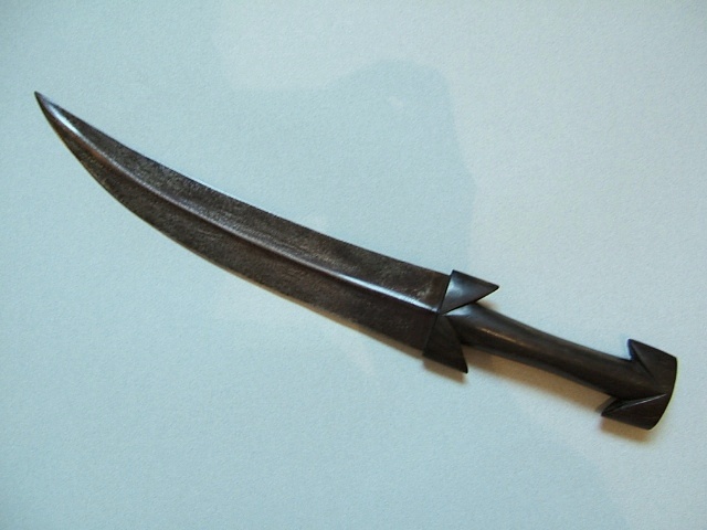

Just arrived the other day a large horn hilted Albanian jambiya. I sanded down the blade with 600and 1000 grit sand paper and etched it. The blade turned black instead of the normal grey but I don't know if I see any real pattern? So this is probably not wootz?

sand it again cut your solution to a 1/2 to 1/4. I assume you are using ferric chloride. It still may not show pattern but your concentrate is to heay right now

I sanded it again and used a weaker solution and I am definately seeing a wootz pattern starting to appear it shows swirls but seems low contrast it will need more coaxing.

You always better off starting with a lower concentrate and just repeating coats over and over again

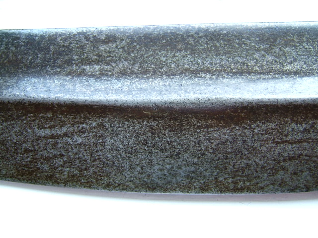

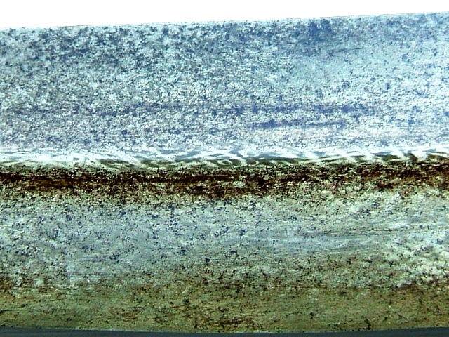

Here is a better pic you can see the pattern but it's not high contrast.

Another nice find Lew,
How are you etching it, dipping or painting on?
Would switching to citric acid now make any difference?

Try a drop of soap in the solution instead (prevents beading) .
I still haven't changed my opinion on an etch thread .
