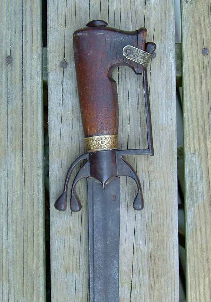

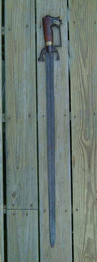

What would we call this one with a backsword blade; Sayf ?
I would think so .
I've always understood the ring guards to indicate locations other than Morocco and Algeria .

Old 21st July 2008, 01:47 AM   #10
Posts: 6,441
Originally Posted by ward
generally when refering to a nimcha you are referring to the horn handle the knuckle guard and the distinctive quillions. The blade type is basically not a issue. If you look at the one originally posted the quillons are different and the grips are wood (they look original). That is why it's origin is different close but not not the mark.
Okay then, we can throw out the 'short' requirement and my example is a Nimcha ?

Arrow
I've got a feeling the blade itself is quite old .

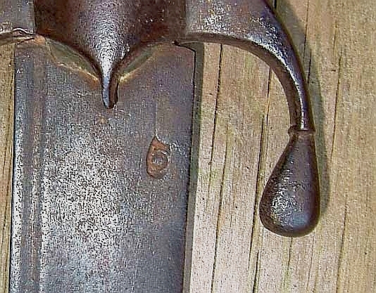

Familiar with this mark Ward ?
We've had no luck so far; IIRC someone (maybe Derek?) thought it might be French .
Any ideas ?

Artzi's statement is of course right on target, in fact the ring guard example I got from him was one of a large group made in Zanzibar and exported to Yemen. Buttin's reference in the 1933 work concurs with these being Zanzibar made for Arabs.
Since the 'nimchas' of Morocco always carried trade blades from varying centers, primarily Solingen, they were nearly always full length and many were 'backswords' (single edge straight blades). The term sa'if is simply the term locally applied to these swords, and as noted, is a general transliteration. It is interesting to note that in the Sudan, the kaskara term is completely unknown, and these broadswords are called....sa'if!
The 'nimcha' term for the Moroccan swords with several drooping quillons does actually apply primarily to the distinctive hilt style, disregarding the blade it carries. This hilt form actually developed from early sabres from Venice of the storta type**, and existed early in the 17th century in Morocco, in fact there are portraits of English figures wearing them in that time.
Rick the example you have is extremely nice, especially the great patination! It is one of the early ones, 18th century to be sure, and the blade stamp as previously discussed pretty elusive. I remember trying to find it in all the standard references, and doesnt correspond directly with anything in particular.
