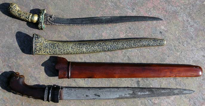

I used to think that pamor was exclusive for keris or tombak but this is neither;(the bottompart of the pictures) no keris no tombak but still Pamor...
Please gentleman, would you be so kind to tell me tell me what it is (maybe even both of them) and why it's has pamor...

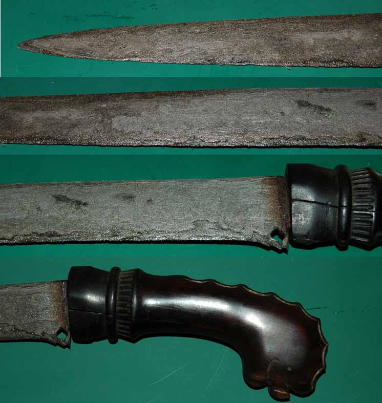

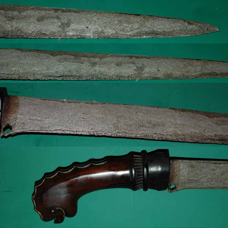

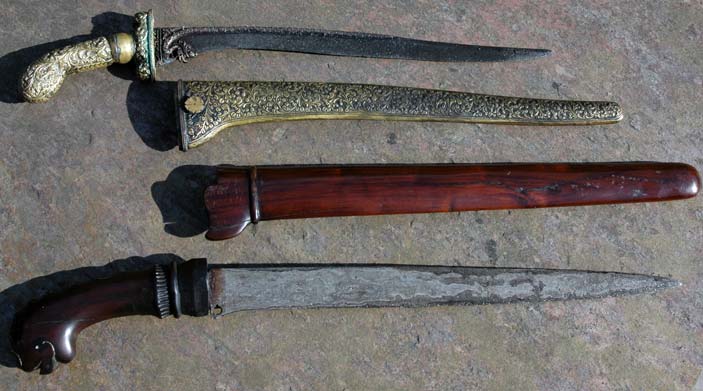

As promised some pictures. I fotgot to tell that its origins are from Solo,
At first I thought it was a golok but I don't understand that pointed shape...

The contrast in the later pictures is less due the conditions of the light when I was taking those pictures. For the real contrast, please, take a look at the first pictures.

The pamor question is easy:- its simply a method of blade construction that provides a practical and economic solution to construction of a durable blade with a sharp edge.
The fact that over time that it became a means of blade ornamentation is something else entirely.
IMHO, both are "pedang suduk" (thrusting pedang?). The naga relief, in javanese term we call it "naga tapa" (meditating naga)...
