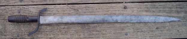

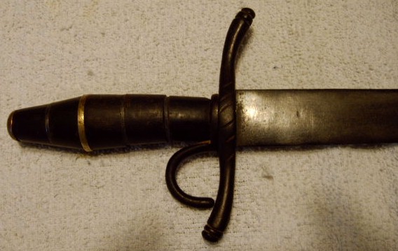

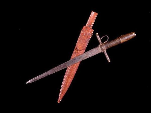

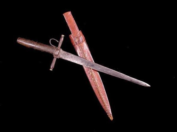

Hi Jim,

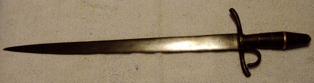

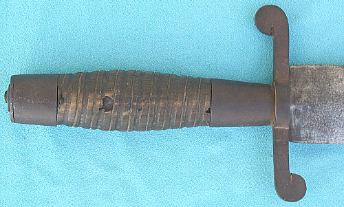

Here are a couple daggers and a couple of swords that I think might fall into what you are talking about. These have all been previously discussed on the forum but if anyone is interested I will post links to them.
Robert

Hi Robert,
Thank you so much for responding!
These very nice examples you have posted indeed represent the types of weapons I had mentioned in the Phillipines, and though not directly 'espada anchas', they do illustrate the Spanish influence on these weapons.
The example with the interesting finger ring is typically identified as a 'Central American dirk' and as part of the Spanish Colonial influence sphere ( Levines, revised 4th Ed.1997, p.461, A.8).
The Spanish Colonial heading covers a vast part of the globe, and thier colonization and trade naturally accounts for the diffusion and influence of weapons of many forms throughout the 17th-19th centuries. It seems that a great deal of misconception and misidentification is relatively common due to the often shallow understanding of the dynamics of this important history.
I am hoping that others here might join in this discussion so that we can learn more on this topic, not only on the espada ancha, which is associated primarily with New Spain and Mexico, but Spanish Colonial weapons which were often influenced by them.
Thank you so much for your very pertinant examples!

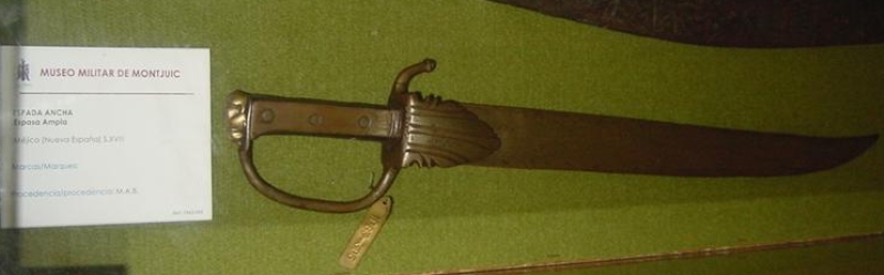

This is a (lousy ) picture of the (apparently) only specimen of Espada Ancha at the Montjuic Military Museum of Barcelona.
Fernando

Thank you so much Fernando!!!
What an excellent example of these distinct swords, and its great to know that they are indeed represented in the museums in the Peninsula.
I'm glad to see this thread revived, as I think there is a great deal more that can be included. Recent activity for example has revealed the Brazilian form of these weapons, and until now, to the best of my knowledge, the South American forms have not been included in resources on these weapons.

I didn't fix the text in the label but, with some effort, it can be read " MEJICO ( NUEVA ESPAŅA ) S. XVIII ".
Old 11th June 2008, 03:41 AM   #11
Posts: 7,416
I would say that the 2nd and last pictures of Robert Coleman's pictures look Filipino of Spanish influence from the turn of the 20th century, specifically Ilocos Norte region on the Island of Luzon.
Old 11th June 2008, 05:14 PM   #12
Posts: 10,867
Right on Jose!! The examples Robert posted were exactly the types I was referring to in my earlier note on Spanish influenced edged weapons in the Philippines, and nice ones indeed!!!
Thanks very much for the added detail on the regions these might be from, which really adds to the archived material I have hoped would become key in these threads. Your expertise in weapons and history of these fields of study has long been well established here, and I always look forward to the detail you add.
