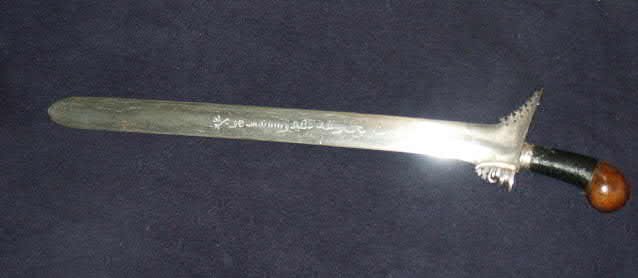

My contribution is this, quite often seen, inlay on a Moro Kris.
I haven't found out the meaning of it yet, have you?

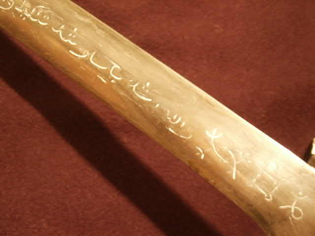

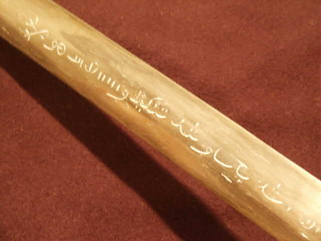

A Moro Kris inscripted on both sides. Many have probably seen the other inscripted side of the blade. Less have seen this side. To my knowledge Cato
has unlocked the meaning of the script. Refer to pages 21 (plate #8), & 102 of Cato's book.
Second photo is nearest the tip of the blade. Sorry for the poor quality photos, as to photographing it is difficult.

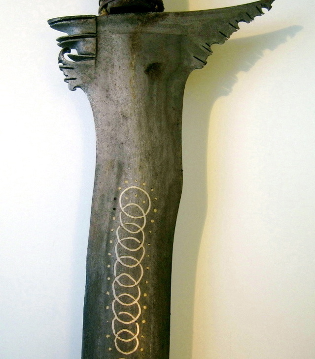

Kai,
On your Luma the vegetative vine motif usually represent the creative forces.
The end looks like a rounded version of the old trident symbol.
Probably it's then Shiva's trident from the old beliefs still existing within Folk Islam?
If so one mening of the inlay could be that it's directing strong metaphysical forces towards the direction of the point (=opponent)?
An alternative meaning I have heard is that some people think it's a Naga and the end is a tongue?
Michael

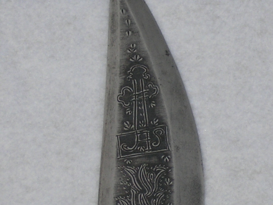

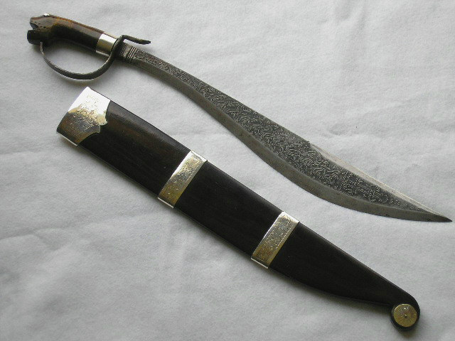

a sundang with some serious agimat engravings on one side. just like this one on macario sakay's bulletproof vest...

Ron,
Interesting Sundang.
Have you found out anything about the meaning of the symbols, except that it's of protective character?
Michael
Old 7th December 2006, 03:15 PM   #8
Spunjer
Spunjer's Avatar
Posts: 1,730
Michael,
it's the jesuit order's symbol...

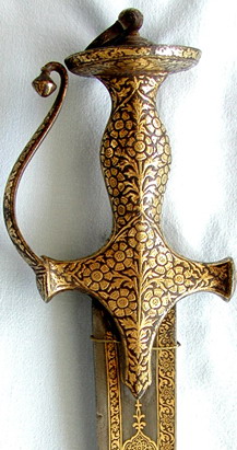

I will not bore you with writing about Indian talismanic markings, as it is not what this thread is about, there is however one thing which have kept me wondering. In none of the threads about krises that I have seen, is mentioned that is was also used in south India (see Robert Elgood – Hindu Arms and Ritual). I wonder why, and I think you would be able to find many interesting markings on krises from India.
The snake is another matter, as you will find it in most, if not in all, religions of the area, plus in a lot of other places, if you read about the peoples/clans/tribes saga about how the Earth was populated – so no wonder that the snake is an important mark.
In The Wonder that was India, A.L.Basham writes about the fish. ‘The fish (Matsya). When the earth was overwhelmed by a universal flood Visnu took the form of a fish, who first warned Manu (the Hindu Adam) of the impending danger, and then carried him, his family, and the great Sages in a ship, fastened to a horn on his head. He also saved the Vedas from the flood. ……’
Many of these old stories from the first religions will be recognised from religion to religion, and the fish was one of the scared marks used by several religions. Think of the trisulas, used over a very big area. Flowers used, were decorative, but I also think they represented something else, maybe a deity. Have a look at this hilt, with two fish, a big flower, on the other side two big flowers, and four trisulas, on on each quillon and on on each langet.
Sorry, I think I got carried away.

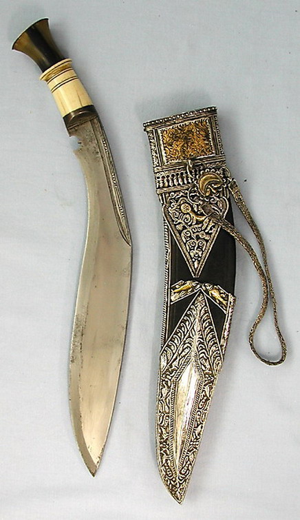

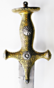

Let’s go to Nepal. I have a kukri, only one, but I like it a lot. As I don’t know much about these weapons I asked John Powell, and he very helpfully gave me the following text.
“The fish on a kukri is called ’matsaya’ in Nepali, and is very common. They represent the first incarnation of Vishnu, and are associated directly with him.
’Suvarna matsya’ are the twin golden fish facing each other, and symbolize being rescued from the ocean of misery of earthly existence.
The peacock is a very common symbol among the Nepalese, for good fortune, and used in many different designs.
The ’Hanuman’ is a half god . Half monkey and half human, he is portrayed in different manners and takes on a variety of positions.” (try to Google/Wikipedia. JN).
The Hanuman you can find on the top mount (the triangle one), the two golden fishes in the middle and the peacocks on the lower mount.

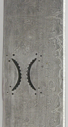

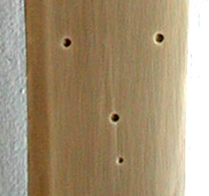

A thing, which has been discussed some time ago, is the three dots in a triangle. I don’t know what it means; I can only guess, but does anyone know it?
Colours and gemstones are also to be looked into, as both have a symbolic meaning, flowers have as well but it is a longer story.
Jens,
What are your beliefs about the three dots?
To me they suggest the trident.

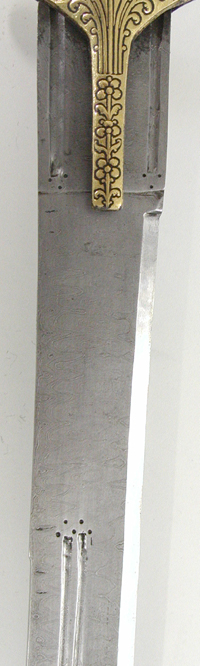

To me the three dots are either talismanic and/or religious as I think they have been used in two different ways.
The big triangle (first picture). There is only one triangle, and it always has the base in direction of the hilt. The dots can be like on the picture or bigger, sometimes with inlay. I think this could be religious, maybe representing Vishnu, Brahma and Shiva, but I don’t know.
The small triangles like on the second picture starting and ending another decoration, here ‘eyelashes’, but I have also seem the small triangles at the start and end of fullers. This I think is more likely something talismanic, as if the ‘eyelashes’ ‘hide’ a message, and the triangles close the openings at the top and bottom – again pure guessing at the moment.
I hope we will find the answer one day, as I am sure it must be out there somewhere. To me it is strange that we, so far, have not found any explanation of the meaning, as the soldiers coming to India seeing these markings must have taken an interest in them, drawn them, and maybe even written an article about Indian markings – but where?

You often see this triangular dot pattern on Sumatran weapons too.
I am also guessing but I think it represents Mata Shiva, the 3 eyes of Shiva (2 regular horisontal eyes and one eye above in the forehead).
Maybe combined with the Lingam?
A triangle pointing up is a Hindu symbol of the Lingam (down is of course Yoni).
In the case you describe the Shivaistic male forces of the Lingam is pointing towards the enemy.
But because of the dots, instead of the fully drawn triangle, I think the main meaning is Mata Shiva and the secondary meaning is the Lingam.
Some other explanations could be the trinity of the main gods, as you suggest.
Mahadeva in which the three gods of the Trimurti are all seen as aspects of Shiva.
And then we have f.i. the three aspects of creation, preservation and destruction.
Michael
Last edited by VVV; 10th December 2006 at 09:01 PM. Reason: added alternative explanations

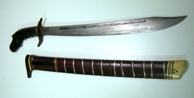

I have so far only seen the single dot triangle on Sumatran weapons.
And in all cases on the tip of the scabbard, not on the blades where other kind of talismanic inscriptions are used, usually Muslim.
The several small triangles probably are related to the large one but I have no idea how?
Michael
PS The example below is an early 20th C Aceh small parang with the triangle at the scabbard and Quranic writing in the fuller.

Thank you for showing the picture, i have never seen the triangle on a scabard before.

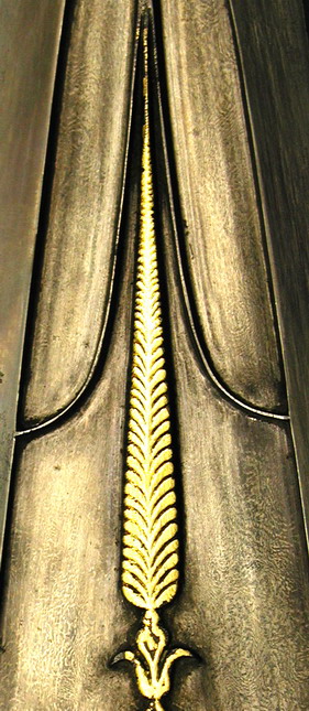

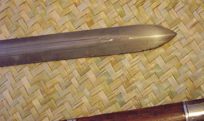

Hi all, is this symbol on the blade of a moro kris a talismanic symbol or just a decoration? I think is some kind of trident. Thank you so much

To me it looks more like the attached. Some call it a cypress, and others The Tree of Life.

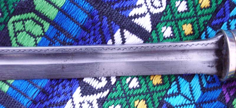

I remember this one. Actually it is both. Through use of okir (stylized vegitation motifs) this is a stylized naga - snake - with a tongue. It is to empower the owner and make the piece more deadly.
Old 4th April 2008, 06:09 PM   #29
Flavio
Flavio's Avatar
Location: Italia
Posts: 1,243
Thank you Jose This symbols are on a dha... some kind of SSSS...
