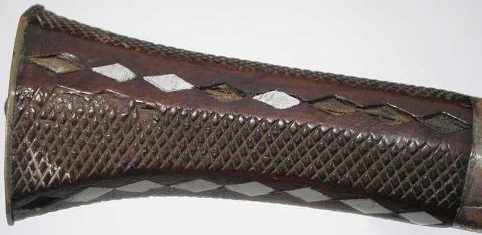

Old 12th April 2008, 07:01 PM   #8
she arrived today. spiral was right on in his last post - inlays appear to be aluminum. slight amt. of rust on bolster, blade had a few spots of rust and a light stain, but was generally nicely polished. some magnolia paint near the tip. scabbard is in good shape except it appears to have been dropped on the tip at some point, could do with a chape. there are some areas where you can see signs that the blade has been forged, then ground to shape. some light marks on the butt plate that look like it may have been used to hammer something, and a few batonning marks on the spine near the upper edge. the grip has some light damage to the grip where a bit seems to have been split off on the edge of the checkering on the lower side, it's all old damage and the area is worn and smooth from someones hand having caressed the grip over time.
photo's after a quick light clean and oiling.
grip length 4 3/8 in., guard 2" x 1 3/8 oval (octagonal with rounded 'corners') brass, blade width at guard 1 3/8, 1.5 in. at start of upper edge, 'false' edge is not false, it's sharp & 3 in. long, total blade length 13.25 in. blade is a hair over 1/4 in. at the guard, there is a shallow fuller down both sides which is apparent in the photos. octagonal brass butt plate is 2 1/8 in. x 1 3/8 in. and is held by the peened tang. there is a gearlike or sunburst like washer of about 1/2 in. between the peen and the butt plate.
all in all this is now one of my favourites. it's more of a short sword. love it. now i need to make 6 little aluminum diamonds....

well, i've done a bit of restoration on it, this was posted on a kukhri oriented site where some of us cross post...
before:
After:
cut diamonds out of old aluminum pan, flattened them, tried them in holes (4 on top row, 1 far left bottom row), trimmed as needed, mixed up some clear slow dry epoxy, filled holes with epoxy, set diamonds in holes, pressed them till they were flush, wiped off excess epoxy. let cure. next day trimmed with a razor sharp knife, sanded with emery cloth & crocus cloth to make sure they were flush and no protrusions, cleaned dirty original inlay far left top row. oiled. the 'white' on the checkering is flash reflection, they are a tad shiney after i oiled them & cleaned the bit of paint out of the grooves near the pommel.
