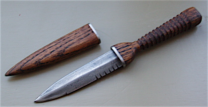

From my name you've probably realised that if not from Scotland I'm certainly of Scots/Irish descent. I actually live in the West End of Glasgow not far, luckily for me, from Kelvingrove Art Gallery and Museum the place which as a child first gave me an interest in Arms and Armour. You will all also know that genuine Scottish antique arms are on the somewhat pricey side and as as result, unfortunately, I've not been able to bag a sword, dirk etc., yet !!! A number of months ago my son asked me if I had a sgian dubh he could borrow, I didn't, I had lost the last one years ago and hadn't bothered to replace it. I decided to do something I had been thinking about and make one. Whether a son was being nice to a dad or not after I gave him the sgian he asked me to make him a dirk as well. True to my roots, some would say, for both pieces I rummaged about in the garage for bits and pieces, wood from an old Victorian wardrobe, various bits of metal including a shovel handle and an angle bracket and luckily a bit from the middle of a badly damaged sword blade. The results, see photos, are not the the most decorative of pieces being plain and to the point, no pun intended, but are strong, sharp and pointy in all the right places. I don't know if this is the right place for modern pieces but I think, and hope, they conform to the spirit of Ethnographic weaponry.
Norman.

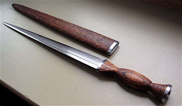

Hello Norman,
Thank you very much for posting, and especially for showing us these very beautifully done examples with indeed do reflect, in the beautifully written words of Paul MacDonald, the 'heart' put into these weapons. As you have noted, the true early examples of Scottish weapons are indeed hard to find, and typically quite high priced. While the objective here is to identify the forms and identifying characteristics of these early forms, your outstanding work certainly reflects the spirit imbued in these most important weapons.
Thank you again for sharing these!

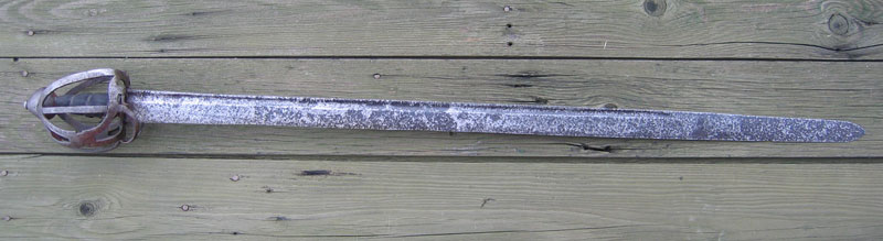

Hi,
Thanks for the kind words. I have seen many examples of both the broadsword and backsword indeed the museum I mentioned in a previous post has quite a collection of these artifacts. The one item that is seldom mentioned is the Claidheam Crom or basket hilt sabre. Although in the minority as regards Scottish swords it appears to have been in use alongside its more normal straight bladed contemporaries. It has been difficult to find any definitive statistics with regard to the basket hilt sabre and this has led me to wonder if this variant is more of a sword of opportunity rather than anything else i.e. a captured or purloined weapon rehilted. It appears reasonable that a perfectly servicable blade should not be disposed of or drastically altered, remember Scottish prudence and thrift, but altered to suit a new owner. I have read somewhere of a sea service sword being rehilted with a basket at the request of a British Naval captain but what type of sword or when escapes me at the moment. As to the origin of the basket hilt I don't think there is any one answer. Scotland in the 16/17th cent. had many, probably more so than now, and varied links with Europe and I believe that most armies of the time, as far east as Russia, had Scottish mercenaries or indeed full time soldiers as in the case of France. It doesn't seem unreasonable that ideas and fashion should filter back to Scotland through these links and that a basic basket type hilt, which with the loss of armoured gauntlets was an obvious progression, should be adopted and enlarged upon and taken up by so many that it developed into an archetypal Scottish feature. Many cultures have taken outside ideas and made them into their own I don't see any reason to doubt that various forms of basket type hilts were in use throughout Europe and that the Scots just took the form to a greater degree than anyone else. Of course this is conjecture on my part but in my experience a lot of highly individual and stylized forms tend to evolve from a lot of different influences rather than just happen. Anyhow I am eager to hear more from other members on this most interesting subject.

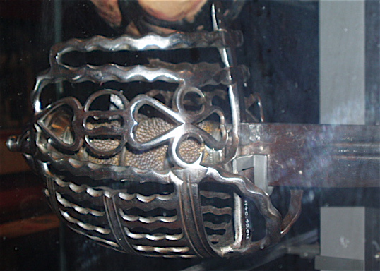

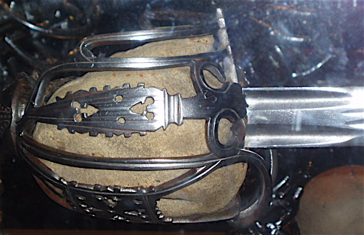

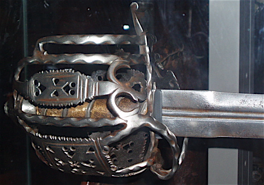

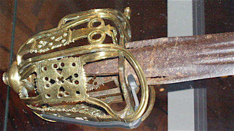

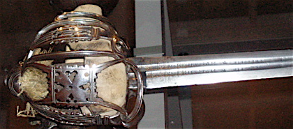

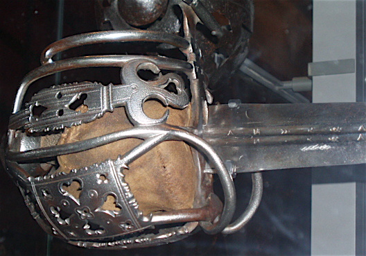

Some baskets.
Old 14th February 2008, 08:56 PM   #10
Posts: 10,862
WOW! Norman, now thats what I'm talkin' about! Very nice photos that show detail beautifully. Very well thought out observations on the origins and development of these swords, and it really would be difficult to draw a direct line of progression. All we can do is look at the provenanced and dated forms from the various regions. I have been trying to recall where it was that it was noted that the 'schiavona' connection was discounted and it was shown which early writer had begun that theory, I think it was the article in Caldwell by Blair on the baskethilts that referred to the misperception, and if not mistaken, it may have been Guy Laking that suggested the schiavona origin. According to what I have read, it seems that Drummond in "Ancient Scottish Weapons" (1881) illustrates several schiavona in his book, and possibly that may have insinuated a connection.
It seems that the developing basket type hilts for the schiavona, the Germanic forms including that of the Landsknechts, so called Sinclair sabres, and English forms were all contemporary in the mid to latter 16th c.

Some baskets.
Norman, are any of these captioned or noted on identification? Are they from the museum you mentioned?

Hi Jim,
These are some from the collection at Kelvingrove, I will go back with my notebook and do things a little more properly. The Arms and Armour Curator has left recently and a new one appointed but he has not yet taken up his post. When he does I'll see if I can get better access and photos, I can't promise anything but I'll try. In the meantime give me a few days and I will get info to go with the baskets.

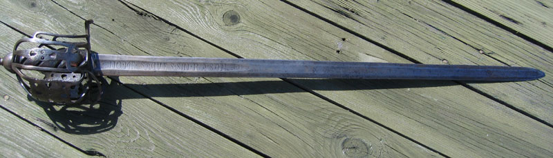

Aye, a good thread that`s nice and close to home, folks
From the photos posted, the one second from top appears to be a Walter Allan hilt from Stirling. The top one appears to be a Glasgow hilt in the style of Walter Allan, but I`m not sure if it is made by himself.

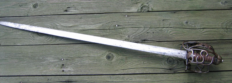

Hi Fearn,
Scottish basket hilts are either symmetrical or asymmetric in form.
If asymmetric, then when you are looking at the basket from the open or back side with the blade pointing down, the left side of the basket is made slightly larger to accommodate the knuckles and back of the hand.
Here`s MacGregors sword (more on this and others later), which is made in this way -

Paul, is this the Rob Roy sword?

No problem Fearn,
And aye Jim, that`s MacGregor`s sword. That is, before restoration.
The top and middle scabbard mounts were still fused to the blade, the rest of the scabbard leather gone, and the sword rusted overall.
It`s taken a lot of work to restore as far as possible and is still ongoing.

Paul,
The MacGregor sword is very interesting.
I have a great big question;
How could such an important sword bw allowed to get into such condition? I am a bit out of touch....but could you fill me in on how and where it came to light?
I do not want to take up your time, but would be very intrested to know.
One more question if I may;
Was the basket hilt always lined?
I was of the opinion they originally had a leather, velvet or some other lining, but the person I discussed this with, was of the opinion that the lining was a 19th century idea.
Thank you for your time Sir.

Hi Pukka,
I`m happy to answer your questions.
Regarding the discovery of the sword, this came about after I received a commission to restore the original basket hilted backsword of Charles Stuart of Ardshiel, the Jacobite commander of the Stuarts of Appin at Sherrifmuir and Culloden.
This sword has been passed down in the same family for generations, and it`s continued provenance was that this was the sword used by Ardshiel to face and defeat Rob Roy MacGregor in single combat.
It was on the back of receiving this sword that I chased a local legend from my original Highland homeland of Moidart. I was years before told of the story that a local family possessed the (or an) original sword of Rob Roy MacGregor. The provenace is like most Highland traditions and oral in nature, handed down from generation to generation. That is, MacGregor in his last days gave the sword to one of the MacLarens, from whom MacGregor rented his croft.
It was then passed from that family to the MacRaes of Moidart a couple of generations ago.
I have found but one contemporary description of MacGregors sword, which was described as a `broad and stout blade`. That which I received from the MacRaes is certainly that. It is noticeably broad, and overall on the heftier end, but well balanced all the same.
The sword has been in the hands of a private family and was treasured by the father, who passed away around 10 years ago. Since that time, many of his possessions, including the sword, were put into a byre beside the crofthouse, and no doubt much of the corrosive damage has been caused during this time. As far as the mother was concerned, it was just an old sword.
Unfortunately, the elements corroded away the original leather scabbard and basket lining, and likely also some of the grip material, as well as causing surface rust over the entire blade and hilt.
I visited Abbotsford house to see the Rob Roy sword there and other weapons that were purchased by Sir Walter Scott in the C19th. To be sure, the blade on Scott`s MacGregor sword does not match the contemporary description, and his `Rob Roy sgian dubh` is clearly early - mid C19th.
Check out the following threads for further pics and info. regarding the swords of Ardshiel and MacGregor -
http://forums.swordforum.com/showthread.php?t=80549
http://forums.swordforum.com/showthread.php?t=82635
Regarding basket linings, there is plenty of evidence of original Jacobite baskets being either fully or partly (base of hilt only) lined in leather. This provides a rudimentary protection for the knuckles and thumb against the hilt. This is not so much because the hilts are restrictive. If the hilt does not allow full and free movement to hand and wrist, then it is best melted down to make something that is serviceable!
The basket hilted sword is primarily a cutting weapon, and cuts require sufficient blade movement to be effective. Full and free hand and wrist movement is essential for this and any good basket is of size and form enough to allow it.
Both grips were used on the Highland hilts, either with the fingers and thumb curled around the entire grip, or with the thumb running along the back of the grip, fingers slightly back to allow a fingers and thumb only grip. This may not sound as stong, but in the hands of a trained swordsman is just as strong and more accurate and responsive than a wrap-around grip.
Hilts allowing the thumb-back grip tend to be slightly longer in the hilt and grip and sometimes with a flat back to the grip.
The leather lining protection is more to protect the hand if any bars break or bend in towards the hand during use.
This was fairly common with Highland baskets, as the individual bars and plates have to be quite thin, otherwise, the whole hilt would simply weigh too much. This is easily evident with many mass produced basket hilts today, that may look the part but are far from serviceable, with too-thick baskets and muckle thick blades.
I have also handled and seen many original early - mid C18th military basket hilts with full leather lining, usually white on the inside and red on the outside. This is as much for show and matching the weapon with the redcoat uniform as it is for practical use.
The red lining became almost a standard feature of regimental basket hilt swords since that time, and is seen on most C19th Scottish military baskets, which are still made and used as the current pattern.
I hope that the above details are helpful for now

Thanks Jim for starting this thread, and what a treat to have the expertise of Paul Macdonald here!
Here a a few examples of Baskethilts in my collection.
This is a Stirling hilt that I have posted here before.

This is a S-hilt. I would love to here what the most current theory on the significance of the S. (Stirling?, Stuart? simple protection?).

Here is a English basket. Also called "Irish hilt" or "Twysden style". Although classically these are English I believe they were also made above the border.
