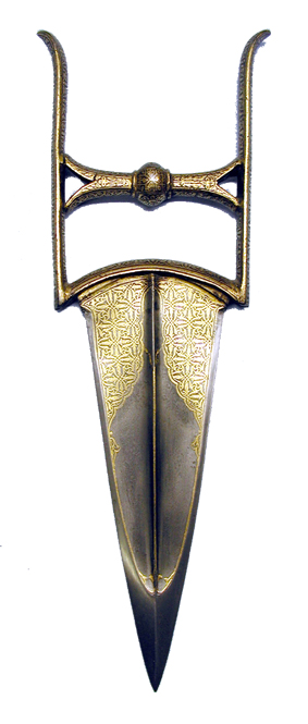

Old 3rd February 2008, 08:41 PM   #1

Any comments on this katar are wecome

Posts: 3,191
Wow very nice. It has a similar grip to my copper one.

Gorgeous piece, Jens.
What would be your coments ?

That is a very nice copper hilt, and I believe your to be older than mine.
Fernando, this was an experiment. Many show a picture and write ‘please comment’, so I thought I would do the same to see who would comment and what they would write.

Well done Jens!
I am always pleased to see the many extremely interesting weapons posted here, but often disappointed by 'look at this one' captions. There is a well established and outstanding core of knowledge here among not only the members, but clearly by readers who we always hope will join in the discussions. Gratefully most here openly share thier knowledge and by doing so promote active discussion with which we all learn more and gain perspective on the weapons being reviewed.To simply post something without personal observations that would give some thought on what makes the piece significant or what views are being sought is in my opinion, less than helpful. Naturally the case is quite different when an item is posted in response to a question or to illustrate a point in discussion.
That being said, I'm curious about the copper katar, which clearly has a very similar appearance to the example Jens posted. I must admit, I have seen very little use of copper as an overall hilt material, and would like to know more on this. We know of course that brass was a favored material in the Deccan to southern regions of India, but copper seems less represented.

So I decided to try to look it up. In my trusty companion, Elgood's "Hindu Arms and Ritual", I found,
"...in Ayurvedic tradition copper placed in water then exposed to the sun is thought to increase power in the hand". (p.196).
It is noted that the copper colored weapons seem to come from Tanjore, and the grip is very similar to Jens' example.
While the copper color suggests Tanjore (these are of course similar in structure to steel examples from there), many of the hilt characteristics suggest Deccani forms, but I cannot find an exact match to the grip shape in either Elgood or Stone.
