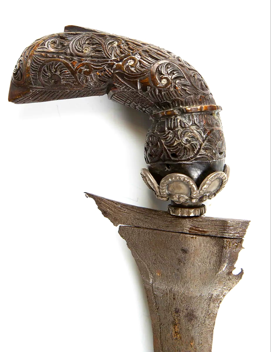

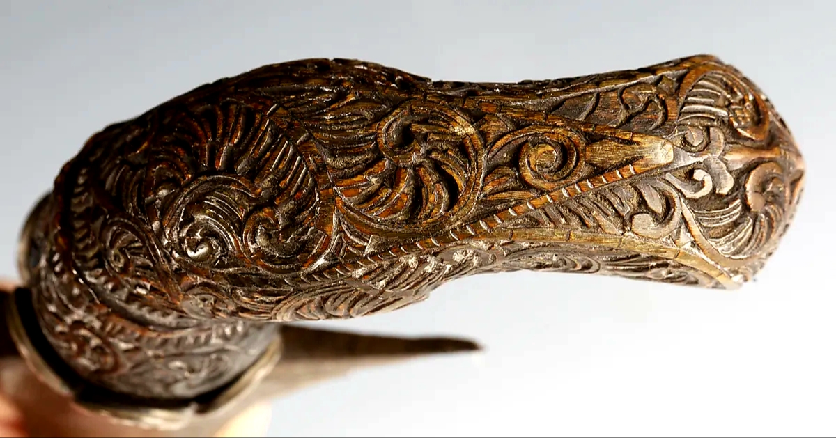

Hi
Any views on the material of this hilt? Sold as rhino.
I have no other images.
Best
Sid

Water buffalo horn! For sure not rhino!

Posts: 7,256
Yes, water buffalo (kerbau).

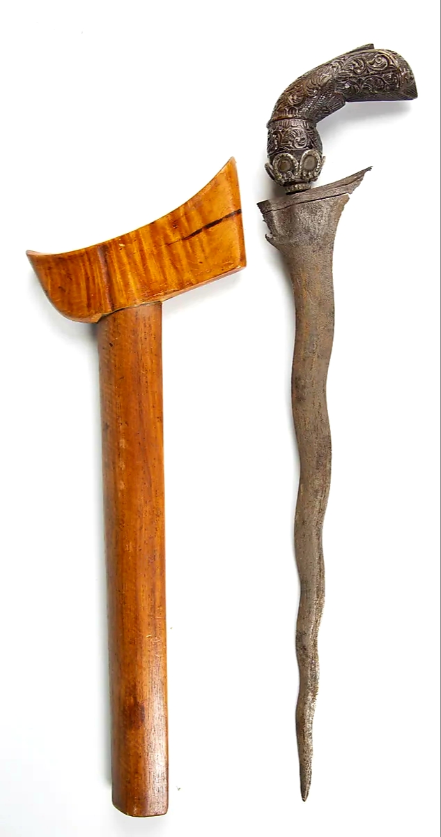

Here is an image of the kris. Any thoughts on its overall quality and age notwithstanding it is buffalo horn would be welcome. The scabbard us not original to the kris and is a poor fit.

The blade is 36cm long.

Sid, this style of keris is not really my prime area of knowledge, so I'll limit my comments to saying that it appears to be of reasonable quality and in reasonable condition. The hilt itself is perhaps the nicest & most valuable component of this item.
However, your note that the scabbard is not original to the blade does prompt me to comment on this element of your description.
Where a keris has been prepared for use as an item of dress it is important that the scabbard should be one that has been made for that specific blade.
However, where a keris has been used in any combat situation it is not at all unusual to find that the blade will not be a perfect fit to the scabbard.
The reason for this is that often under combat conditions a scabbard will have been dropped, lost or discarded when the keris itself was in use. After the period of use a different scabbard was sometimes substituted for the original. We find this situation of a mismatch quite often and particularly with Balinese & Bugis keris.

The scabbard although not original has been with the keris for some time. This is evidenced by the clear difference in blade colour at the point where it protrudes from the scabbard mouth. So I guess we can say the replacement is not recent and perhaps probably done within the culture.

The hilt is in the pangulu style, scabbard looks Bugis but I am a little bit unsure about the blade, could be Bugis also. A proper warangan could give some clues.

The blade cross section is not hexagonal in profile like typical Bugis blades. Could this be Sumatran,? I do not know if the Hilt could be Sumatran too. Is this what pengulu style refers to?

Posts: 7,256

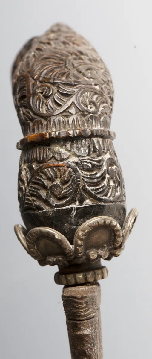

I have a similar but absolutely modern Bugis hilt certainly made of Kerbau as I believe this too is (although mine is certainly black with hints of white-grey) while this appears to be brown . Also I have a couple of similar Bugis warangkas very similar. The blade may or may not be " Bugis" but since the Bugis culture is widespread in many areas could easily be borrowed from a different tradition. It somewhat reminds me of a Palembang blade that I have.
With hindsight, it is possible that it may be rhino.
http://www.vikingsword.com/vb/showthread.php?t=6162
One should be really looking at any trace of dotty structure. If it is...this may be bad news since out is not possible to legally trade this item in perpetuity and only a museum may be able to display it

As to blade origin, I believe I can see a lot of Jawa in the blade, but the complete keris still qualifies as Bugis style.

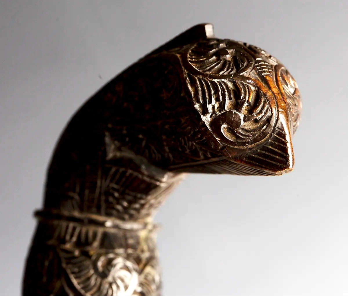

I don't see any photo of this hilt in this thread that gives the impression that this hilt is rhino. You are correct that one needs to identify the tubular structure of rhino horn that would terminate at the surface in tiny dots, but no such structure is visible in these images. If Sid can see such structure in his hilt it would probably be visible by looking straight at the "face" of the hilt. Using a strong flashlight can also help as the horn should be somewhat translucent. If Sid can see this structure perhaps he can capture in in photos from a better angle.
