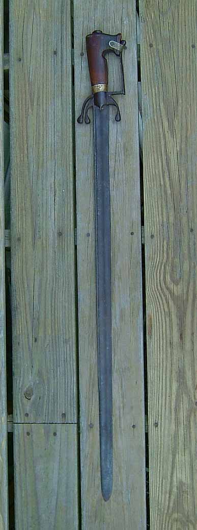

I've always wanted to add one to my collection ; and now I have .
This one has been around the block but seems pretty darn old .
I've got a couple of questions about it that maybe the membership can answer for me .
The sword is 40 1/4" oa.
The blade is 33 1/2"
False edge is 9 1/2"
Width of blade 1 5/8"
Thickness at spine 3/16"

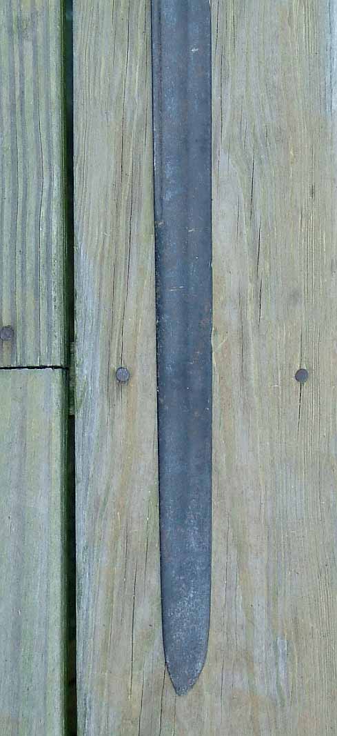

There is a wide shallow fuller the entire length and the narrow fuller that is obvious in the pics .

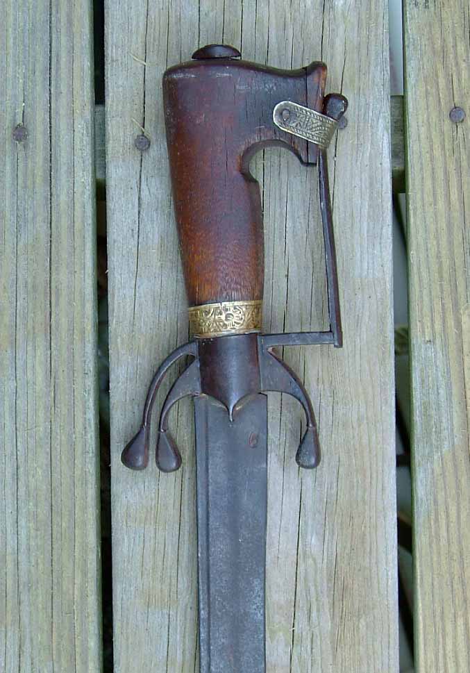

This is a big , heavy sword , the hilt is Rhino .
An obvious repair is present .
I have read that these swords were trade blades from Europe .
Now for the questions :
What style and era is this type of blade ?

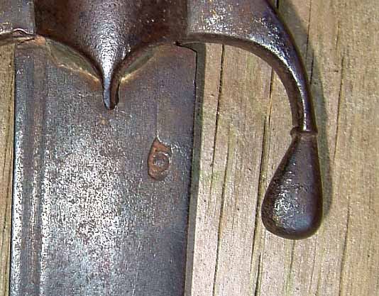

Can anyone identify the maker's mark ?
I have a suspicion that the blade may be 18thc. or earlier .
Can anyone confirm or deny this ?
Have at it !

Nice. Moorocan type. Second time I've seen one of these nailed down band repairs on the pommel. The angle of the knucklebow seems unusually tight and unusual in having that little projection; I seem to be able to see a line? A joint? In the closeup of the lagnet, is that by any chance a flat round "slug"/shim of brass or other relatively soft metal inserted between the metal of guard and blade?

Yes Tom, it is a joint , and yes , there is some kind of shim in the area between the langet and blade .
What I find most exciting about this sword is that the blade could well date back to Cromwell's time and the English civil war .

I very much agree that this is probably an English backsword blade that may date back to late 17th century. The patination and deteriorated stamp in the blade seem to correspond to blades of that period I have seen. Actually I have seen a very similar stamp in about the same condition on a Cromwellian period blade.It is not at all unusual that these swords often carried straight European blades, especially English. Anthony North in his "Islamic Arms" (Victoria& Albert, 1985, p.28) notes in caption of illustration of portrait of an English officer c.1617 , "...the captain of a Trained Band is shown wearing a typical Moroccan sword and holding a staff of office. These swords with thier distinctive hilts seem to have been fashionable in the 17th century in England, as they are shown in portraits of the period".
It would seem that while these swords had a degree of popularity in England in those times, at the same time the English blades had similar popularity with the Moroccans in thier sa'ifs (nimchas). I have found English backsword blades of even latter 18th century mounted in Moroccan swords with variant shellguard hilts, so this seems a long standing practice. With the position of the stamp on your blade and the distinct back fuller I would suspect this blade is probably end of 17th to early 18th century by its appearance.
While the blade seems quite old as noted, the mounts seem of course much more recent, which is not at all unusual as it is well established that most swords of these forms were often refurbished over many working lives.
Nice example with a outstanding blade!!

The joint visible in the guard may be a repair (it is unusual; usually the bar of iron is just bent there; on the other hand, and worth mentioning, is that I've seen a joint somewhat like this on brass French hilts, and France and Mooroco are not real far apart; watch me ramble in panentheses ); it's possible the knuckle bow got more or less knocked off this piece at some point?

When I look at the examples in Tirri I see that they for the most part are at a 90 degree angle . This example of mine is a peened joint at the right angle .
The horizontal part (quillon) has been fashioned at its end into a round 'peg' (for want of a better word) . The bottom of the vertical piece has been drilled to accept the round end .
Now for the guesswork ; I think the peg was peened to swell it in the joint and then filed smooth . If it was a repair one would expect the quillon to be shortened ; rather it is the other way round and the knuckle bar leans into the pommell slightly . Possibly it started out life as a curved knucklebow .
