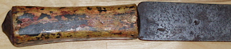

This arrived in the post this morning, my ideas are limited so please feel free. Overall length 34 inches, blade 29 1/4 inches, width 1 3/8 inches, bone handle I think and possibly, hopefully some age, certainly feels and looks like it. I think I've covered half the globe in the last couple of hours from Eastern Europe to Turkey to North Africa and Arabia and I'm feeling travel sick so please help if you can.

My guess is a bedouin sword, possibly from Arabia, but more likely N. Africa.

The blade surely looks N African.
The so-called "Bedouin" swords usually are much more sophisticated than this one, with a shashka-like handle etc.
But I tend to agree with Charles: it certainly looks like it belonged to a Bedouin. A poor, undernourished, one-goat Bedouin, but a Bedouin nevertheless.

It's appearance might not be superb, but nevertheless I think it's a fine blade.
Probably in the past it looked more sophisticated but the last Bedouin-owner made it to a usefull sword in his opinion.

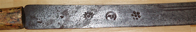

I have to agree with Henk regardless of its looks it's not a bad blade to handle, light and quick I certainly wouldn't like to be on the receiving end of a well aimed swipe. Although the blade may have found its way to N. Africa did it start its life there? It looks more like a European sabre blade to me although possibly not heavy enough, everything seems to have been copied from time to time and from culture to culture including blade type so maybe difficult to pin down. Can anybody hazard a guess as to age.

I think its a great ethnographic sword .... sure it has no frills ...but it is a good honest weapon .... love the blade. I'm sure it (the blade) has seen some history and was later rehilted, North Africa does seem likely.

This very crudely mounted and produced blade is quite similiar to machete type blades that were produced in Solingen in the 19th century (see W.Gilkerson, "Boarders Away") . Obviously this piece is much cruder and the markings are accordingly crude imitations of the Solingen 'talismanic' groupings of the latter 18th century.
While this workmanlike piece certainly might have been from the Bedouin regions of N.Africa, such pieces are equally found in Central America and Caribbean regions but these typically had the genuine Solingen blades. Since this seems lighter and copied, I would be inclined toward N.African regions and probably more for the Sinai region. The simple Bedouin swords, though most seem to have more of a shaped hilt (I'm sure Ariel will share his examples this possibly might be a crude rank and file item. I think this piece is probably early to mid 20th century.
