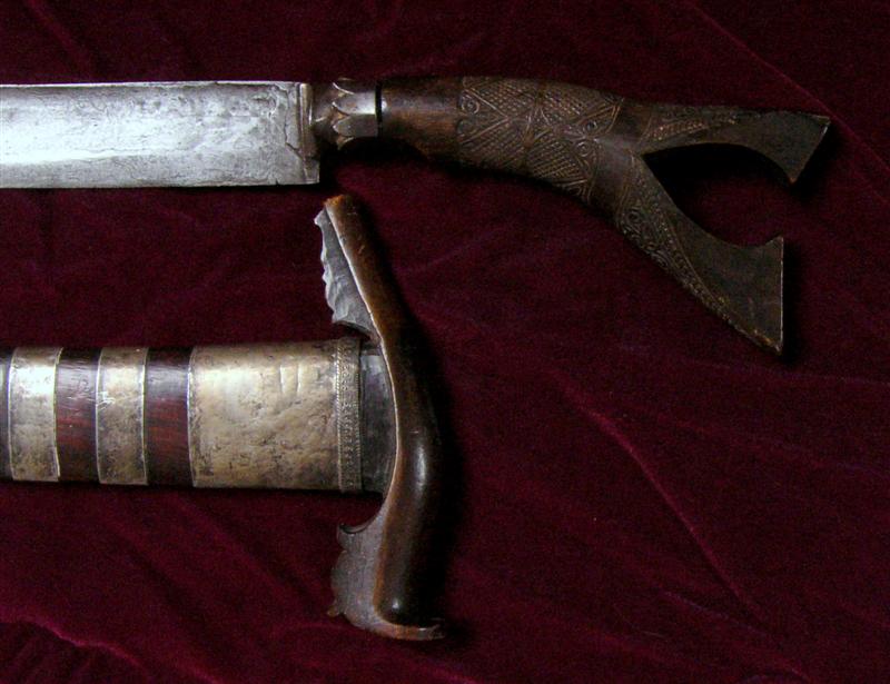

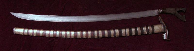

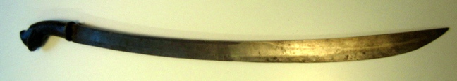

36" OAL

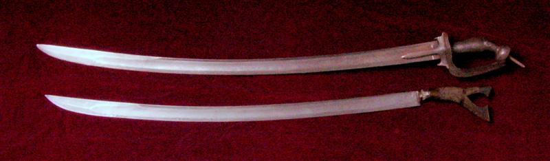

This is from Aceh, I would like to know more about the type of sword and anything you can tell me about this one?
The silver bands seem of good quality though I think that I'll leave them as they are. I like the patina.
Comments?

The blade reminds me of a peudueng's . (sp?)

I took Jens advice
Have you all nailed a pair of pantyhose to the mantelpiece? It is better than a stocking, as there will be room for two swords .
I also have a Moro spear/budiak that is about nine feet long. It stuck out of the pantyhose. Will post it soon.
Had fugly yellowish varnish all over the blade and the ferrules,so I am having to clean them. It is coming out very good. The ferrules are silver. Jose, you'll be pleased.

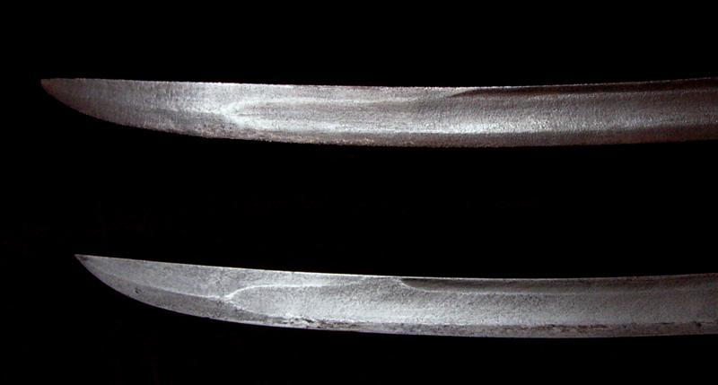

Very good point, Rick.

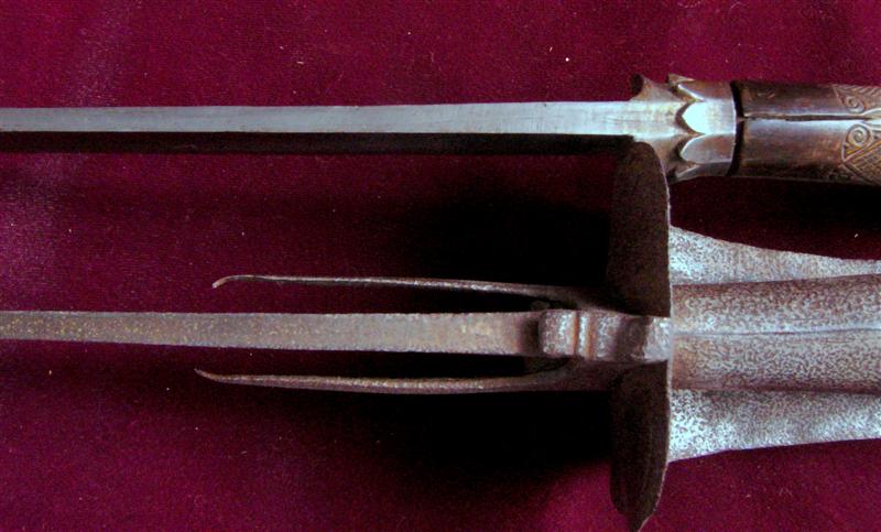

In all the the below pictures the Sikin is on the bottom. Amazing similarities! The peudueng is a little longer.

Originally Posted by Bill Marsh
36" OAL
Comments?
Hi Bill,
In the first weeks of januari I will list some free to download very old articles about Aceh stuff on my site. The text is however is dutch and German but its is a very good reference work and the plates will speak all languages.
Please don't change anything on the piece and I was you I should also not polish the silver...

I would disagree about the silver......
Would be good to see the blade etched (etching and polishing silver does not lower value).

Originally Posted by mandaukudi
Hi Bill,
In the first weeks of January I will list some free to download very old articles about Aceh stuff on my site. The text is however is dutch and German but its is a very good reference work and the plates will speak all languages.
Hi Arjan,
Thank you. I can translate German and Dutch. I may not get the idioms and colloquialisms right, but will get the basics.
Sorry Jose, I was thinking about leaving the silver like it is. So far, all I have done is to gently clean the white residue from the carving on the hilt. Otherwise, I think that I'll leave it alone.
It is a peudeung, pedang or Sikin" ( Sikim , Sikkim, Sekem ). The reason there are so many names for these swords is that there are 10 subethnic groups of acehnesse (such as Aceh , Gayo, Alas, Aneuk Jamee, Melayu Tamiang, Kluet, Devayan, Sigulai, Haloban and Julu )
It is a very nice example. Congatulations.
We have talked about these a few times here on the forum and a couple of years ago I tried to pull together the information from here. you can find it here
http://home.comcast.net/~jtcrosby/Aceh.html
These peudeung can also be found with Hulu tapa guda but I have only see a few of those and unfortunately do not own one.

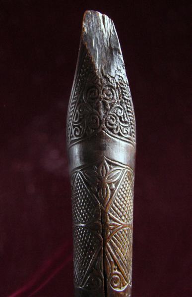

Thank you RhysMichael. This is some very good information!!
I REALLY like the designs on the scabbard. The language looks like it could have roots in Tamil.
I wonder if the Achenese had trade with India. Looks like they traded with about everyone else!

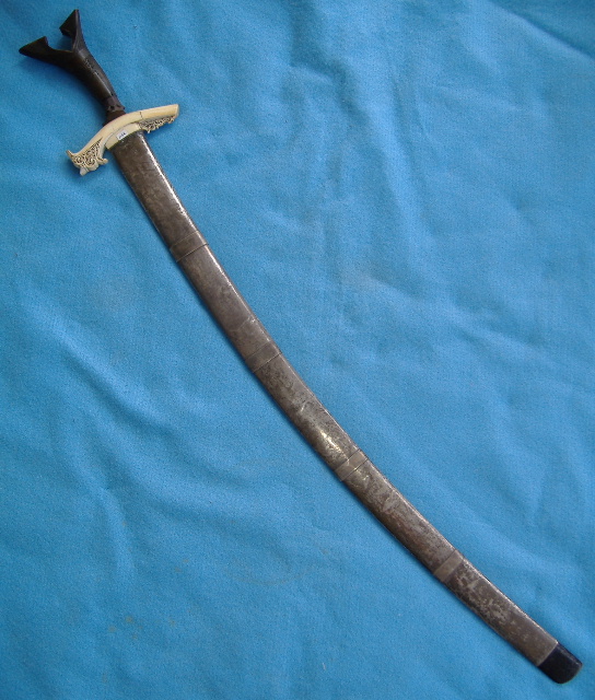

Here is a peudeung with a hulu tapa guda
Another from an earlier thread is here

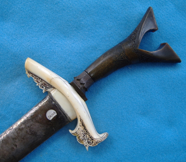

Old 23rd December 2007, 02:14 PM   #13
CharlesS
CharlesS's Avatar
Location: Greenville, NC
Posts: 1,854

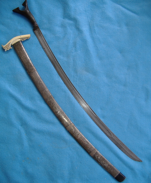

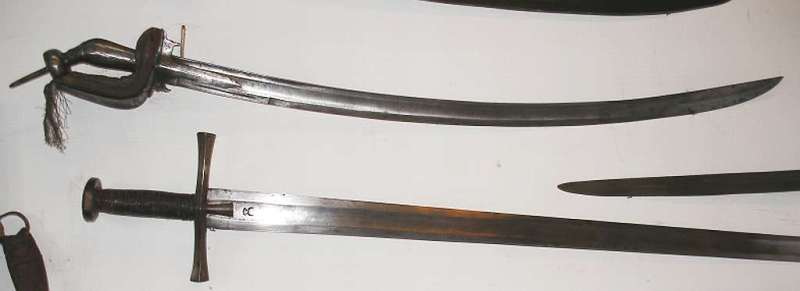

Here is another one with another nice hulu, and all silver scabbard cover with ivory embellished scabbard mouth.

That is an nice one Charless looks like an very long one

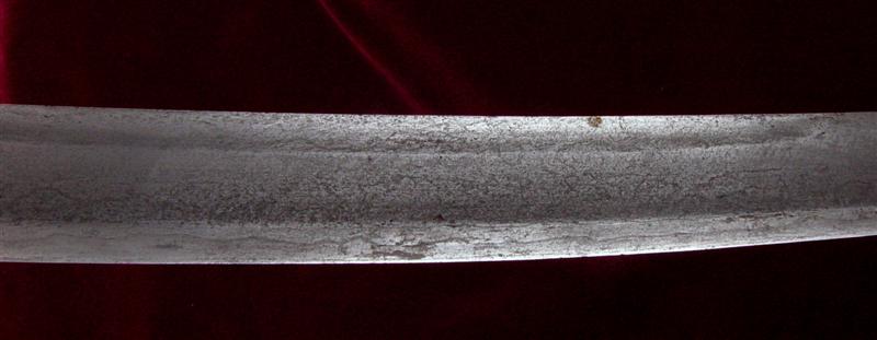

A very nice Sikin.
I have had it in my hands last month when it was still in the Netherlands.
The blade is quite common, as far as Siking Pasangangs of this quality are common
The silver can be cleaned, it will get darker by time again.
But I would also choose to leave them as it is.

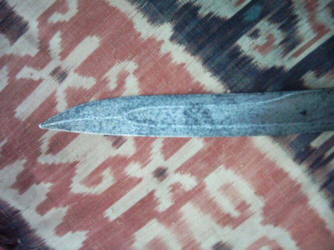

I Have no experience in etching, but from previous posts by Bill we can see that this is in goods hands
enclosed a picture of a sikin with similar bladepoint.

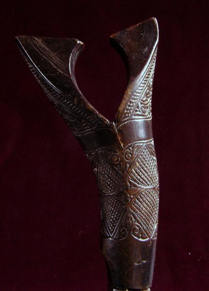

The handle is horn. Could this be rhino?

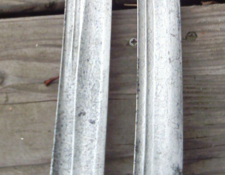

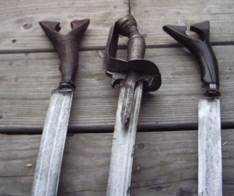

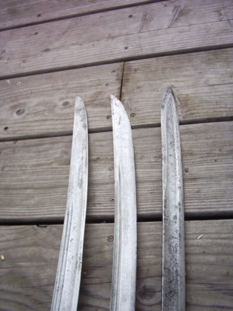

Dear Bill,
No, as far as I could see it is Buffalhorn.

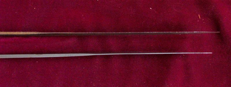

Ps. some more pictures of the blades I currently have.
2 x Sikin Pasangang and 1 x Pedueng
I Sikin has a very faint image of a European looking shield engraving.

Posts: 1,599
Originally Posted by asomotif
Dear Bill,
Thank you Willem,
I am sure you are correct since you are familiar with Sikin and have handled my sword in the Netherlands.
It does not seem as fibrous as rhino is usually.
I read that rhino horn became more sticky when wet and noticed that when I was cleaning the handle it did seem to become sticky. I guess that buffalo horn may also exhibit this characteristic.
