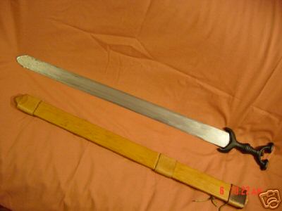

Default Strange Sword with Khanda/Pattisa Blade- comments
I recently saw this sword, has it been re-hilted, is the hilt appropriate, is it an indian sword?
any comments are much appreciated

Lew
Lew's Avatar
Location: East Coast USA
Posts: 3,191
It looks like a Celtic or migration period Germanic sword reproduction.

Old 7th December 2007, 03:39 AM   #4
Posts: 10,857
I agree Lew, reproduction of early iron age 'antennae' type swords or the LaTene type.
Nothing to do with Khanda. We have been talking a lot on khandas lately though Sikh Soldier. I think the threads discussing them have developed some pretty good discussion on these.
Old 7th December 2007, 05:57 AM   #5
Gavin Nugent
Gavin Nugent's Avatar
Posts: 2,818
Default LaTene
I aggree, after watching a documentry on the rise and fall of the Celtic tribes I too agree with Lew and Jim, many such examples were shown last night on the ABC television here in Brisbane.

Sikh_soldier
Join Date: Nov 2006
Posts: 87
Default strange sword
Oh thank god it was described as a "South Indian broadsword Khanda with a rare ritual Vajra handle"
I was thinking of putting in an offer,
Thanks Jim I will read up on that post, i obviously do not know nearly enough

Old 7th December 2007, 03:03 PM   #7
Posts: 10,857
Hi Sikh Soldier,
Knowledge is the most important weapon for any arms collector! This is why we are here, to learn together and share our discoveries, in both that and the weapons themselves which truly help us learn and understand.
I did not immediately recognize what that hilt was, but knew that it was certainly not a khanda. I suspected it was a very early hilt form, which was confirmed promptly by Lews post, and a quick check revealed very similar 'antennae' type hilts as described.
I'm glad you checked with us as you did and hope others will as well, as so many do before purchases or bids on weapons they are not familiar with. I cannot even imagine such a description captioning this weapon!
All very best regards,
