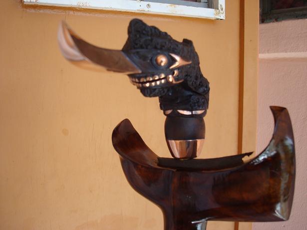

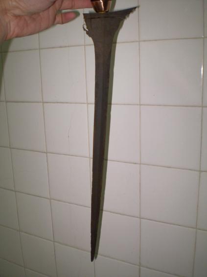

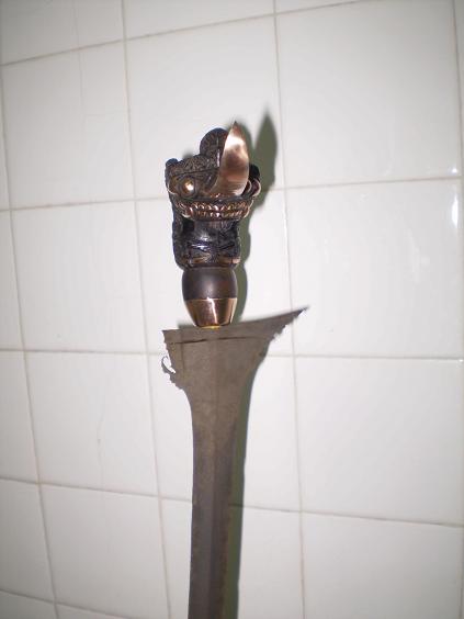

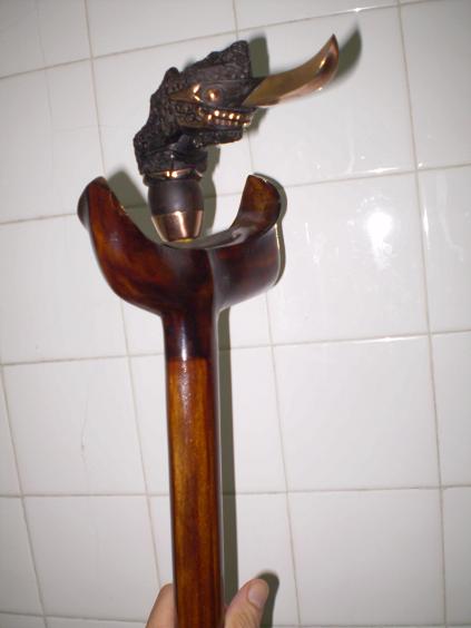

here is my other tajong for comments.. anyone??

Nice piece! Are the mounts swassa?
Old 10th October 2007, 10:59 PM   #3
Posts: 7,303
That would be my guess from the looks of them Jose.

Zartane,
Very nice complete tajong. If I'm not mistaken, it's quite a high end piece. Where did you get it?

well, i manage to bargain it from a friend of mine.. didn't have the chance to polish the swasa.. maybe i will n post some pics after polishing..

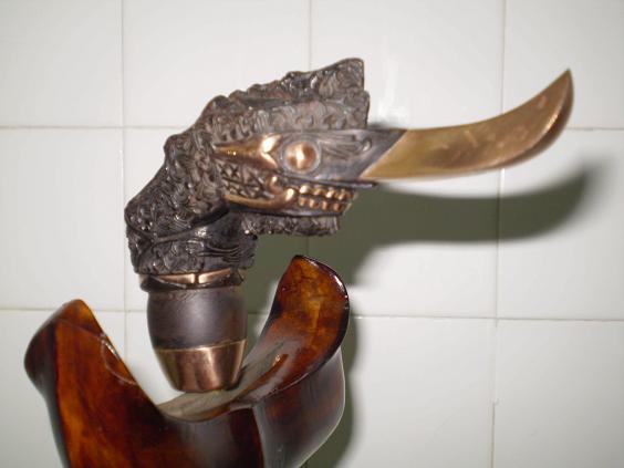

I think the swasa accents (except maybe for the side eye-lashes) on this hilt are attached using adhesives instead of swasa pegs. So be careful when you polish the swasa accents. Depending on the age of the work, the adhesive securing the swasa pieces to the hilt may have become weakened and may drop off. And if that happens, please don't use superglue to reglue the pieces. Wood glue may not be the best to hold the swasa onto the wood, but it certainly is very safe and reversible, and will last for a while.

BluErf, where can i find this swasa pegs?? are there any particular product?? and yes, i did polish the swasa accents, and yes, one of them came off.. i should have read your post before doing so.. at least i did not use the super glue (i was planning to use super glue tomorow, luckily your comment was on time!!)
Therefore I thank you very much for your kind advice!!

Actually, swassa has to be made from scratch - it is a mixture of gold and copper for the most part, but must be played with and mixed specifically to match the color of the original swassa. It is expensive, but a friend and I have made it in the past.

I reckon that if was going to use an adhesive to put those pieces of metal back in place, I'd be using either damar or shellac. Button shellac would be the easiest to obtain, and to use. Just heat the piece of shellac over a candle, smear a little bit onto the wood, then have two candles burning at the same time, heat the shellac on the wood over one candle, and the metal fitting over the other, and press the metal into place.To make sure the metal went fully into its correct position, you heat the metal over the candle when it is on the wood, and then press it into place. The excess of squeezed out shellac can normally just be scraped off with a thumbnail, or a little piece of pointed wood, the candle soot can be wiped off with turps.

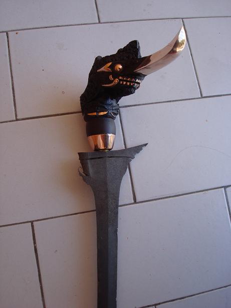

thanks for all the replies.. how old do you guys think this keris is??

I think this tajong is a early 20th century example judging from the form. I think there should have been an earlier thread on the evolution of the tajong hilt through the ages...

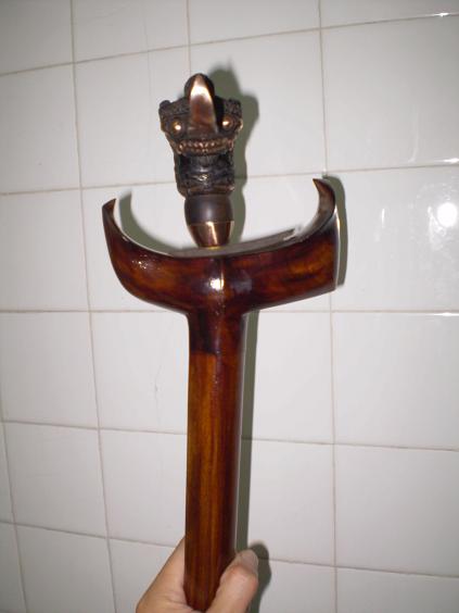

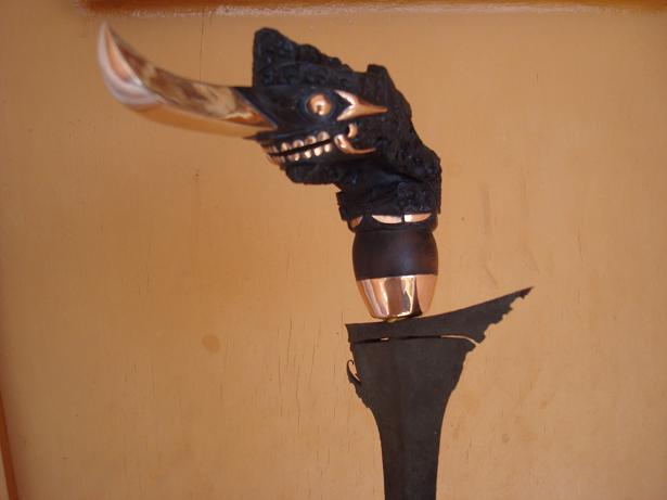

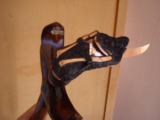

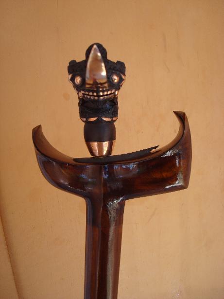

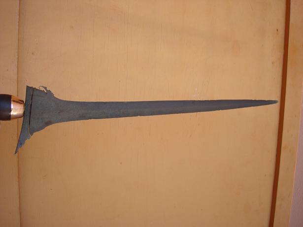

here is the keris with the swasa polished..

I think I love it!!!!!
