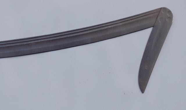

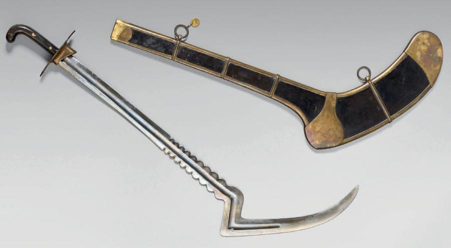

Hi,
I don't know where to put this sword in Ethno or European...
What is this and from where?

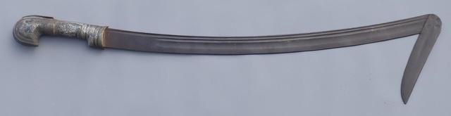

That is the oddest sword I have seen in 50 years of collecting ! It is hard to even conceive a technique by which it would be used .... I wonder if Matt Easton of Schola Gladiatoria has encountered such a weapon ?

You can find some information here on this rather strange sword: http://www.vikingsword.com/vb/showth...ght=sock+sword
I hope that this will be of some help.

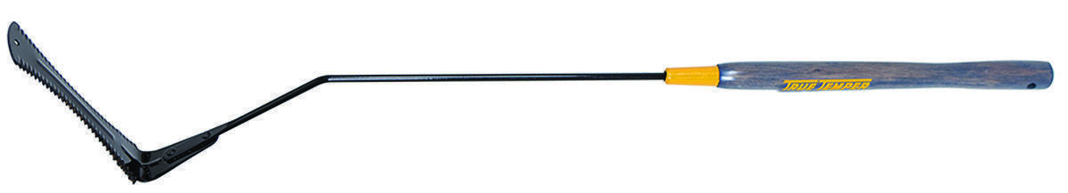

Though not officers quality, here is a photo of todays version of this piece. Photo compliments of local hardware store add.
Robert

Here it's all the information that I got... very little...
1809
Spain, 1st Empire, sword used by Spanish light cavalry to cut the horse's shanks of French heavy cavalry, unit dissolved just after Waterloo...

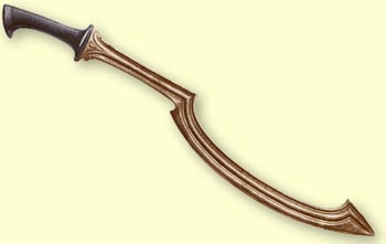

I'm surprised no one has mentioned the passing similarity to the kopesh Although there are obviously a few millennium between the age of the kopesh's common use and the time of this example's manufacture, it seems such a weapon as pictured here could have been wielded in similar ways. Seems it would have been formidable against an armored foe, even of the bipedal type.

Shayde, that was a very astute observation, and I know I hadn't thought of it.
While obvious an incredibly disparate chronological gap, it is of course well known that many relatively modern sword forms were made in an atavistic
spirit. It seems there have been some recalling the blade form of the khopesh, and I recall even the 'Black Sea yataghan' was at one point noted to be a modern descendant of these. Actually more to that form was an ancient Sumerian sword.
* below is image of the khopesh found in the tomb of Tutankhamen

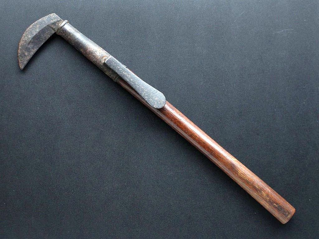

hay bales? fodder? the japanese equivalent: my jingama i could shave with it too.
Hmmm... interesting clip on the side Could it be a pirate’s jingama?
Old 26th October 2017, 06:18 PM   #24
no, it was used by mounted samurai, mostly for cutting fodder, it's be shoved into their sash, the clip held it from slipping out. also used as a secondary if they were surprised when using it, essentially a classy kama. (discussed elsewhere here)

OK and what is this?
Do you think this shashqa was modified for the same purpose???

Drawing it out may now present a bit of a problem:-)
Poor Shashka... who might have had a crazy idea to mutilate her like that? KGB goons? “Midnight Express” jailers?
