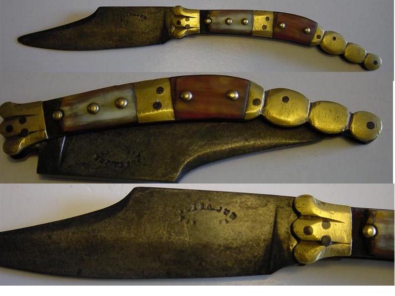

Default A little navaja
A bit damaged. The handle plates are bull white and rose horn. The brass parts are the real basic handcraft, the file work is pretty rough. The 8 cms. blade is missing the tip, and the maker's mark was hard to identify.Forton's was the key: Valero Jun from Zaragoza, XIX century. However and again according to this book's illustrations, this shape could be French or, in the least, Franco Spanish. I wonder what the experts think about that ... Chris ?
Thanks
Old 22nd May 2007, 09:19 PM   #2
ingelred
Location: Moenchengladbach, Germany
Posts: 62
the maker's mark is most probably
Valero Jun(ior) Zaragoza
Nice find.
Greetings, Helge

Hola Fernando,
That navaja style is most definitely French, more specifically from Thiers.
I always wondered whether those sold with Valero Jun stamped into the blade, were made in Spain or under contract in France and merely retailed under his name.
The ones that I have seen appear to be of above average quality, for Spanish knives, strongly suggesting that they were actually made in France. A few were of poor quality, more consistent with Spanish folders, and suspect that these were local copies of the French made navajas.
Cheers
Chris
