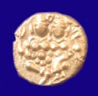

Jens, here are snaps of 2 more coins with weapons depicted on them. Both are from Mysore and from Haidar Ali's period (1722-1782 A.D.).
First is a Gold Mohur (often called Pagoda) depicting the Hindu Gods Shiva and his consort Parvati. Haidar though Muslim was very liberal when it came to depicting Hindu symbols on his coins. Observe Shiva holding a Trident (Trishul) in his hand (9 'O' Clock Position). The coin weighs 3.4 grams.

Interesting coins you are showing, although it took me some time before i could see what was on the gold coin. The Hindu numerals used on coins and elsewhere can look quite differently according to the dialect spoken at the place, but does the numerals also give an indication of the time when they were used?

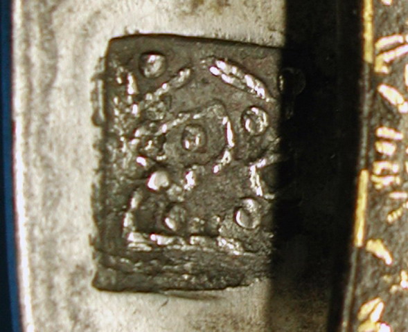

On a tulwar, I have, there is a square mark which I can’t figure out, can you?
