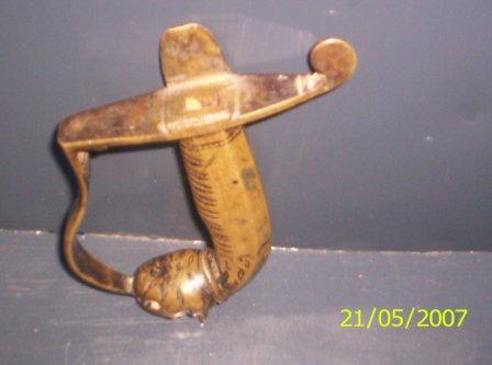

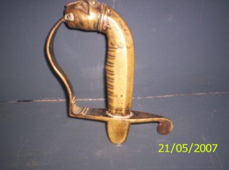

Default Mysore ?? Sword Hilt
Friends,

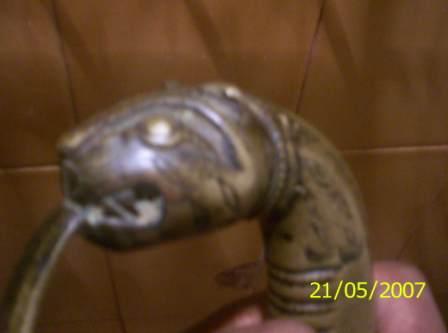

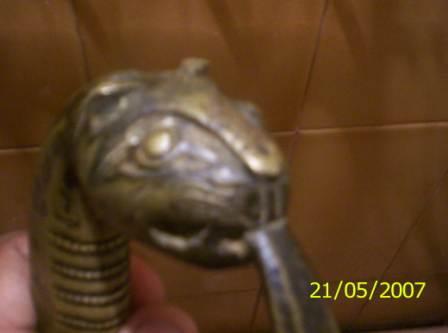

Here are some details of the sword Hilt in my possession. I would welcome any new ideas about it's identification, area of origin, etc. I am not much of a photographer and even lesser of an arms collector, so I request you all to bear with me. Here goes...

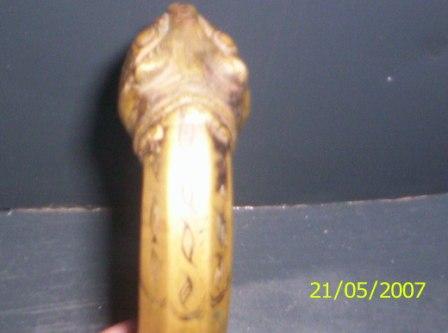

The hilt seems to be made of brass and is cast in one piece. As can be seen from the photographs it comprises of a tiger's head pommel and a grip for the hand. The inner side of the grip has ribbed double lines across as can be seen in the photographs.

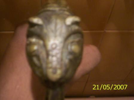

The tiger's head is incised with the typical Tipu bubris incised all over it which extends down to almost one third of the hand grip. The bubris are S shaped and hollow save for a curving line at the centers. The nose of the tiger is dotted and the forehead has the banana plant like bubris pattern with a straight line and 2 bubris on either side. Towards the neck of the tiger is something like a collar (double lined and ribbed).
One end of the knuckle guard is seen leaving the mouth of the tiger at the pommel and reached down to the quillon. There are no bubris to be found on any part of the knuckle guard or the quillon.

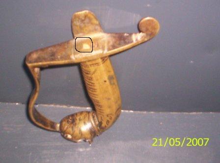

We can see one langet only as the other one seems to be broken from what remains of it. There is no design on the langet as well.
I tried looking all over for any inscription but could find none. There is as you can see no blade and I do not know what came of it or how it came to be broken.
Here are the dimensions:
Overall length (pommel-langet) - 14.5 cm.
Lenghth of grip – 7 cm.
Length of knuckle guard – 10 cm.
Length of langet – 3 cm.
Length from quillon end to knuckle guard end – 11 cm.
I picked this piece from the Mysore region of Karnataka, India.
Awaiting all your feedback.
olikara is offline   Reply With Quote

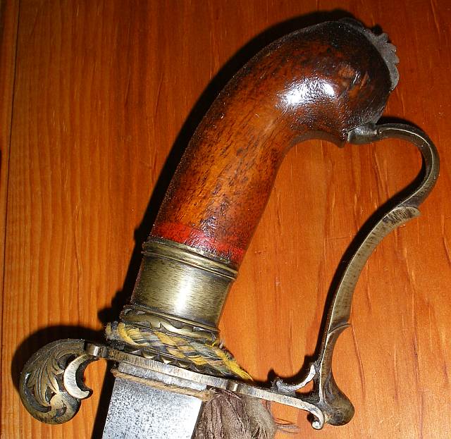

This hilt is fascinating as it clearly carries the tiger motif favored by Tipu as his personal totem, however the elements of the form such as the knucklebow, quillons and langet are distinctly of the British M1796 light cavalry sabre. While the British sabres of this pattern were considered one of the first 'regulation' pattern swords for Great Britain, officers were granted a great deal of license in customizing thier own hilts.
During the campaigns in Egypt at the beginning of the Napoleonic period, British officers were profoundly impressed by the warriors known as the Mamluks and thier flamboyant costume and especially the deadly Ottoman hilted sabres. Both they, and the French, adopted the design of these sabres into their own sabres, which eventually became the popular dress sword for officers termed the 'mameluke'. In addition to this, British officers sometimes added certain motif to existing sword hilt styles, creating a manner of hybrid and personalized form which pronounced that officers involvement in key military campaigns. I once owned a British M1803 infantry officers sabre which had the familiar lionhead pommel hilt, but instead of the flowing mane it had added a distinct sphinx headdress, clearly coming from the British campaigns in Egypt. While this practice was not prevalent, it was of course practiced in degree.
It is my opinion that this sabre hilt is one of those examples, probably commissioned by a British officer who saw service in the campaign at Seringpatam in 1799 with the defeat of Tipu Sultan. It seems quite plausible that this hilt was fashioned in the same manner as the M1803 I have described, using as the basis, the new pattern M1796 cavalry sabre.
What is unclear is whether the hilt was produced in India by local outfitters during occupation in years immediately after the famed battle or in England by one of the growing number of weapons contractors outfitting troops.
It is interesting that in India at that time, the British forces were those of the Crown in some degree, but primarily those of the British East India Co. It would seem that if done for an officer of the East India Co. thier device might be found somewhere in the design (while possibly only on the blade, now absent). It is interesting to note that soon after this period, the symbol of the EIC became the rampant lion replacing the quadranted heart with initials.The lionhead pommel did appear on some EIC sabres of this period.
It would be interesting to hear opinions or thoughts on this most interesting hilt. It has been my impression that Tipu would not have used a British hilt design for a sword made in his armouries (he and the British were of course not close, so probably was not of Tipu's reign. While the use of European blades and material was well established with Tipu's father Haider Ali who used German mercenaries, and swords are known carrying European design, this hilt in my opinion is of British form, so would not be from Tipu's armouries.
Thoughts, observations?
All best regards,

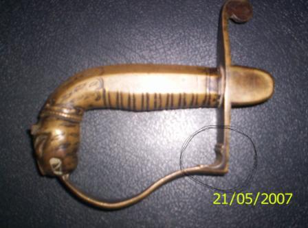

Default Purpose of the Notches?
Forgive me for my ignorance.
But, what would have been the purpose of the feature(looks like 2 parallel lines/notches) on the knuckleguard-quillon that I have circled in the photograph attached below?
Old 27th June 2007, 01:33 PM   #8
i see this on a few similar sabre hilts, noteably the one on this illustration appears to have that feature.
and this one:
just a reasoned guess:
the 90 degree corner there is a weak point & in a casting especially would require a radiused section on the inside as re-enforcement. the decorative lines may be just that, or as this area is also used to attach the sword knots (used as a lanyard to keep you from accidentally dropping your sword while on horseback, which could prove embarrassing in a battle) it could serve as a restraining device to keep the knot in place. many hilts of course have a slot near the pommel for this (like the heavy cav. sabre in the photo).
Old 27th June 2007, 02:42 PM   #9
Posts: 10,858
Hi Olikara,
That is an excellent question!!! and in all honesty seems like the type of question that should be asked when studying the features in hilt forms, but in the years I have pursued this, nobody has ever noted it including me
On military swords, they typically follow a pattern which has a basic design and often with very subtle variations or features that seemed to have a degree of consistancy with individual makers who contracted to the govt.
The British M1796 light cavalry sabre for other ranks was one of the first truly 'regulation' patterns for them, and while these sabres were inclined to almost monotonous sameness, the officers had considerable latitude in ordering thier own custom swords.
The M1796 hilts were typically of forged iron, with other ranks being of course standard, and although officers sabres were as described, often custom made, they too were typically forged iron and followed the guidelines in so called 'stirrup hilt' with 'birds head' type pommel (meaning a smooth rounded pommel which smoothly carried down through the backstrap.
As Kronckew has noted, that 90 degree turn at the bottom of the knucklebow would most definitely be weakened, and though I am far from any expertise in metalwork or metallurgy, it seems a reinforcement would be the most likely explanation.
When casting brass hilts, I am not sure if there are similar dynamics as I believe the forged metal is worked, while the cast is not. In the case of the brass hilts, they were cast from a mold, which may have been from the original hilt form itself in this instance. The feature, though originally structural in the original, would carry through in the finished product .
I think Krockews very astute observation on these being positioning guides for a sword knot is also well placed, and again an idea I had not thought of. On the original M1796 sabres, there were usually slots on the knuckleguard for these knots, with the purpose he had described, however I have seen more decorative M1796 sabres with knots placed as he has noted.

Jim,
What you are suggesting could very well be true as far as an underground movement against against the British is concerned after the fall of Tipu. However this movement was limited to a flareup at Vellore, in another part of S. India, in 1803 where Tipu's immediate family was sent into exile. However, the British were very generous to the family and provided them with hefty pensions.
The Madras Sepoys stationed here mutinied and raised the Flag of Tipu Sultan at the fort, installing his son Fateh Haider as their leader. This mutiny was however crushed by elements of the British 19th Dragoons led by Gen. Rollo Gillespie. The 19th Dragoons had also seen action at Seringapatam in 1799.
However this being said, this revolt or movement pales into insignificance when we compare it with the events of 1857-The Great Mutiny.
That was about all the resistance that sympathizers to Tipu's rule could muster. The British had played their cards well handing out heavy pensions to all in Tipu's extended family and his circle of officers who had survived 1799. They had also restored to the throne the Hindu boy king whose ancestors 3 generations ago had ruled over Mysore. They also had made over large chunks of Mysore territory to the Marathas and the Nizam. Thus they gave no or limited scope to any Indian group to rebel.
I do not see any reason why the resistance should have designed hilts with a hybrid of Tipu and British features. In all probability they would have stuck to Tipu's alone unless of course, they saw that this hybrid variety was in some way technically superior to the traditional one. In any case, there are no written or contemporary records pertaining to any of the rebels of that time using Tipuesque weapons. Maybe they still carried weapons on them that they had used even during Tipu's time.
Rather, could the hilt be the influence of the French, who we know greatly admired the 1796 issue and I have read complained about the savage wounds it inflicted, and cast during Tipu's time itself.
As for the blade, I can see a faint discoloration that looks wedge shaped and seems like part of a blade on one side of the quillon. This portion is also slightly sticky to feel. I can also see something that is soft to touch and feels and looks like resin or gum in the hollow portion where the tang goes. I have marked it for you.
One of the langets is broken and maybe it broke off while someone was trying to pull out the blade from the hilt. It seems to me that someone tried to bend the blade along it's width thus taking it out, maybe as he wanted it to, and one of the langets along with it. What do you think?

From your observations on the hilt at the tang aperture, it does seem like a blade was once mounted, and the damage in the missing langet does sound related to the attempts in removing the blade. It was clearly done by someone that was anything but an armourer, and it makes me wonder why it was removed. Could something unfavorable have been on the blade? perhaps an inscription or patriotic slogan, or other? It seems as if the blade was rather brutally removed...but then why wouldnt the entire sword be destroyed?
