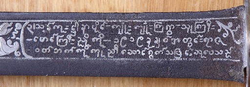

Here are the two dated texts, the first on the blade, the second on the scabbard.
Old 15th March 2007, 03:25 PM   #28
~Alaung_Hpaya~
~Alaung_Hpaya~'s Avatar
Join Date: Mar 2007
Posts: 65
3 , Than Ku hta-na paing _ Kyone Kyone Kya ywa _ Thu-gyi _ Maung Kyi Nyo ko _ 1919 khu hnit a twin ya za _ wat bet ko ku nyi saung ywet tha hpwint suu pay the
Than Ku district _ Kyone Kyone Kya village _ Head _ Maung Kyi Nyo _ 1919 during the year _ for helping against ? attack ??_ given this prize / award
" This award is presented to Maung Kyi Nyo the village head of Kyone Kyone Kya village in Than Ku district in the year 1919 for helping against ? attack "
Thado Thadi / Thiri Min Hla Ye khaung let thone saung dha _ 1160 khu hnit
The sword that is always worn / used by Thado Thiri Min Hla Ye Khaung _ in the year 1160
I think Ye Khaung is the name part with Thado Thiri Min Hla being the title .

Originally Posted by Andrew
Bump.
Anyone care to take a stab at translating the text?
Isn't that from Cole Porter? "Oh, you beautiful Dha, You great big beautiful Dha!"
Sorry, I couldn't resist, the Pun fairy bit me....
