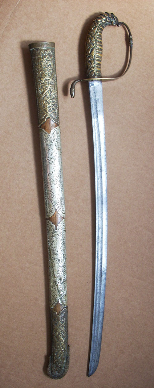

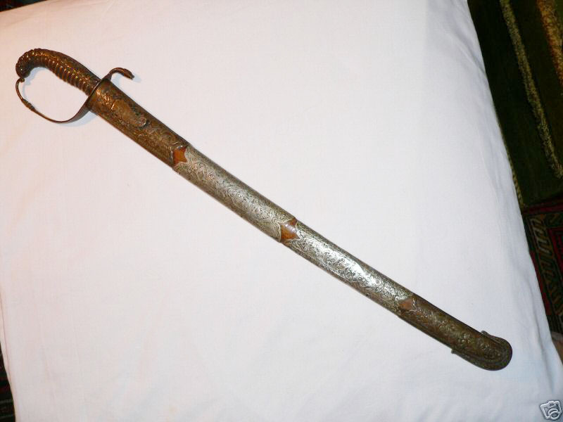

I would appreciate very much some help on the origin and age of the following sword. It is not large (60 cm wihout scabbard or 24 inches?), has very nice quality brass and silver fittings. The blade seems to be Europenean, very light one. In general it looks like a childs sword or ceremonial one. The most amazing about this sword is that it was heavily used: it has some nicks, the blade was reshaped (the groove runs almost to the blade tip) and was many times resharpened, so that it lost a lot of its thickness and width (judjing from its original thickness near the hilt and scabbard opening). It is still razor sharp, even after it was heavily rusted. My guess is that it may be from Ceylon or Thailand. Any other opinions?

Beautiful!! I think it's a Kastane. Congratulations

I don't think this is a kastane, Flavio, as it's missing the distinctive hilt elements of those swords.
The vegetal themes strike me as Thai or Burmese.

I can see what you mean......I too, thought a Kastane 'inspired' sword But the decoration is not usual.

Quite reminescent of Vietnamese Guom ( don't get me wrong: it is not a classic Guom, but the flavor is there).

It seems to me that there are two hands and origins on this piece. The brass work is so different from the white metal, which is very crude. I have a feeling this is European work. The leaves a cross between oak and acanthus. This repousse work is common to 18th and 19th century European metalware. The blade also looks European. The white metal bits are from elsewhere. I will post some pics latter.

I will stick my neck out and say this was originally European and a copy of French work. I would say made somewhere East of France where the French taste was very much in favour.

I go along with the SE Asia attribution on this, and note the incongruity of the white and brass metalwork. This seems interpretive of European officers sabres in the hilt reflecting the ribbed grips as well as the birdhead form pommel/backstrap (of course not suggesting that the pommel in any particular way represents the head of a bird
I would imagine this to date mid to latter 19th c. and am inclined to agree more with Thailand. The vegetal decoration does seem to favor acanthus, which of course was popular on the neoclassic theme often seen on the blade decoration on European officers sabres, in this case probably British and fashioned after the M1796 sabres . I have seen British officers M1796 sabres that are indeed quite small as well. The smaller size I think were for easier wear in formal events.

I would vote Malaysia on this example. The scabbard style, with the European style drag, the belt hook and the open design work between the silver mounts, reminds me of some Pedang style swords, some with monster head hilts and some with this style of downcurving hilt. For a similar example, without scabbard, please refer to "Catalogue De La Collection D'Armes Anciennes" by Buttin, plate XXVII #904. That example, with similar style handle, is labeled as Malaysian Pirate sword.

Surely this must be from French Indochina or areas under that colonial influence. A pirates weapon is a good suggestion. I wonder if it was taken and added to. It has been added to. The French style is undeniable in art work , blade and hilt.

I go with RSWORD. The first thing I thought when I saw the scabbard was that it was made in Indonesia. I think it is a pedang. I don't have the books with me at this moment but I do remember and I thought it was in Van Zonneveld I saw a pedang with an European look.

Thank you guys for your replies! This small sword appeared even more interesting, than I have thought. I like the pirate version the most , at least it can explain why the sword have seen so much use during its life.
It is really an eBay find, where it was sold as a Kastane type sword. I bought it, because I liked its fittings.

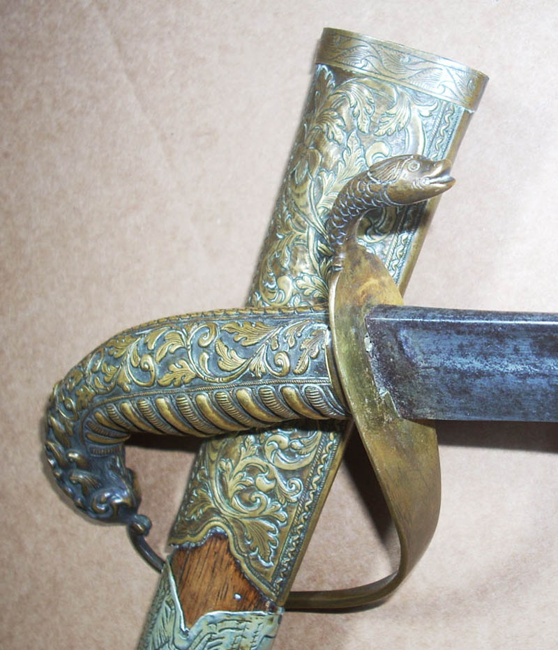

I want to add one more picture: the monster head on the guard. Enjoy!

The blade on this certainly appears from a European hanger, but since it is an interpretation of European form in the mounts, it is hard to place which location might have fashioned it...however SE Asia seems likely. Is brasswork more commonly found there? It seems Indonesia favored more silverwork in the repousse there, would that be a correct assessment?

Speaking as someone who has stared at Vietnamese motifs for way too long, I can say that this does NOT look Vietnamese to me. True, the foliage and curly-cues appear to have a French influence, but even the heavily-French-influenced Vietnamese swords lack the regularity of pattern I'm seeing here.
I like Rick's guess of Malaysia. The scabbard mounts remind me of weapons from there.

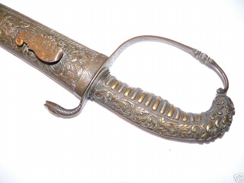

Take a look at the pommel. The ribbed grip is, obviously, patterned after European swords, but the patterning on the pommel looks familiar...I think I've seen something like it in carved ivory. Are there keris handles with this sort of patterning?

It does seem similar to patterns on Madurese keris handles.

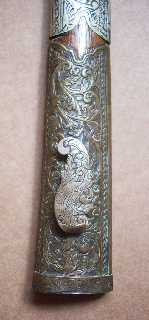

What strikes me is the difference in quality and execution between the white metal 'engraving' and the brass repousse on the scabbard and handle.
Could the white metal be a later addition to the scabbard; possibly to cover the loss of original decoration ?
Old 25th May 2007, 01:51 PM   #21
Nick Wardigo
Nick Wardigo's Avatar
Location: Philadelphia, Pennsylvania, USA
Posts: 54
I agree, Rick...the vast difference in workmanship leads me to think that the white metal fittings were added later. In fact, I find it odd that all of the scabbard fittings are pressed up against one another; it's like the white metal fittings were never intended for this scabbard. I wonder if the white metal fittings came from another weapon entirely and were scavenged to complete this piece.
Nick Wardigo is offline   Reply With Quote
Old 25th May 2007, 02:15 PM   #22
Posts: 6,436
Hi Nick,
Agreed, the white metal pieces are definitely too close to the brass chape and throat.
I can't help but wonder if that area on the scabbard wasn't originally covered with leather or velvet.
Tatyana, does the blade appear to be hand forged?

What do you mean by "hand forged"? Using only manpower? Or the power hummers are also allowed? Are the 19c Europenean blades hand forged? But I am pretty sure that this blade was forged and not made from piece of steel like the modern touristic swords.

Hand forged in the context of my question meant by hand without power appliances; I'm sorry I didn't make my question clear enough.
Does it show a certain crudeness of manufacture that would place it out of the realm of European military blades?

No, it doesn't seem to be crude...
