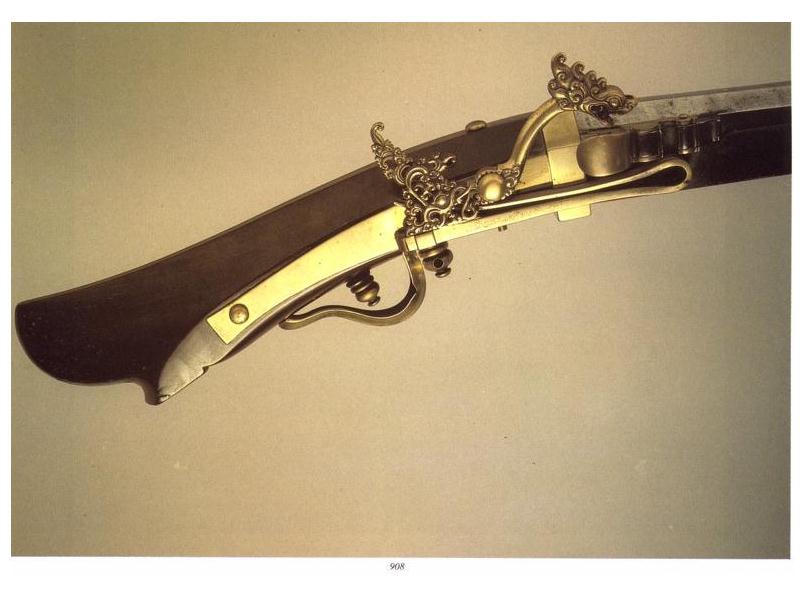

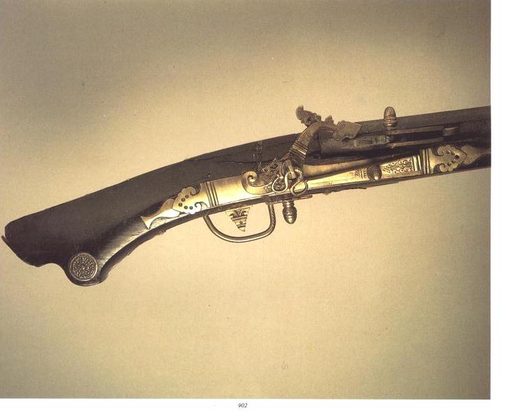

Given that these weapons examples are rarely pictured, i am showing here two of them, scanned from a thematic auction catalogue printed in 1989, on Portuguese discoveries and naval expansion stuff.
Both pieces were produced in Ceylon. The first one was made still in the XVI century. Its total length is 1,70 mts. The barrel, unfortunately not shown in the picture, is from an original Portuguese musket. This is considered a very rare and important specimen; it was exhibited in various places, including the 17th. European Council exhibition, and was pictured for a well known edition of Portugal History.
The second one, a long piece with 1,95 mts. was produced by XVII-XVIII century, after the Portuguese period in Ceylon, but follows entirely the model introduced in the Island by the the son of the first Portuguese Vice-Roy in India, in 1505. It has a decoration of high quality, with details similar to those in pia-faetas. Also considered a very rare piece. The text quotes that Colombo had at the time specialized in matchlocks, exporting them to the other Islands. Part of these arms, however, would not be for active use, but to be exposed in the Temples, as offers to the Divinities.

Thanks for posting these mouth-watering pics! I agree that the bottom specimen (the 1.95 meter one) has all the hallmarks of Ceylonese workmanship, and what a fine and rare example it is!
However, the one in the upper photo is, I believe, to be Malayan as opposed to Ceylonese in origin. I compared them against two published examples, both identified as from Malaya:
A. cat. no. 129, FIREARMS OF THE ISLAMIC WORLD IN THE TAREQ RAJAB MUSEUM, KUWAIT by Robert Elgood
B. Figs. 701-72 in GUNS AND RIFLES OF THE WORLD by Howard Blackmore
Mechanically, these two are identical to the one in the image which you provided. Note the long, straight, slender lockplate with the ornate decorations at each end, and the serpentine which terminates in a stylized zoomorphic head. The flattened triangular triggers, heavy trigger guards with a large ornamented bolt-head protruding from the anterior end, and the rather flattened priming-pans attached to the barrels are also common to all these pieces.
The example in Elgood has the lobed buttstock that is seen in your image (by the way, it is related to a similar profile seen on some styles of Japanese buttstocks as well). The specimen in Blackmore has a squared-off butt which is very similar to that on the matchlocks of neighboring Vietnam. The squared cross-section of the forestock ahead of the trigger, which transitions to half-round for the remainder of its length, is another feature that is carried over into the Vietnamese guns as well.
I would be most interested in seeing a detail of the muzzle of the Portuguese barrel on the top specimen, the one that I think is Malay. If it is of the 16th cent., one would expect to see the sizeable thickened mouldings at the mouth, as shown in the example (the replica made as a commemorative gift to the Japanese government) in Daehnhardt's ESPINGARDA FEITICEIRA. Of all the eastern nations which adopted the Indo-Lusitanian matchlock, Japan is the only one in which these oversized mouldings remained popular long after they disappeared in Europe.

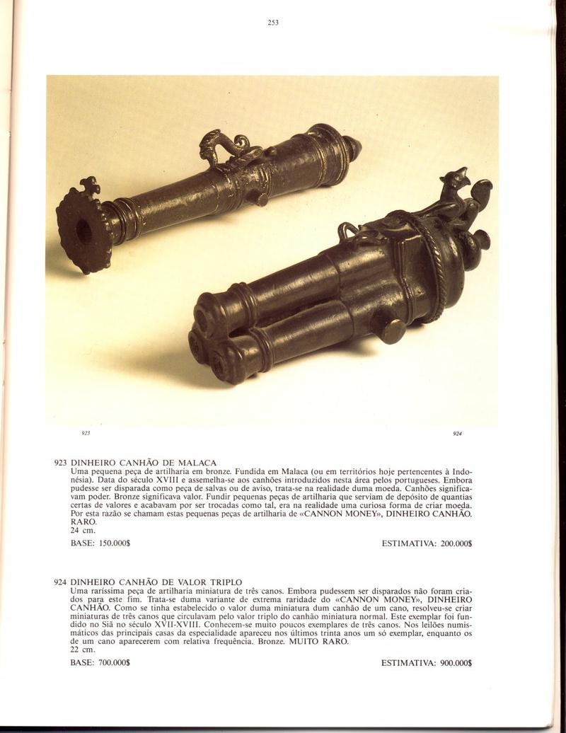

Yes, Lantakas are fun. The so called cannon money.
Just look at these two miniatures. They are functional, by the way, although they measure no more than 22- 24 centimeters. The one barreled specimen was made in Malaca, or somewhere in today's Indonesia, around the XVIII century.
The three barreled one, was intentionally to be worth triple money currency. Made in Siam, around the XVII-XVIII century. Very rare. Only one spotted in thirty years.

Thanks, Fernando, for the mini cannon pictures. I am most amused by the small zoomorphic cannons, usually in the form of crocodiles, tigers, and bulls and with wheels attached, which were reportedly made in Brunei. Gardner, in his KERIS AND OTHER MALAY WEAPONS, shows a couple of these and they are featured in some museum publications from Indonesia and Brunei as well. A peculiar subtype is the bull or ox, with the cannon barrel on the back and firing backwards, over the tail. Gardner shows a rare example with an internal barrel, the muzzle emerging at the bull's buttocks!
