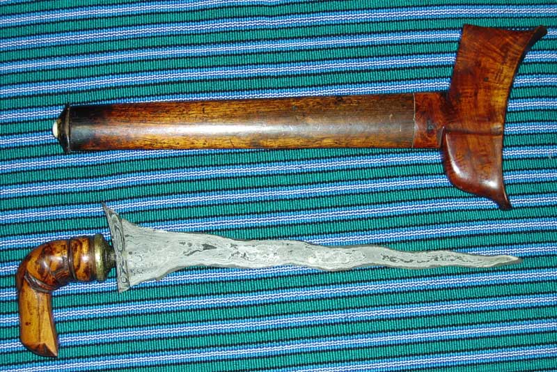

Hi all, maybe some of you remember this keris (my only one, for the moment... ) Now there are some little spots of light rust and my question is: if I put the blade in the pineapple juice the contrasting pamor will disappear? Thank you for the help

Yep, if you soak it in the juice your will ruin the present look of the blade. If the rust areas are small and only on the surface you should be able to deal with the problem on a spot basis. Try some WD-40 and a toothbrush to start. Also make sure that once you deal with the problem that you keep the blade oiled regularly. I tend to cycle through my collection on a monthly basis. Much easier to keep the rust away than to deal with removing it latter...and i get to look at all my blades at least once a month that way.

Thank you David! Indeed the rust was already present when I purchased this kid but (and the situation is the same now, with no more areas of rust) now i'd like to remove it. Yes me too, I need to look frequently my pieces
