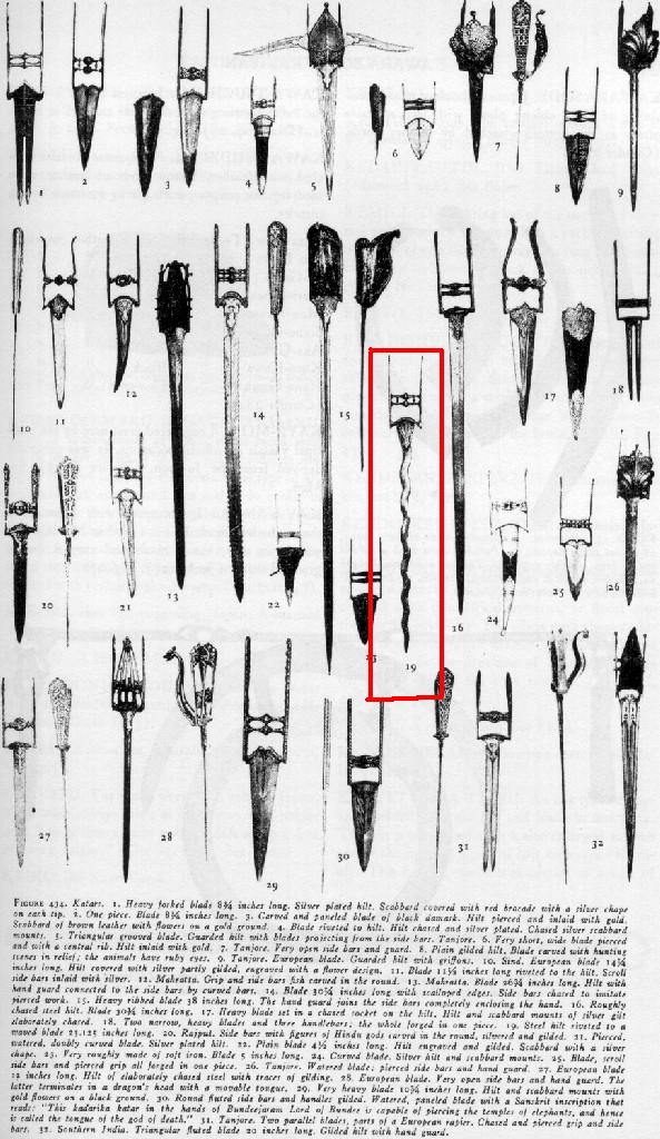

Here are several pictures....one states the evolution of the Katar to Pata....perhaps this is an example of this 'transition'. The other picture shows that the 'wavy' blade is not exclusive to the SEA.

This is a truly unusual example of 'katar' and I agree with B.I.'s assessment of southern India. From the look of the patination etc. it shows good age and likely early 19th c. seems probable. I have not ever seen one of these mounted in this manner, with the transverse grips actually fixed handles welded to the plate type handguard. I agree with Andrew that this piece seems 'ceremonial' as the more two dimensional construction with the plate type guard, rather than contoured hand enclosure suggests that. I dont believe the construction seems weak at all, but the ceremonial application seems supported as well by the nagan or serpentine blade form, which in most cases I have seen have been determined to be in this category.
I think the decorative motif on the guard 'plate' may be the best indicator of the provenance of this distinctly unusual piece. The scalloped edges of the upper and lower udges of the guard plate recall the 'cusped arch' seen in the Peacock Gate of the city palace at Jaipur ("Arts and Crafts of India", Cooper & Gillow, 1996, p.147). While this design here may be Hindu, it is also noted that the four cusp design seen at base of the blade on some Vijayanagara period katars (latter 16th c.) reflect similarity to Muslim architecture ("Hindu Arms and Ritual" p.147). The diamond sectioned diaper pattern enclosing a floral motif seems to me key to Mughal form , and possibly Jens can add more on this.
The holes which may be for the addition of padding also suggest this may be a ceremonial item. It would seem to me that padding would be superfluous to the gauntleted hand of an armored warrior, although we do know that many pieces such as the khandas mentioned and of course patas did have pads.
Elgood has suggested (op.cit.p.147) that on many katar examples of the hooded form padding is absent because of no apparant means of attaching it. Possibly, padding only existed on weapons used by the more pedestrian rank and file? where gauntlets and such armor were not available to them.
This seems a very important and key find and I look forward to learning more from it!! Hopefully there will be more observations from B.I. and Jens on the motif and especially what the floral motif depicts.

Old 11th December 2006, 07:03 PM   #21

The dagger, I feel, shares a close resemblance is in Stone, page 487 fig 1 and 2. Although this dagger seems of completely different form, and has a langet that holds the blade, the overall feel is the same, as is the 'thin' construction. I have seen three of these daggers (inc the Stone/Met) and handled one of them. The image in Stone in decieving, and I feel sure they are of the same grouping.
Jim, your assessment is well written, as ever. I agree that this geometric diaper pattern has definate northern similarites, but also feel it is also a Deccani feature. Bidriware uses a variety of this, and it also decorates both scupture and temples in the south. I think that one aspect (ie the guard decoration) shouldnt be singled out, and maybe it is best to judge this piece as a whole. To me, it screams southern. The difference between Mughal and Deccani can sometimes be very subtle. I am sure i can find a northern piece that simulates this exact pattern, but that still doesnt steer my opinion from a southern origin.

Rick, I am pretty sure that the katar from Leeds holds an Indian blade. They did occasionally go flamboyant, but the thickness, central ridge and steel patina doesnt seem to lend towards a South-East Asian origin. could be wrong though, as I am going by scant memory and the same image you are looking at.

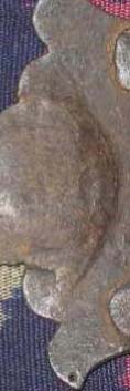

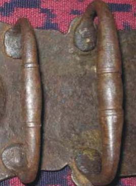

I dont collect these so take what I say with a big pinch of salt.
But to me, It looks like 20th century construction or reconstruction methods. The blade to plate join looks like oxy acetlene welding that even continues to edges of the plate! {although ground,flattened,hammered etc..}Ive never seen any forge welding that looked like that.
I also notice those "draw" handles show that each was at one time riveted or had screws through them they have either remains of the rivets in them or there again have been welded or somesuch. But there are no signs of such riveting on the outside of the plate?
But thats just my observations & thoughts.
Are such "features" usual on these?
