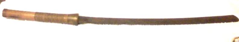

very pleased to have added a Dha to my collection .

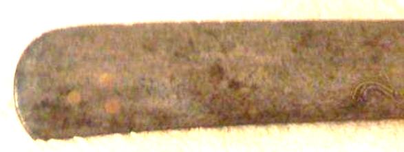

The blade is approx 7mm thick distally tapering to approx 1.5 mm. Blade is 20" long. Has a fuller with scroll work at either end (no pics ...I haven't received it yet). I noticed later, whilst 'messing around' (contrast, brightness etc) with the pictures of the blade that there seems to be 3 brass/copper coloured inserts near to the 'tip'....please what is the significance of this

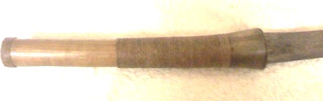

The wooden handle is bound with plaited grass/rattan .... no scabbard, but seems to be a good honest, functional Dha.
The seller stated that this was a 'bring back' and had been in the family for some 60 years and was told it was a 'head hunting' sword.
Could anyone help ID country of origin, possible age etc. ? Thank you kindly

I would guess at talismanic - seen similar decor on other Buddhist influenced pieces. Mark Bowditch or others from the "Dafia" would be of great help....

I think I'll have to wait for better photos before I can give any solid information. I have seen tip inserts like this on a few dha, but I have no idea what they might represent. They can be single, double, or as in this case triple (I have three, do I hear four? ). A talismanic function is possible, but I have no solid evidence that copper or brass, of which these inserts as well as the ones found along the spine of some dha are made, have any particular talismanic function. I am reluctant to say it is talismanic, because its a bit like the way archeoplogists call anything they can't figure out the purpose of a "ritual object."
Burmese? Thai? My guess is Shan (northern Tai).

Nice first dha, katana. I think the brass inserts are just for looks. (Let's apply Occam's Razor until better information becomes available ).

Here's one with two dots.

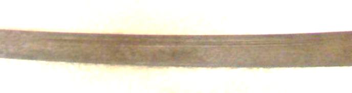

Blade is well made and has some age and seems to be laminated but not certain. Minor problem in that the blade is slightly loose and with some pressure could be pulled out of the hilt. Feels nice in the hand, balance toward the tip.
Very fine rattan strips are plaited and then wound around the rattan handle which has a brass 'ferrule'. Using a magnet ...the tang finishes at the same point as the rattan binding.
The blade is 'wedge shaped' in cross section, the spine rather than being flat has been nicely filed into a 'V' (in cross section) with two brass inserts and incised cross hatching. Looks to be a chiselled shallow groove either side of the blade (fuller ?) Some 'scroll like' decoration either end of the 'line' pattern and the three brass inserts at the tip.
Comments and help with possible age and/or clarification that this is Shan would be great, thank you.

nice blade, mine is without the inset dots, and does not have fullers and has a flat spine, but the spine grooves and inlays are very similar. mine has (from hilt) 2grooves, brass inlay, three grooves, 1.5in gap, 2 grooves, 1.5 in gap, 3 grooves, brass inlay, three grooves, 1 in. gap, 4 grooves.
looks like half your grips rattan rings are missing, they will be fun to replace. if you are not into rattan work, braided string wrapped around & oil varnished could look very similar without being permanent. blade could be re-set into the hilt with cutlers cement (or resin) (Linky ) or pitch, y'all could use nepali laha which is pine rosin, some nice powdered dry dung (for the fibre content) and can be easily heated for removal/re-installation - smells wonderful when heated . depends on how far you want to go. you could of course give it a light clean & oiling/waxing & leave it alone.

I'd have to agree with Mark on this one Shan or Northern Thailand the spine filed in that shape is something I've only seen on swords from those areas, most of the swords in Central Thailand either have a flat or rounded spine.
Many have the cross-hatch and inserts and while there may be some significance to three of each (most I've seen have three) and the Thais believe 3 is a lucky number (at least thats what the gamblers keep telling me) actually all odd numbers are important, can't tell you why but if you look at the nobles umbrella they are all in odd numbers 3, 5, 7, 9 depending on rank. The Erawan (elephant god) is depicted with three heads, Nagas again start with three and go up by odd numbers depending on rank.
The one Mark shows in all in twos (maybe that was the original owners lucky number) but I still doubt that their placement on the weapon is more than decoration.
I've seen fullers running 2/3 to 3/4 length on central Thai swords but they are usually very thin and not deep, yours is more pronounced and with the wonderful scroll work again leads me to believe North.
The handle is very common but does not look Northern Thai. I've seen these in great numbers in Central Thailand (i'll have another look after I finish this) but I'm wondering if it got rehilted, either way the braided grass rings would have gone all the way down to the pommel and if the tang does in fact extend that far into the hilt it would longer than most I've seen dismantled.

Hi Dan, thank you for the additional, interesting information. I am inclined to agree that the blade has been re-hilted, there seems to be a mismatch with the patina of the blade and that of the handle (the seller assures me that this has been in the family for 60 years so will assume the hilt is at least that old.) Could this blade be late 19thC - early 20 th C ?
