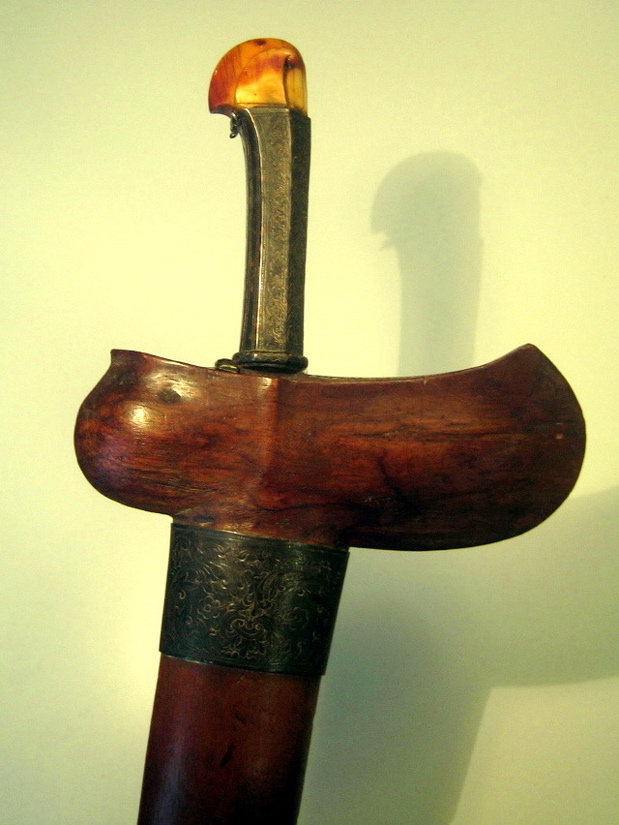

This Kris was part of a lot of Indonesian/Malaysian Keris I found so it was posted on the Keris forum.
I thought it was Sulu, maybe redressed in Borneo.
But Ian noticed that it maybe could be Malaysian and didn't look like a typical Moro Kris.
So I post it here instead with hope of further comments to help me understand from where it originates?
Michael

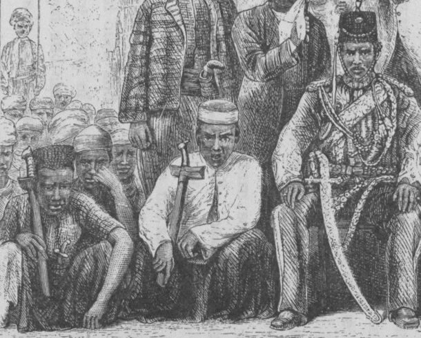

I found this illustration (blew up the relevant part of it) of Sultan Abdullah and chiefs of Perak from 1878."
More pictures at
http://www.kampungnet.com.sg/modules...view_album.php

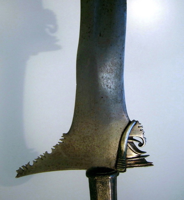

Moro kris with an Indonesian scabbard.
Lew

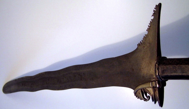

Old 12th December 2006, 05:08 PM   #3
Posts: 7,303
I have to say that the blade itself looks very Moro to me, though the greneng is very Indo. But it seems that i have seen this more Indo looking greneng on other Moro examples and it may just be something retained on early Moro pieces from it's Indo origins. The sheath on the other hand is just a larger version of a Jawa gayaman style and the hilt doesn't look particularly Moro to me, so i would vote for a Moro blade redressed somewhere in Indonesia.

Thanks all for your comments.
The Kris is overall 67 cm/26.4 inch with a 52 cm/20.4 inch blade.
I also think that the blade has some age based on the keris-characteristics, light weight and thin blade.
The only place in Indonesia where I know Moro Kris, or Keris Sundang, have been found is Kalimantan, Sulawesi and Sumatra?
And then of course Malaysia is an option?
Michael

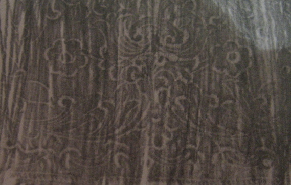

Michael, could you please try to take pencil rubbings from the silverwork engraving? It's hard to see details from pics... Thanks!
Old 12th December 2006, 10:05 PM   #7
VVV
VVV's Avatar
Location: Sweden
Posts: 1,637
Hi Kai,
Never been a great artist but here you have from the scabbard.
Unfortunately the hilt engravings didn't come up.
Michael

Everything but the blade scream Indonesia. The blade is Moro, probably Sulu. The rest - no. This includes the type of chasing work on the silver mounts and especially the silver grip, never mind the scabbard. Trade did go on in the region, not too shocked to see this.

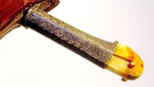

Has anybody seen a pommel of this small size before on a Kris?
Any other clues?
Here is a close up of the hilt.
Michael

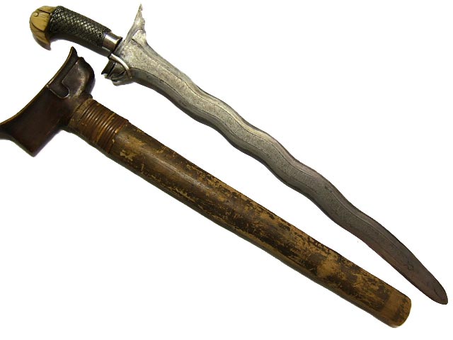

Old 15th December 2006, 02:28 PM   #10
Bill
Location: Chicago area
Posts: 327
From your pictures, the patina on the ivory looks like it's pretty old. It looks like everything is very old. The kakatua on the one I'm posting is bigger, but has some simularities. The "elephant" head is also simular. Would guess the age is about the same on both too. The one I'm posting, I would have thought came from Sulawesi or Brunei. I think there was a post sometime ago where someone stated the metal wrap on the hilt was Malay, Riau or the straits area. The Bugis would be common to the whole area.
Bill is offline   Reply With Quote
Old 15th December 2006, 02:48 PM   #11
VVV
VVV's Avatar
Location: Sweden
Posts: 1,637
Nice Kris!
Do you have a close up of the hilt?
I will try to find the thread you refer to.
Michael
Or a Moro blade made by an Indonesian.
I have seen "crossovers" made by Madura smiths working in Java. You get a little of both.
Bill

Posts: 7,417
Pommels like this, according to Cato, were made early and are indicative of earlier pieces, 1700s? I think the mounts are later.

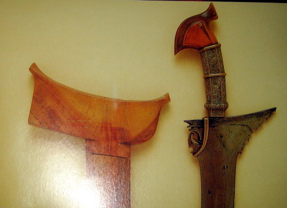

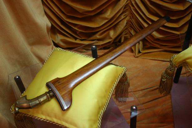

Just recieved this Christmas card from another collector (not active on the forum).
It's from the Tropenmuseum, Kris from the Sulu archipelago, with a full silver hilt collar resembling mine?
Michael
Old 18th December 2006, 05:19 PM   #15
rasdan
rasdan's Avatar
Location: Kuala Lumpur
Posts: 369
The one on the card has malay/bugis fittings IMO whatever...and the blade is Sulu(?). This is an example. I had just seen one like this (solid brass hilt) a few weeks back. Its a relative's pusaka. Unfortunately i dont have pictures. Perhaps the key is the difference of the base of the hilt of a moro and malay keris...
