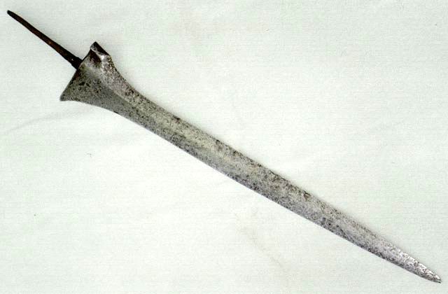

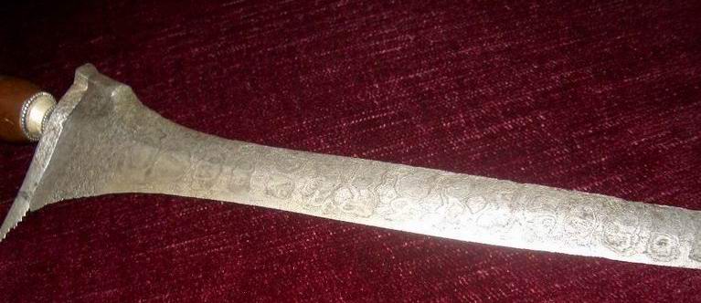

Attached you will find 2 picturtes of a blade before and after treatment. Not very good picture !! sorry.
The mixture is corrosive but slowly. Attached is a kriss panjang that I forged and treated. You can see how the mixture slowly has eaten up the blade and its ganja. It is a way to age a blade.

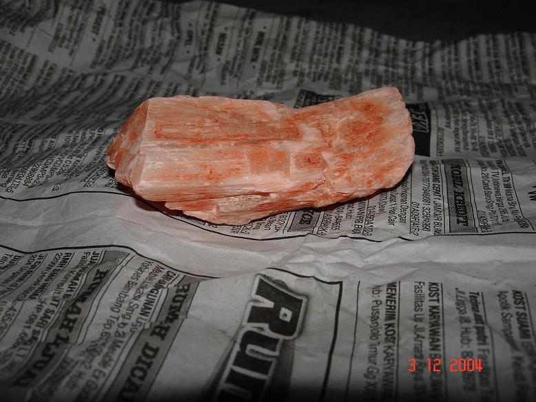

Hi guys,

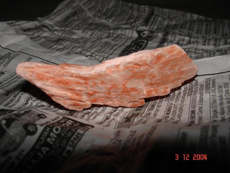

Heres the link to the thread:
http://www.vikingsword.com/vb/showthread.php?t=10
Below are the pictures of the warangan in the above thread.

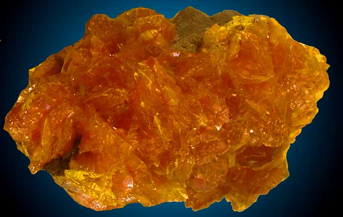

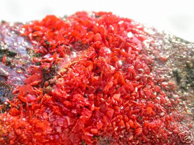

Hi guys thanks for the replys and the pictures ......i have posted some pictures or realgar[arsenic sulfide]the red one ...and orpiment[arsenic trisulfide]the yellow,both of these are easily obtainable[ebay] .What i realy wanted to know was if anyone had tried to use either of these ores in place of the waranga[witch visualy seems to be a diffrent type of arsenic ore][does anyone know the mineral name for waranga?].I was thinking that technicaly either of these should work in the same way and that someone must have tried it.

Hi Capt,
From what i know, warangan is realgar. And yours looks much better with a higher arscenic sulphate content. Unfortunately i havent had the oportunity to use neither since arscenic is a controlled mineral in Malaysia. Perhaps others had experience.

HI guys i thaught id update this thread.After some experimentation i have discovred that Realgar [Arsenic sulfide] works very well once powdred[it crushes easily] and added with most citrus juice[i used grapefruit juice & also tried pineapple ]realgar is easily sourced as a mineral[ebay] so now everyone has the chance to have some fun and can have a go if they wish . [BUT BE CAREFUL THIS IS POISON AFTER ALL]
I also tried orpiment[arsenic trisulfide]but found it hard to powder and didnt work as well.
