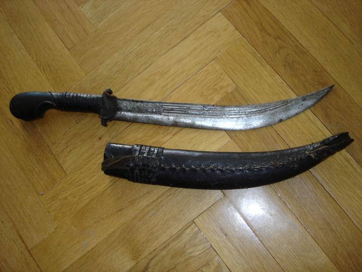

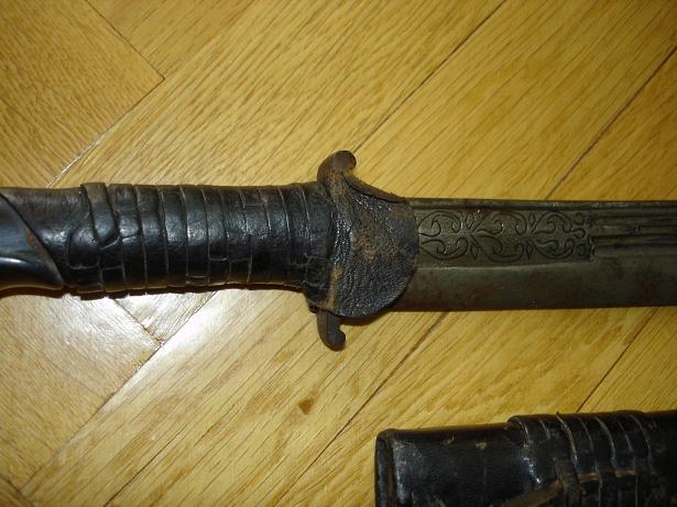

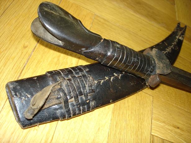

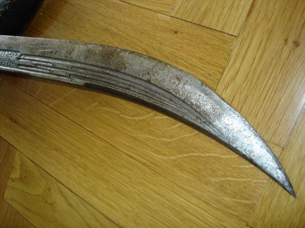

hi.I am sure the first one is from Trabzon, with its blade and hilt form,leather sewing,even leather ears on the each side of the hilt,which are always seen on black sea yataghans as well.

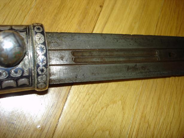

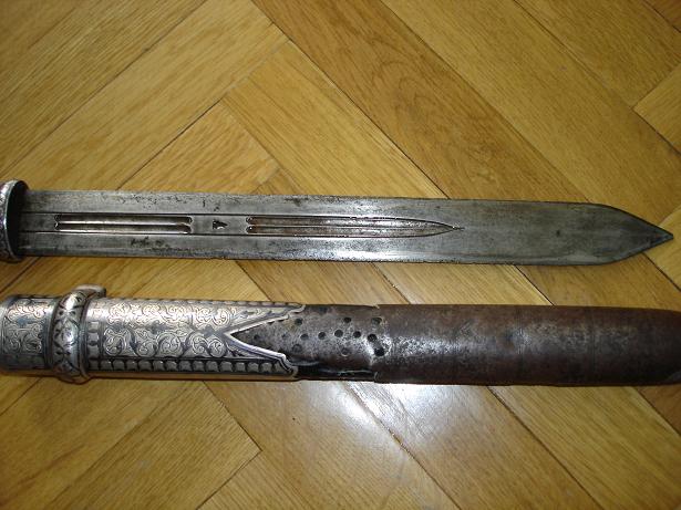

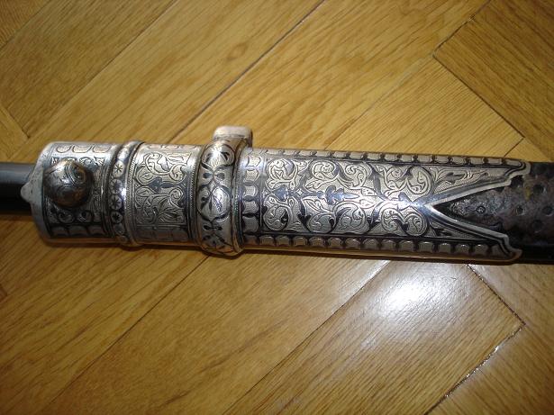

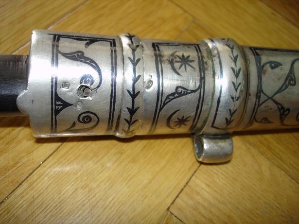

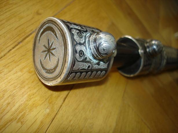

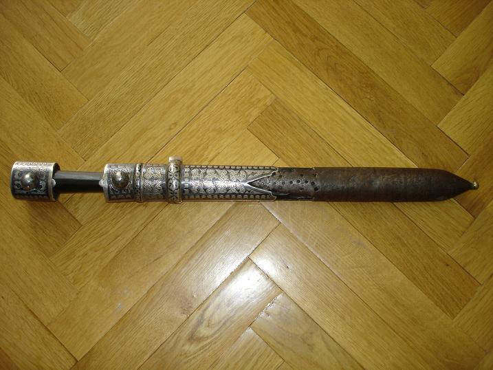

-I think- second one is from Trabzon too. A more special and richer sample compared to ones seen more oftenly in market,like the one in thread http://www.vikingsword.com/vb/showth...hlight=TRABZON . But I request more knowledged members about Caucassian arms like Rivkin or any other to correct me if it is not from Trabzon but somewhere else in the region. All the pieces have Russian 84 stamps. 2nd choice of me would be Azerbaijan due to the eight pointed star inside the crescent, but Ottomans used the same number of points till 1840s too. It was after then the Ottoman flag was turned to 5 pointed star.

erlikhan:
Interesting pieces. What is a "Russian 84 stamp?"

Ian,84 is the silver grade. In today's scale, it means 840 / 1000 silver consistence. In the region Russian mint offices used to stamp silver in latin numbers and Turks,Persians in Arabic numbers.

Erlikhan,
Thank you for your words, however I have to point out that the credit for identifying these is due to Ham.
As with many Trabzon pieces these guys are very interesting. I find it interesting that Trabzon swords would be called shashka if they would be a little longer and quadaras if they would have kindjal hilts.
This is a very classical Trabzon kindjal, however I suspect that they also used to make them in Georgia (Batumi), they have quite a collection of them in Georgia State Museum. The hallmark I think is Tbilisi (bigger resolution pics of marks would help), Baku marks typically have three burning torches.
Alternative explanation would be that someone from Trabzon ordered the silverwork from the north. It also may come from some of the areas that were under russian control in XIXth century ?

Actually I strongly suspect this type of kindjals is characteristic to entire western Georgia - North-East Turkey area. I do not think it is from Azerbaijan, also because niello is not of deep, Dagestani style, but more of a "flat" style, actually I would say quite characteristic for the area. Below are too images - Gurians with kindjals like the one you have, and the map of georgian tribes (as you can see Guria are quite a long way away from the border. One also has to note that in the time entire Adjaria was muslim and the power constantly shifted between Ottomans and Russia (later Georgia).

Ok I will give you my opinion without seeing the silvermark:
it is western georgian, adjarian, made in 1908-1917 (judging by stamped marks).
