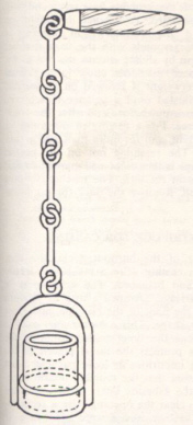

Posts: 6,002
Hand sling for casting. Some big chap might be able to swing quite large flasks.
