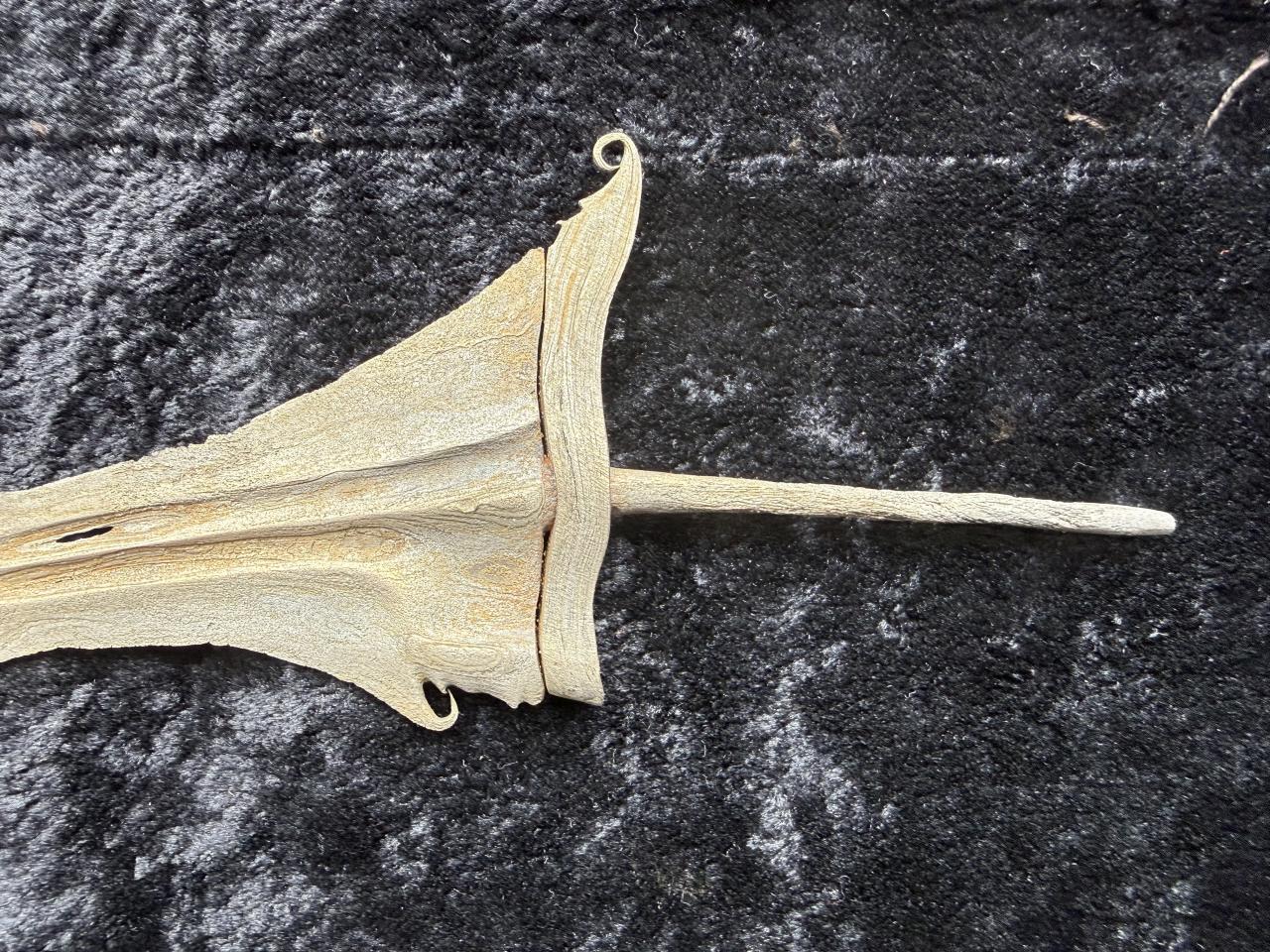

Today's buy,
I bought this Keris from a colleague he inherited together with some other Tjikeroe knives and Golok from his deceased father in law who was stationed in Indonesia just before the war. I found this Keris appealing to me despite the relatively thin blade. (Not super thin) I don't know the Dapur and the ganja is in a form I have not seen often. The dress is relatively simple and plain and does not fit very good inside the Warangka but the ganja is of nice proportion with the curled up grening. I guess the mendak is a cage mendak from West Java if I am correct.
Who can share some more info about it. I thi k it has 7 Luk

Hi Martin,
The ganja is called ganja wilut! The sarung/scabbard looks very West Javanese to my eyes. The blade is sadly very worn!

Hi Detlef,
Yes it's worn but it also shows history, and it has been cleaned often so for me it's also a relic of being cherished. So I cleaned the blade allready just need to stain it with warangan and I will get some lessons from someone I met lately. I learn him French polishing and he learns me to stain traditionally Keris. So in june I will start with a few cleaned Keris.
And it is not the only Keris in my collection that is worn so I am fine with it as I still can see the craftsmenship in them.
And thank you for the reply on my message.
Regards, Martin

Yes Martin, i also believe that it os worth preserving some keris even when they are very worn. I look forward to seeing this blade once it is fully cleaned and stained. I believe the wrongko can be restored to some a much nicer level as well, especially if you are skilled with French Polishing.

I'm a bit late to the party here, been away & very limited access to net & time.
I see this keris as a blade that might have been of some degree of quality at one time but has been largely eaten by time. The attention of a skilled m'ranggi might be able to bring some life back into it. Yeah, I know, a lot of out-of-culture keris collectors will be shocked by the idea of carrying out more than very minor surgery on an old, damaged blade.
This is not the attitude of a knowledgeable Javanese keris person. In Jawa the attitude is that we have a duty, an obligation to preserve an item of tosan aji for future generations, & this means active restoration where this is warranted.
This keris needs care & attention, not just staining.
I cannot accurately count the luk.
The visible luk come to 7, but that produces an unacceptably long distance from final luk to point, so originally this blade might have had 9 luk (current method of count).
I think that the blade is probably East Jawa, possibly Madura Sepuh. I would need it in hand to give a solid, defensible opinion.
The gayaman wrongko retains sufficient distinct characteristics to identify it as a generic gayaman that really, could come from anywhere on the Island of Jawa.
The original work does not permit a precise affixation to the Solo area of Jawa, but the overall form is perhaps possible to fit into a Gandon or Kagok Gabel or Gabel sub-classification of Central Javanese gayaman forms. It does tend towards something that might have originated in Banyumas, but I think that to give it as Banyumas might be stretching things a bit too far.
To comply with Javanese standards it should be given a complete strip, rebuild & polish. The same applies to the hilt & mendak --- but I'd tread gently with the hilt, this would need close examination under magnification before a final decision could be made.

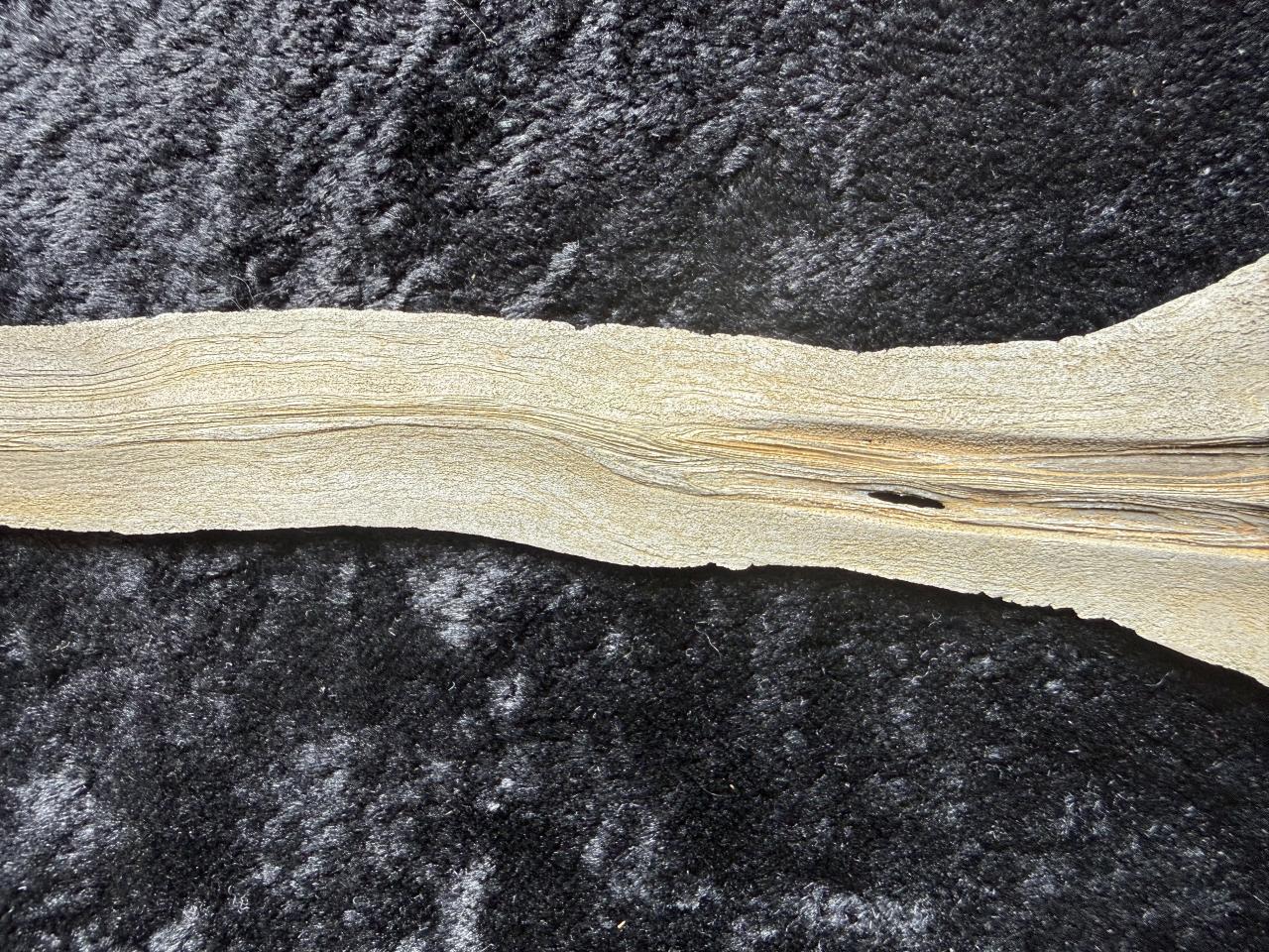

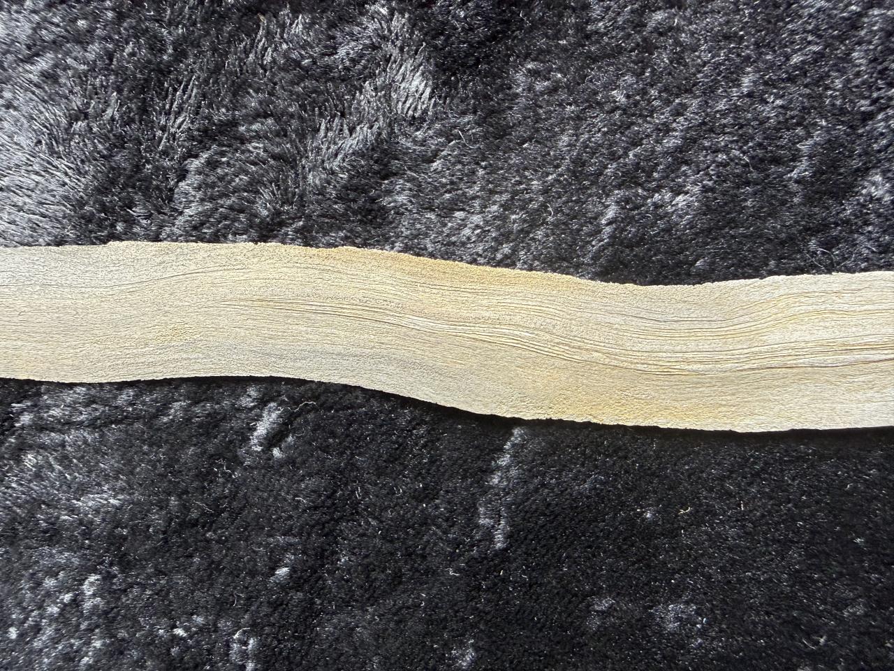

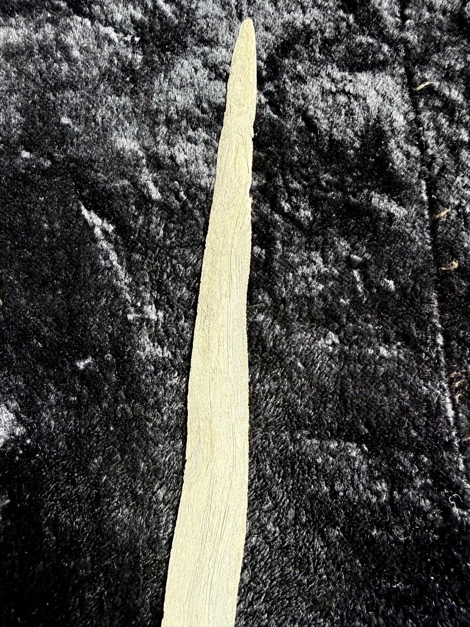

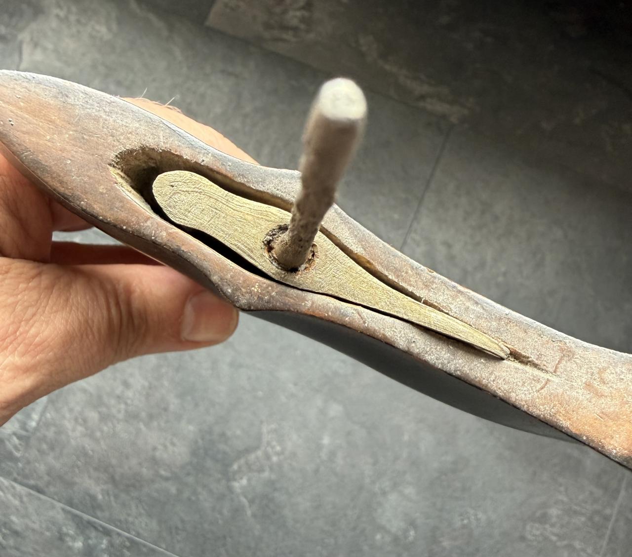

Here the pictures I just took

Posts: 7,225
Not really grinding & polishing Martin, rather it would be a careful appraisal of the blade & the re-shaping of the profile & minor detail work by a master who understood exactly what could & what could not be done with it to improve it.
This is not work for an amateur.
Martin, the whole legend of blades being original to wrongkos & wrongkos being original to blades is very, very poorly understood by most collectors. Different parameters apply in different circumstances.
For your keris my approach would be to marginally recut the mouth of the wrongko to reflect the shape of the gonjo, I would cut it to be a little larger. Then I would fit a contrasting piece of wood into the re-cut mouth & glue it in place with two part epoxy, possibly tinted. I would then inlet the keris to the wrongko. As I said a complete strip, rebuild & re-polish.
Cleaning the blade before staining means that the metal MUST be white before you begin to stain, not just clean, but white. If it is not so you run a high risk of getting a yellowish or sometimes greenish tint in the final stain.

Mr. Maisey,
thank you so much for your explanation, i will first get the blade cleaner and yes i thought allready to restore the wrongko, by adding a mouth piece in it. so the keris has a good fit. I also wonder sometimes why collectors want to redress a complete ensemble by upgrading it all, Most of the time i keep the dress as it is, or restore it, but keep the original (so called) together. I think it would be difficult to find a Master to uplift the condition in the Netherlands so it might be clean the blade till white and stain it again, and accept the wear on the blade and preserve it for the future. Next step will be the wrongo and we will see how it turns out.
