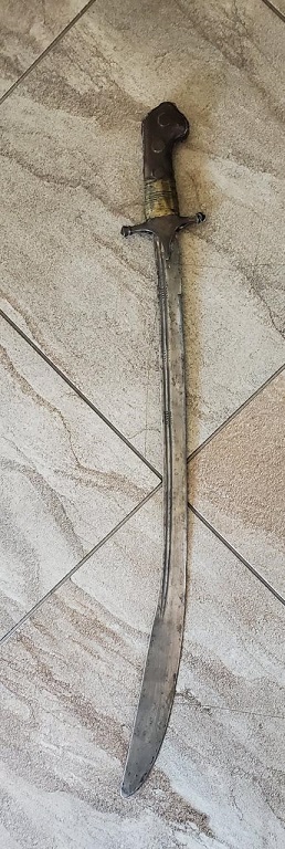

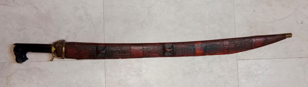

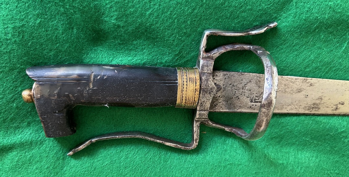

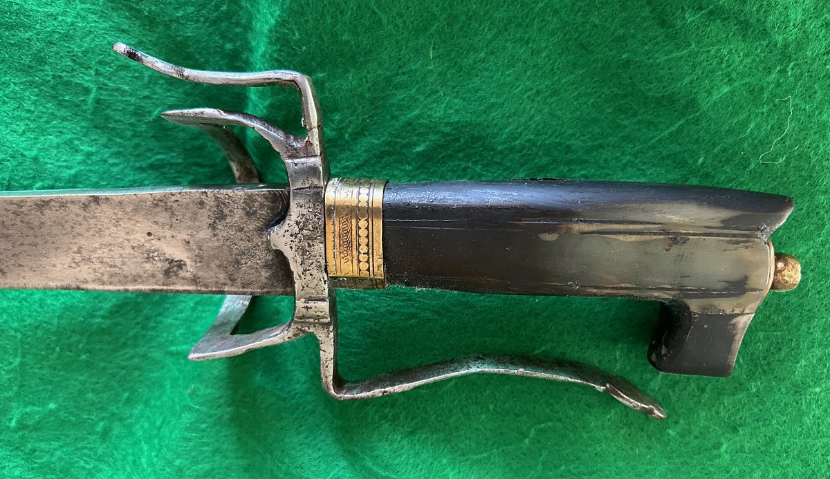

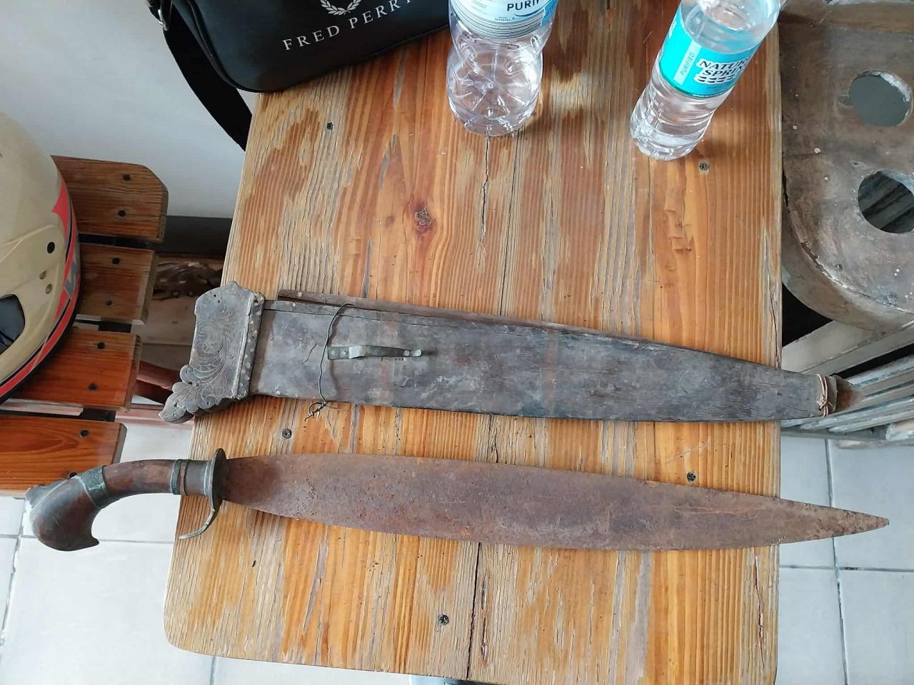

Hello everyone. This is my first post.
I have just bought my first Nimcha.

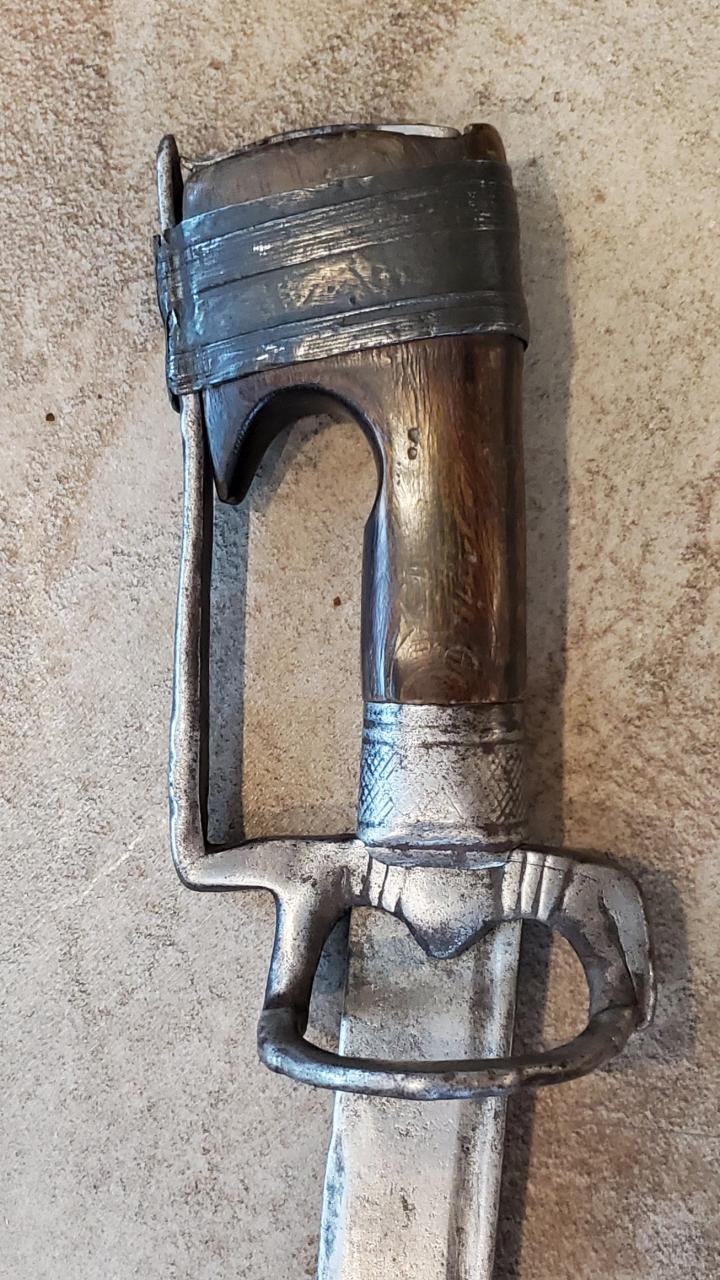

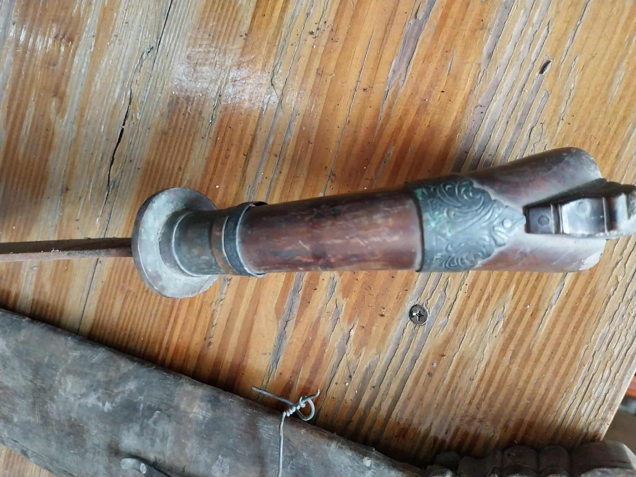

The sabre has a damaged sheath and handle. The handle is from some kind of horn.

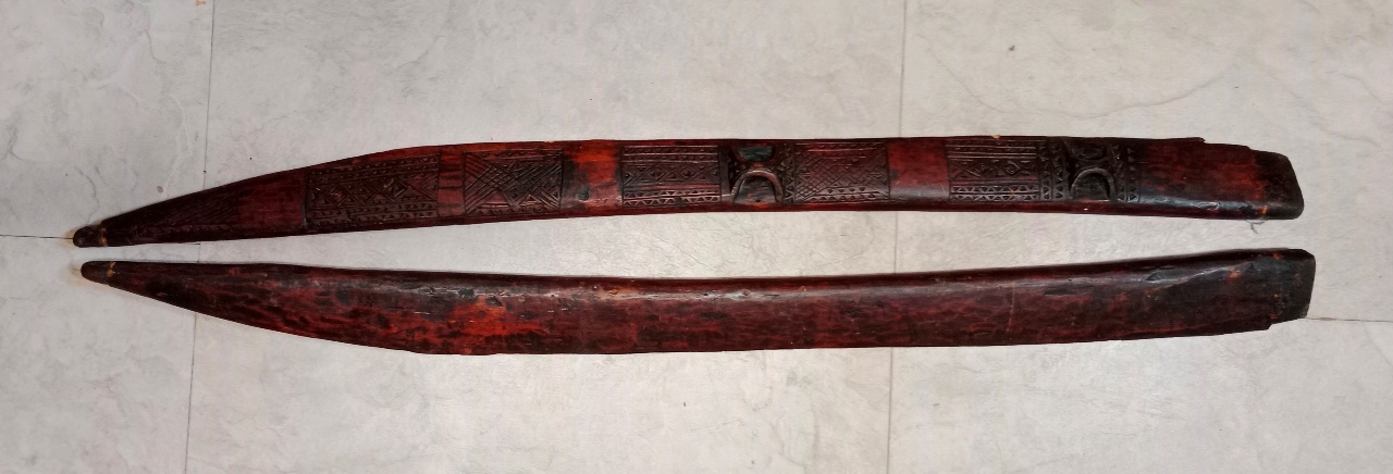

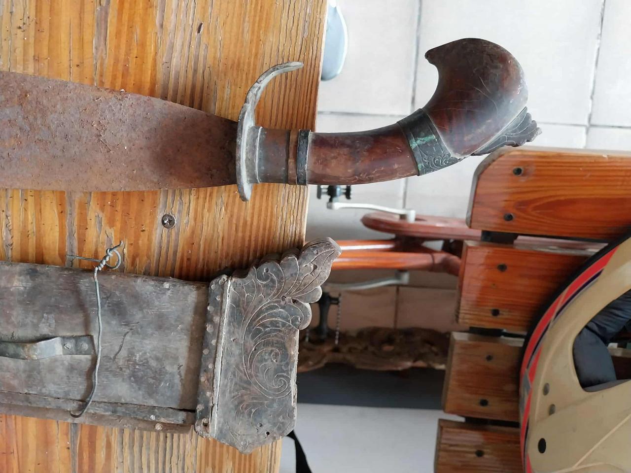

It has an interesting wooden scabbard. Hand-carved.

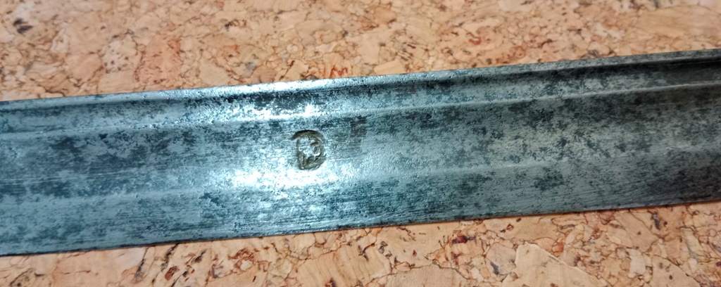

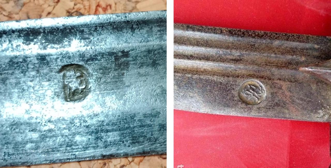

There is a mark stamped on the blade. This is the only marking on this sabre.
I would ask more experienced collectors for their opinion on this sabre, its originality, age etc.
Should its handle be repaired?
Or fit a new one, in the European style?
Thank you for your replies.
Jacenty

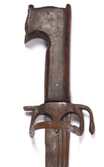

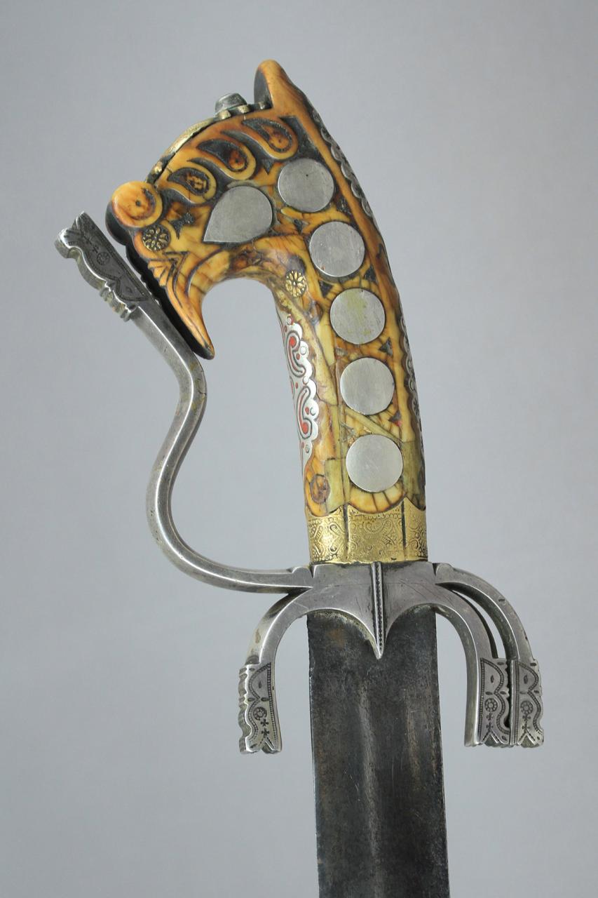

The hilt style (with the relatively thin brass guard and the straight grip with relatively straight projecting relatively symmetric finger hook, and the small projection along the back of the pommel) and in particular the scabbard suggest an Algerian origin. The scabbard is very reminiscent of those on Algerian flyssa. See here for other examples of such scabbards on flyssa and nimcha.
For comparison here are various styles of nimcha grips, where yours is (to my eyes) closest to the third from the left in overall shape:
The Zanzibar types on the right of it are more curved and have a bigger finger hook, while the Moroccan ones on the left are also slightly more curved and usually have a steel guard with thicker branches, a thicker cross piece, and no projection along the back.
Personally I would leave the grip as is. I certainly wouldn't replace it. This style is pretty rare so even a damaged grip is interesting.

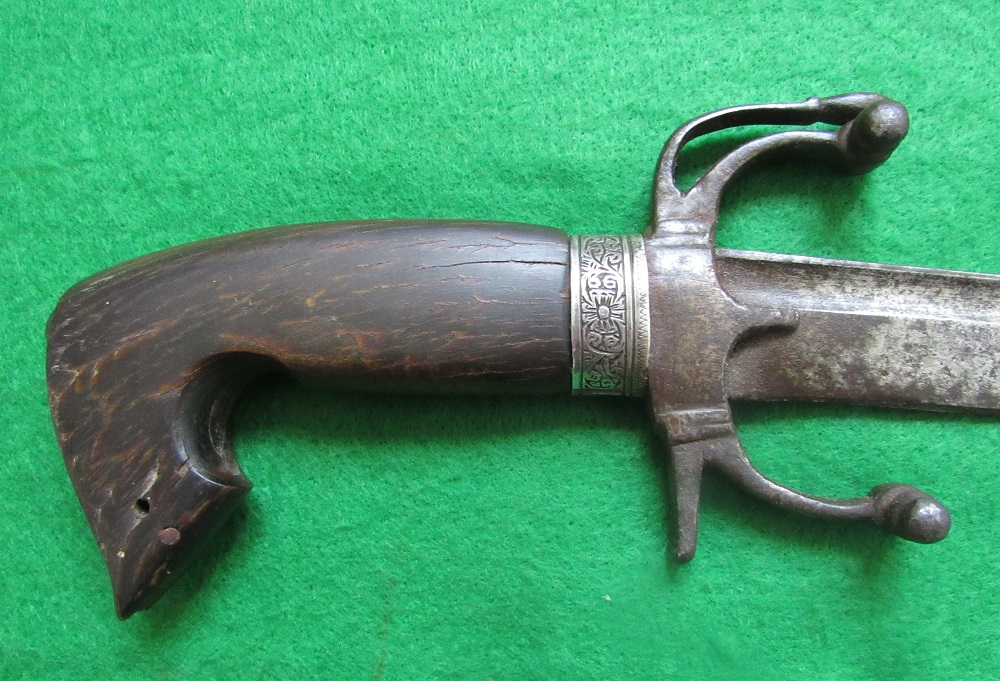

As often the case, ethnographic swords are difficult to identify or classify to a specific area, or for that matter, period. The regions along the North Africa coast from Morocco through Algeria are known as the Maghreb collectively.
This is a remarkable example of what I would refer to as a Maghrebi sa'if, however long ago collectors began referring to these type sabers as 'nimcha'.
Your example, as well noted by Werecow has characteristics of varied influences, and 'nimchas' with this type guard system (knuckleguard and downturned quillons) are known from both Morocco and Algeria. Illustrations of a nimcha discussing the blade in Briggs (1965) refer to an Algerian example, unfortunately the overall sword is not shown.
The scabbard seems clearly Algerian, resembling the pierced pattern wood work of the Kabyle flyssa, but may not be original to the sword so the identification must go to the sword itself.
Identifying these weapons regionally typically goes to the hilt, as blades from many sources were used, and often remounted as they changed hands over generations.
The 'nimcha' itself is an Arab weapon, though it found use in Morocco, Algeria and Zanzibar as well as in Arabia of course. This is well shown in Buttin (1933) where these are shown in number, all identified as Arab sa'if.
The peak on the hilt suggests this is early, probably late 18th-early 19th (though of course the style continued as per tradition) and excitedly noting these times along the Maghrebi coast, that of the Barbary corsairs. Naturally we cannot prove that, but it is a fun possibility.
The blade appears European and likely late 18th c. possibly Italian? but cannot identify the poincon in blade center. The flared distal end suggests again a cutlass type use, which concurs with the pirate use notion, again highly speculative.
While the raised ring guard on this example align with 'Zanzibar' classifications, we now know that while these types of 'nimcha' were well known there, they were by no means exclusive to there. I will say that the peaked pommel does seems more prevalent in the Zanzibar types.
Having said all that, please pardon my exuberance in this long winded entry, but this is a remarkable and exciting example !
Please do not alter or over clean, just stabilize to avoid any further deterioration.
These examples attached are my much later examples, and not nearly the stature of yours......the first 'Zanzibar'....next 'Moroccan', and show the more commonly seen types.

For a first nimcha you have done quite well, congratulations. The scabbard is likely a replacement, but the decorations are indeed very similar to those on flyssa scabbards, which suggests a Kabyle reuse at some point. The blade and hilt are older, and I agree with Jim's 18th century guess on them. I wonder if the tip profile was changed as well at some point, as the widening is typically far more dramatic.
I personally quite like your nimcha as an example of a weapon which was used and repurposed over a couple of centuries.

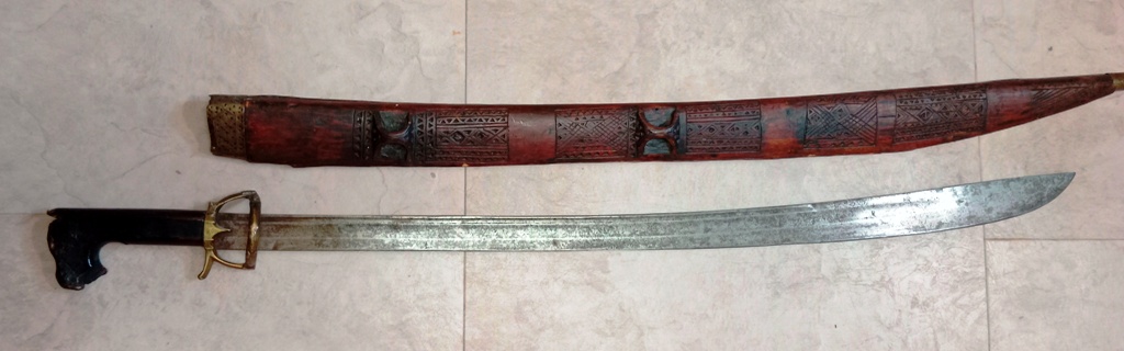

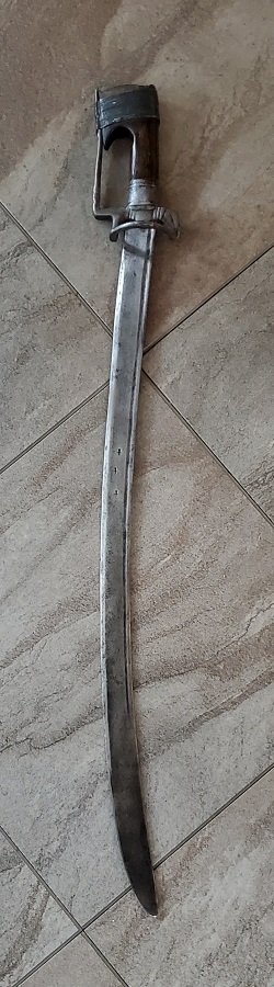

I give the dimensions of the sabre:
overall length: 950 mm,
blade dimensions: length. 815 mm, width 32.3 mm, ( at the hilt 41.3 mm), thickness 6.2 mm...,
deflection 2 cm.
The blade has a length like that of a cavalryman.
The head is springy. When held by the hilt (tip) it bends like a spade.

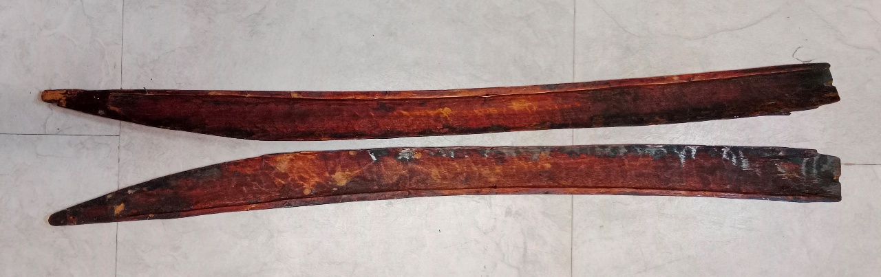

The sabre scabbard is made in a primitive manner. Two woods connected by nails. The wood is stained. At the ends of the scabbard were applied clamps of brass plate.

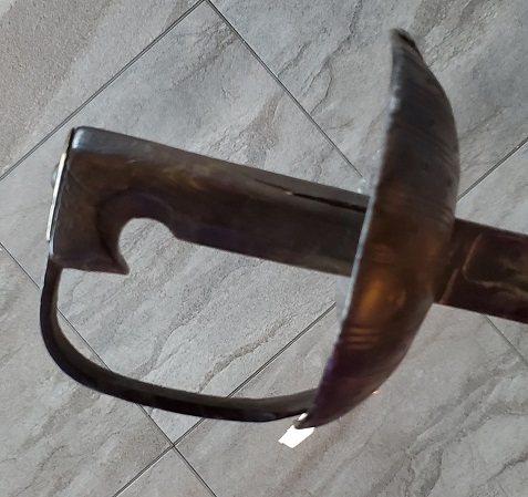

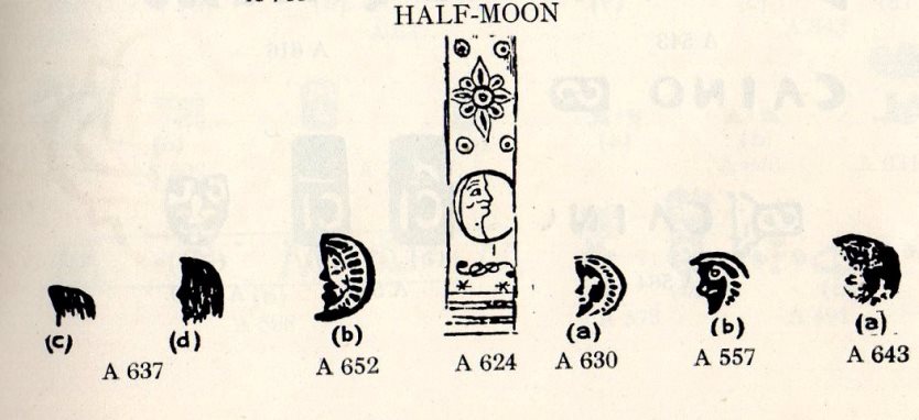

It's also worth pointing out that Eric Claude mentions that most of the "Algerian" nimcha blades come from Genoa, but of course there was also the connection with Spain, so perhaps the stamp is a slightly atypical rendering of the half moon mark?
Old 9th July 2024, 05:19 PM   #9
Posts: 10,872
Very astutely noted Werecow!!! That does look like the Toledo espadero del rey half moon and as copied often placed in blade center (contrary to actual use on Spanish blades). While Solingen of course was well known for spurious use of markings and names from Toledo on their blades, the configuration here seems more like perhaps placed in either Yemeni or other trade blade entrepot.

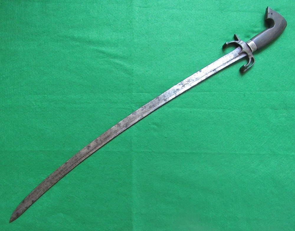

Here I would note in post #2, the plate of nimchas with green background...the FAR right example with hilt canted sharply and with three peaked elements......this is a hilt form attributed to Hadhemaut, south Yemen. It is noted as similar to the same type hilt found on the 'billao' weapons of Somalia. Again, the cross influence of form and elements through trade or other interaction.

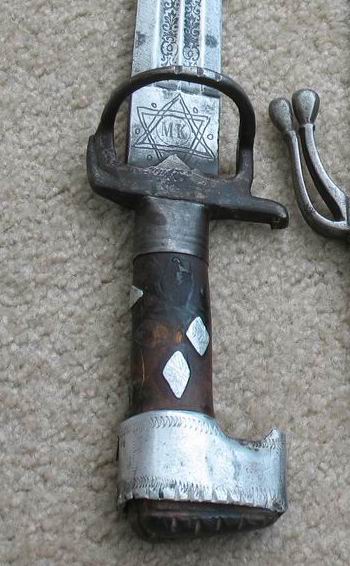

I found another Nimcha on this forum with a similar seal to the one on my sabre. Perhaps it is just a coincidence?
Jacenty is offline   Reply With Quote

Thank you for that note Teodor, I recall seeing that most interesting nimcha here on the pages years ago. It was fascinating to me mostly from that remarkable blade which I found associated with the Armenian importer Kevorkian in Harar, Ethiopia.
The simplicity and style of the hilt with the 'D guard' which has become known colloquially in collectors parlance as 'Zanzibar' I totally agree is likely Yemeni, as likely my own example previously posted in this thread.
Here I would note that a great many swords, and blades went from Ethiopia into Yemen primarily to obtain the rhino horn from the hilts. This of course offered a supply of blades, many of which were mounted in San'aa in various hilt forms, and resulting in the presence often of Ge'ez script from Amharic inscriptions on many Arab swords.
The first reference to these ring guard hilts as Zanzibari was in "Les Armes Blanches du Monde Islamique" , Alain Jacob, 1985. When I acquired my example years ago from Oriental Arms, Artzi explained to me that it was one of about 40 he got from an old armory in Yemen, and that these swords had come from Zanzibar. I have forgotten how long ago he noted this acquisition happened but I presume it may have been in the 80s.
It was interesting in researching these, one of the key references commonly used was Charles Buttin's 1933 catalogue, where these types were included with a large grouping of examples of the North African types, and all are listed only as Arab sa'if. There is no specific classification to Zanzibar, Morocco, Algeria or other....and as asserted by Dominique Buttin (pers. cov. 2004)...these are all simply Arab sa'if.
I agree that the Algerian attributions are likely correct, and the association with the Kabyle type wood scabbard is compelling evidence. Here I would note that George C. Stone in his venerable compendium (1934) referred to the 'nimcha' as Algerian. It has been suggested that the diffusion of the form into Morocco was probably via the Sunni following of the Maliki School of Islam.
The preferences of local artisans for materials used in mounting of the various numbers of blades circulating through mostly trade networks seems of course inconsistent and probably relied on many factors. It does not seem there is any viable axiom to classify these 'nimcha' forms to region or period other than sound provenance or notable propensity of type to area.
That factored in with the long circulation of blades which often ended up in trade circumstances many times over, as well as the fact that these swords were often important as gifts or awards further accounts for diffusion.
Attachment 238636
More compelling evidence that this is Algerian! It does seem that trade centers in Algeria had workers who indeed used cold stamps which replicated well known marks to suggest blade quality and impress buyers. Again this is seen in Briggs(1965) in his illustration of a nimcha with three groove fullers like this.
He was situated in Algeria when he wrote his work on the blades used in Tuareg swords and daggers, so his focus on blades became one of the key references on the topic.
Attachment 238636
Interesting! Where did you spot this one? Would be good to cross link these threads.

This blade designation is in this entry:
http://www.vikingsword.com/vb/showth...ghlight=nimcha

- the mark is a kind of usual "maker marks" put in algeria with oviously an ottoman inspiration. We usually find a circle (or more rarely, shapes like on ottoman swords, like a circle, with some additionnal shape over it), with some arabic writtings in it.

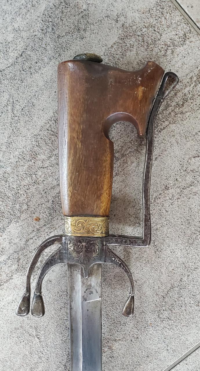

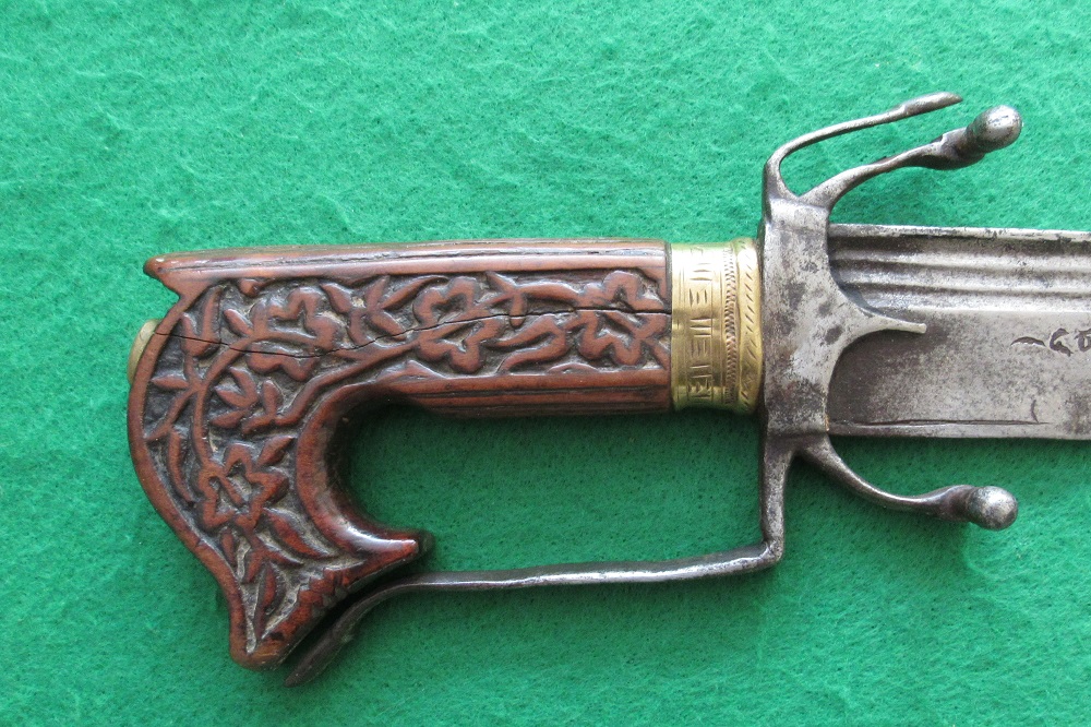

PICTURES :

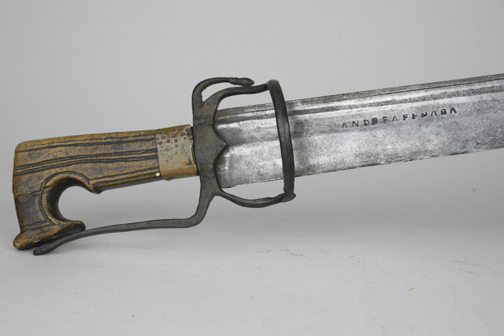

Here is model close to yours, but less "boarding" shape. Note the "missing" part on the handle. Usually algerian fill it with a textured (repooussé work) silver plate, or something natural like ivory or tortoil shell. For this one the gard is in steel, but still having that "ring" shape.
May I ask you if I could use your picture/sword as an exemple for my book (and mentionning the owner, of course) ?
And if anyone knows the owner of the second ones, yatagan and nimcha with Iflissen scabbard, it would be so amazing !!
PS. Thanks a lot to all who helped me in that project, I'm really becoming to it like a common work, so thanks again for that !!

(Sorry here is the picture)

Old 6th August 2025, 02:04 AM   #19
fennec
Join Date: Feb 2023
Location: France
Posts: 41
Originally Posted by werecow View Post
Probably worth pointing out that this rare saber unfortunately got destroyed and it's blade repurposed by its owner.
"Destroyed".... I mean.... Okay... :confus::confus::confus:
I've heard that story recently, and my algerian hearth bleed... haha but no judgement, everyone is free to use his stuff how he want !
Thanks for the info !
fennec is offline   Reply With Quote
Thank you for posting this sword Khaled. I have always wondered about the origin of this particular type of steel guard with a ring. Your example makes a strong case for an Algerian attribution.
I am attaching the pictures of a sword I have with this type of guard (the blade and hilt are of no help here), followed by an example from the Quai Branly and another from Oriental Arms sold archive.
Teodor
Old 31st August 2025, 05:36 AM   #21
fennec
Join Date: Feb 2023
Location: France
Posts: 41
Hi Theodor, its a pleasure to enlight as much I can.
You right, it is quite difficult to define a nimcha (especially algerian, that mixed a lot of styles, due to a lot of influence of the algerian fleet at this era, I guess), only by one element, as the blade only, or the hanlde, only, etc... I usually have to combine many points to be sure that a model is algerian, especially for some very "modest" ones, that dont display a lot of particularitis ( a handle shape shared with morocco, a classic guard, a straight sword, no scabbard, etc...).
For yours, not only the guard lead me to an algerian origin, but also the handle. to be "simple", Ive seen those "agressive" shapes of nimcha, only in algeria. Moroccan ones are more "big and round" usually, the handle is not straight, and generally goes larger for some centimeters after the guard. Of course those shapes are also very common in algeria, especially in the ouest (remember that algeria is very big, even in the past, a nimcha close to morocco, should be quite different from one from the east). But those kinds, more "geometric", more agressive, with a "spine" in the pommel (that remember some ones on what I call "boarding algerian nimcha", those ones with an austrian/italian sword, and luxury handles), are very tipical from algeria (and I guess, around Algiers).
Another element for me is the marks on it, those lines running from the guard to the pommel. This is also tipically algerian, and you can even see them on the last picture you shared. For me, this si again like a reminding of those handles with more details, those lines make generally a border between the central part, that could hold some luxury material, and the edges. This is something like a "visual reminding" of this esthethic, in my thought.
Best regards

Fennec, thank you for input. You make a lot of great points. As the biggest country in Africa now, Algeria is so vast that some regional variation is to be expected.
Here is another nimcha, ex Claude, published in his book. The hilt to me looks Moroccan, but Claude classifies it as Algerian.

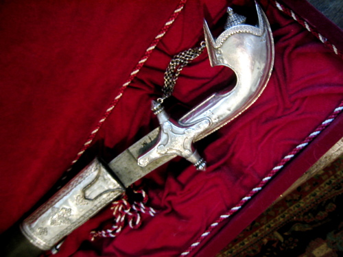

Old 31st August 2025, 03:52 PM   #23
Posts: 10,872
It seems there has long been a great deal of confusion on the 'nimcha'.
Setting aside the misnomer of the term itself, the classifications as to where the forms might be attributed has been baffling.
It does seem that the most familiar type without the ring on the guard is typically regarded as Moroccan. However Stone (1934) if I recall, does refer to these as Algerian. It seems that the attribution was based possibly on the broader association with the Malakite rite (if I recall) school of Islam? which transcended Algerian and Moroccan borders of course.
This example of 'ring guard' nimcha I acquired from Artzi about 24 years ago and it was said to be of a batch of 40 varied examples from an armory in Yemen some years before. Then he had noted these had been mounted in Zanzibar and to supply Yemeni forces during the various conflicts years before.
I believe I saw this attribution in the book by Alain Jacob (1985) as well.
In Buttin (1933) of course no such attribution to Zanzibar or specifically to Morocco or Algeria is made, only that these are ARAB sabers.
So if I understand, it appears that my example would be Algerian?
Though I know that there are nimchas attributable to Zanzibar, this ring guard feature appears to not be a factor.
The last image is a Moroccan sa'if (Moroccan markings at forte).
PS.....anyone know where I might find a copy of Eric Claudes book????
Old 31st August 2025, 06:08 PM   #24
TVV
TVV's Avatar
Location: Bay Area
Posts: 1,770
Jim, your example is Yemeni.

Hi my friend.
Oh yeah I know it very well, I've even write some lines about it on my book. I've passed some days trying to find a meaning to the "magical square" and other writtings on it, making crosschecks with local algerian believes (well... may be I have to talk about Al Buni once.. or just publish that ****) etc..
So, yeah, for me it is an algerian sword.
First of all the guard, never seen one like that in morocco. Then the sword, more a "navy one", that those straight cavalery used in our neighbours coutry. Of course the writtings on it, that are, for me, also more used in algeria (many many swords wrote that way, or with full sentence.. never or very rarely seen in that "simple way" in morocco).
The hilt also display a pattern (floral shapes with 5 point flowers) that is common in Kabylie, and already used on some other pieces (I'll search exemple as soon as I can). And the shape of the hilt itself, note that little spine on the bottom, and a bit more textured pommel (the part that faces the quillon, its look a bit like the handle of those tourist/mariage little curved flissa). And of course, also the lines on each spine of it, Ive talked about before.
And then the scabbard, also an algerian thing for me... very common in algeria to find those "simple made" scabbard, with just a piece of brass as top and bottom, where morrocan usually make another kind of work, not to say more stylish haha...

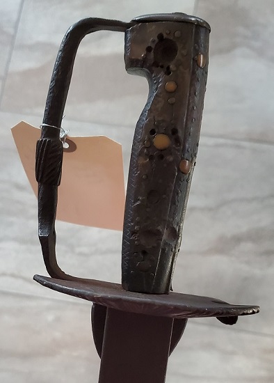

Old 10th September 2025, 06:30 AM   #28
TVV
TVV's Avatar
Location: Bay Area
Posts: 1,770
When it comes to this type of guard, here is another sword with it and an English hanger blade. That one does look very Moroccan.
Old 16th September 2025, 06:39 AM   #29
serdar
serdar's Avatar
Join Date: Feb 2023
Posts: 254
Didnt that style with half ring on a side originated from italy? And from them into maroco and algeria?
Below are pictures of italian sword from the end of 14 century with councile of ten marking from private collection, a photo from museum of Florence, and a photo of a sword from Perast, all italian made with tracable and documented history.
serdar is offline   Reply With Quote
Old 19th September 2025, 06:07 PM   #30
TVV
TVV's Avatar
Location: Bay Area
Posts: 1,770
Yes, the style of guard originated on stortas in Italy, and was then copied by corsairs in North Africa.
