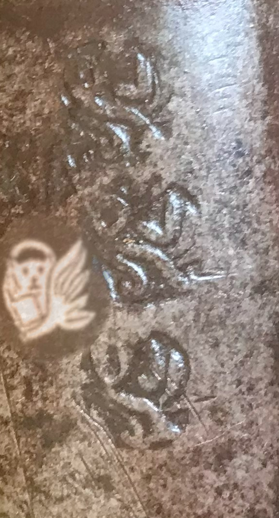

The markings stamped into the stock are interesting, and it seems that there may have been some copying of 'official' issue type markings and numbers used in imitation of military guns with these improvisations.
