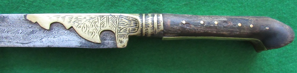

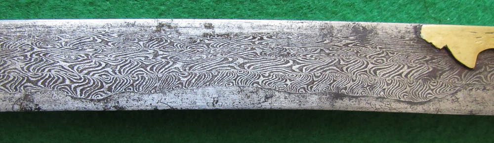

I feel very fortunate to have acquired what I believe is a relatively early yataghan. The reason I think it is early is because of the blade profile - shorter and wider than later examples. I will expand on similar examples later.

congratulations with your yataghan!
What confuses me a little is the different bolsters (indicated as #4 in the first picture) versus all the above pictures.
Any data on lenght of the blades or the age of the 4 pieces?
I took the liberty to put them together and can not figure out the difference versus age....but that could be my limited knowledge
The blade is very nice and in excellent condition, with a beautiful stamp.
Specially if I would follow your case with regards to being an early yataghan

The earliest dated yataghan with twisted rod pattern (Turkish ribbon) to my knowledge is from 1592. Around this date twisted rod pattern appears also in Asia and SEAsia.

GP, congratulations on your new yataghan. I have what I believe is a similar yataghan, except mine has lost the original leather on the scabbard and has been shortened. The scabbard has a very similar pattern carved on it and ends similarly in a thimble at the chape. Based on the scabbard and the thimble, I used to think it was Algerian, but now I am not so sure. When I showed mine to some yataghan collectors in Bulgaria they thought that it was from Macedonia or Northern Greece, at least based on the hilt and bolster.
Name:  Algerian Yataghan 03a.jpg
Name:  Algerian Yataghan 03c.jpg
Name:  Algerian Yataghan 03b.jpg
Name:  Algerian Yataghan 03g.jpg
Your question about the relation between yataghans and the sikas and machairas of Thracians, Illyrians, Dacians and some of the Celts which settled in the Balkans during Antiquity is a very good one. I personally believe there is a relation, but I cannot prove it in any conclusive manner and I do not really want to create even more controversy in this thread.
Attachment 241859
Attachment 241860
Attachment 241862
Attachment 241863
