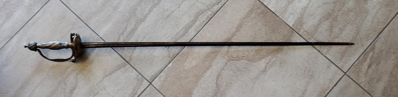

Default repurposed rapier blades

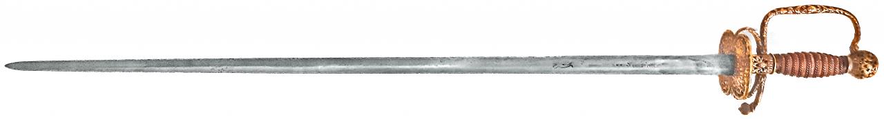

Hello Folks; wishing you all the best for '25.
Hi Jim. You will recall that just last week I suggested that the Portuguese and Spanish appeared to prefer their slim rapier blades on small-sword hilts, rather than the rapidly becoming ubiquitous 'hollowed' blades. I wondered if there was many examples of Iberian smallswords with hollow blades.

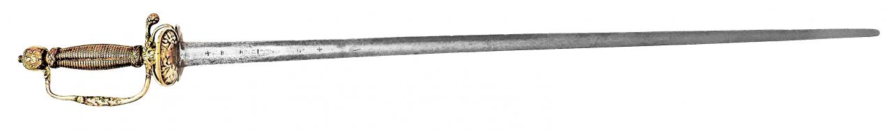

I have two swords: one is a Portuguese smallsword/court-sword with a re-purposed slim rapier blade, and the other a Spanish court-sword hilt, again on a slim rapier blade (see below).
Until the arrival of Klingenthal manufacturing, hollow blades only came from Solingen and Shotley Bridge; I don't know what political circumstances existed between these countries which may have made it necessary – or opportune – to re-use what would obviously have been a profusion of rapier blades in Portugal and Spain.
I have never seen a hollow-bladed smallsword distinctly attributed to Portugal or Spain and I am beginning to suspect they did not predominate; however, my experience is limited and – consequently – I call on the forum to disabuse me of my suspicions if necessary… Fernando would know for sure.
It seems absolutely possible that the blades they had carried and fought-with so effectively, and for so long, would not be abandoned causally, and certainly not to oblige fashions.

One thing is for certain, and that is the balance/weight of the rapier blade in a smallsword hilt: it is much further forward compared to a trefoil blade. This will certainly influence the style of fighting; the rapier blade will demand a great degree of destreza compared to the modern smallsword techniques. I would imagine this alone would influence to repurposing of the rapier blade.

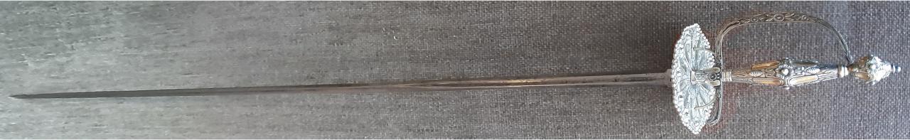

Well… so much for my theory!

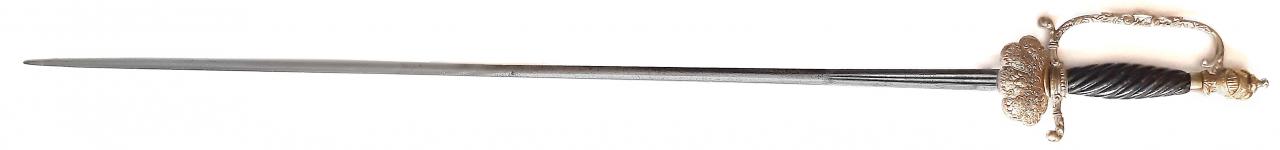

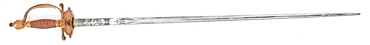

I compared the Portuguese, rapier bladed, smallsword with a typical silver-hilted French hollow blade smallsword and surprise, surprise: both have 32" blades and both have a balance point at 4" from the shell; identical!
Admittedly, 32" is generally the maximum length for a small-sword, although colichemardes tend to be at least that, and often a little longer.

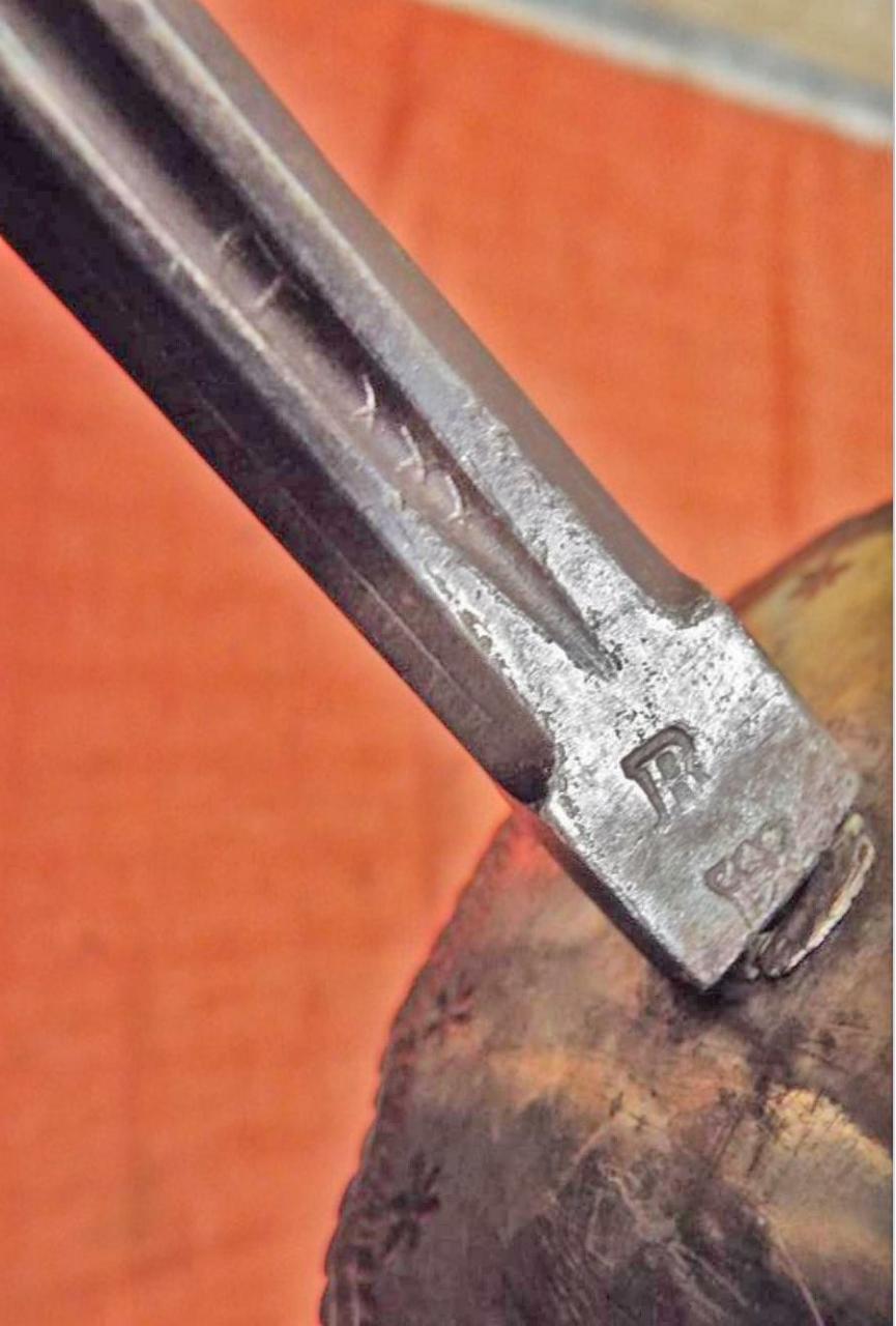

If you look carefully, you will see that the tang of the rapier blade has been reduced at the ricasso as well as being shortened at the foible, producing this balanced weight.
All together, I would imagine there is little to choose between the two as far as technique is concerned which would have been very satisfactory back then with all those rapier blades to choose from.
ps
Note the King's Head punzone on the ricasso.

One thing I didn't indicate was the weight of the two swords:
the hollow blade French smallsword is c.35g
the rapier blade Portuguese smallsword is c.40g
So, a little heavier, which is apparent when holding them.

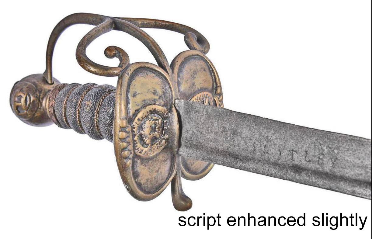

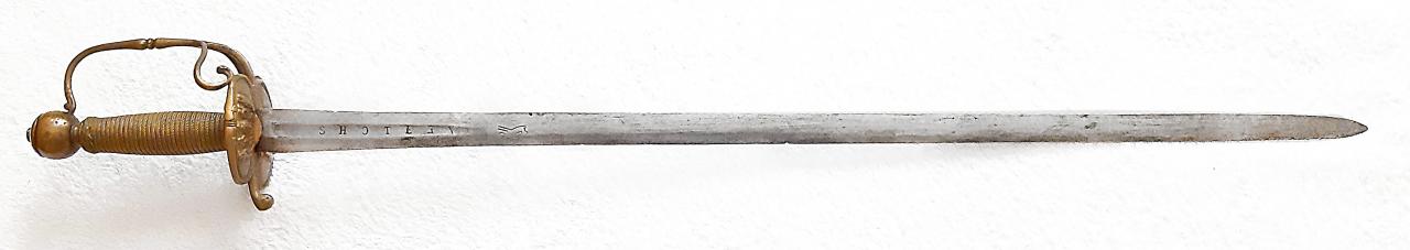

Up here in the North of England, and over into Scotland, there existed (I know this because many still do) a lot of smallswords with narrow double edged blades.
It seems that, at first, the hollow blades were not popular up North.
I have two Shotley Bridge smallswords from 1688, with 28 and 29 inch double-edged, 1 inch wide (at the shell) blades. Both have very sharp edges but are not especially pointed.
One is 60g, the other 65g, with mainly the hilts contributing to the difference. Balance points: 4 and 4.5 inches.
I believe we are seeing a lack of accessible instruction for the new smallsword techniques, but predominantly a 'dyed-in-the-wool' confidence in weightier, sharp-edged swords.
The hollow blade smallsword was not everyone's cup of tea.

Yes, I absolutely mean 600 and 650gr... what was I thinking?!
Those are exactly the kind of early smallswords we find predominating up in the North of the British Isles. They were made in Shotley Bridge between 1688 and 1691 but almost certainly nearer to '88. I have seen several more of almost identical design.
They would have been in the hands of local Jacobites and were definitely dress swords. The military versions were horseman's swords with broader blades of the same length (30") but those blades were smuggled in from Solingen and feature the Passau Wolf, whereas the smallswords have the Oley bushy tailed fox.

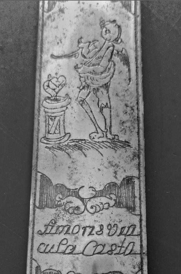

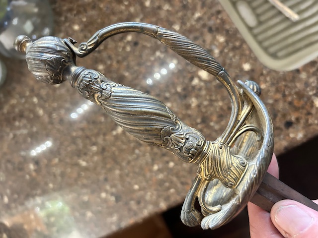

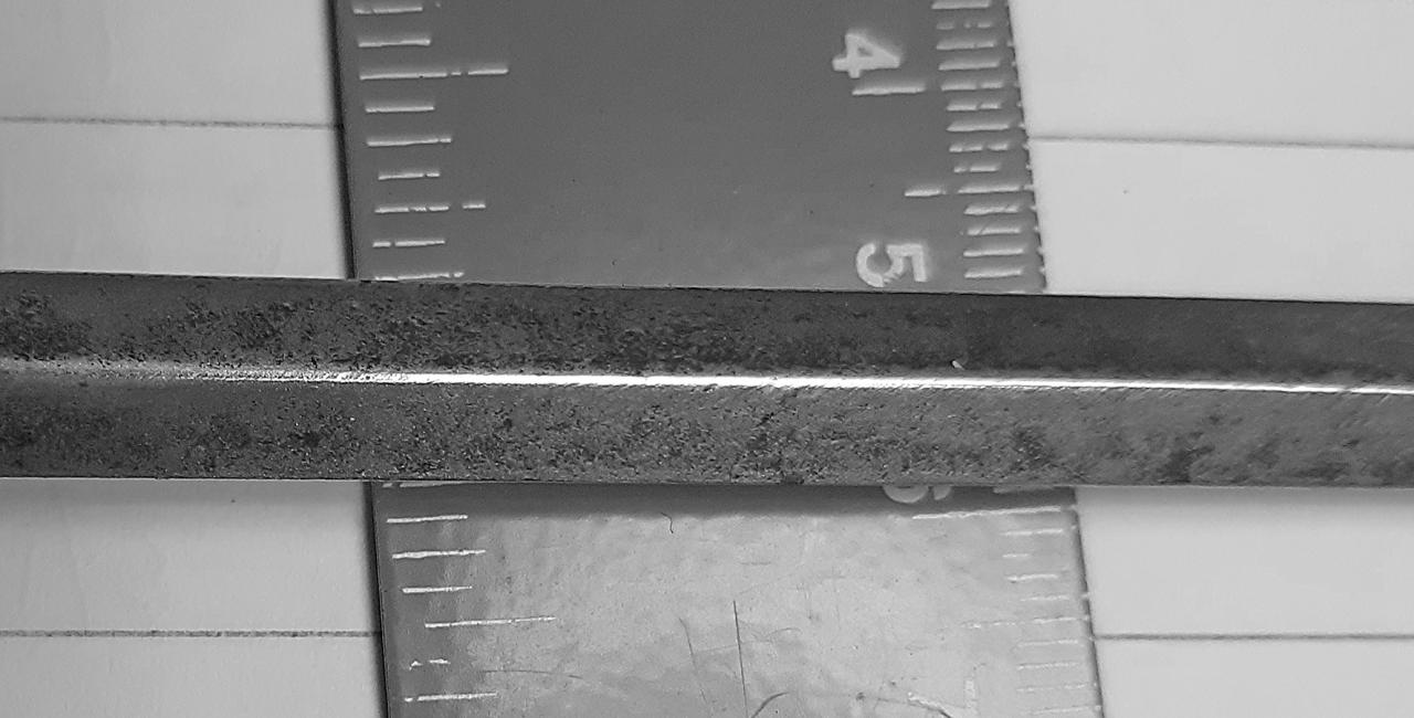

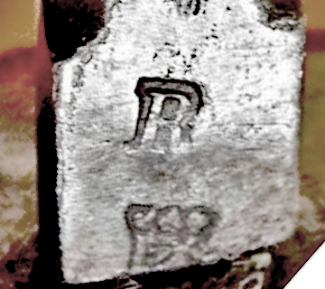

You make a very valid point re. refashioning rapier blades: the Portuguese one above has a flattened diamond profile which is maintained down to the foible; it is perfect throughout its length. It makes me consider if it was not always that length and if so, for what? Were they buying stock, ready to mount in smallswords? Every question has three following up.
The blade is dedicated to the queen of Portugal which is obviously Maria 1st (1777 - 1816) which helps put it in chronological perspective.
You raise a good point regarding the annuletts but that Portuguese sword has typical short 'branches'; that, of course, is the hilt design which looks much later than Queen Maria 1st so it was a re-purposed blade combination.

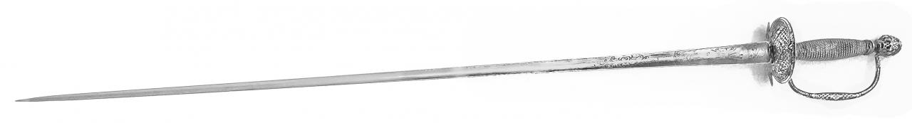

Purely for your interest, I am including my 1767 French officer's sword, of which I am particularly fond. It bears a strong resemblance, in some fashion, to my Shotley Bridge smallswords. A longer blade, but a similar balance in the hand... and very sharp. Let me have an active link so I can see yours; does it feature a cartouche at the ricasso?

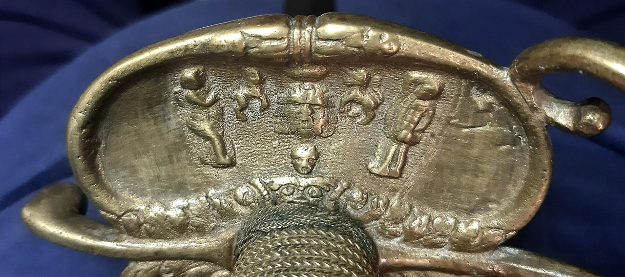

Those two smallswords were forged by Adam Oley in Shotley Bridge in c.1688.
They were hilted by a cutler in (The Side) Newcastle, name of Thomas Carnforth.
It is suspected, but as yet unconfirmed, that the larger of the two was presented to the Duke of Northumberland, George Fitzroy, illegitimate son of Charles II, Commander of the 2nd Troop of Horse, along with a Horseman's sword with a smuggled Solingen blade (see pics) and the motifs of the 2nd troop on the shell.
As I said in my opening assertion: we in the North of Britain were slow to adopt the hollow blade smallsword, and were keen to still have some weight and two cutting edges, even when 'off-duty'.
Soon after, John Holles, Duke of Newcastle, commissioned backswords for his militia: they also were forged by Adam Oley in Shotley Bridge (see pic). They were marked SHOTLEY and BRIDGE on either side of the blade.
Holles was a firm royalist, but James II's insistence on a Catholic country (Holles was a staunch protestant) led Holles to support Danby against the King's supporters at York.
I'm afraid all I get when I go to SBG is a blank screen.

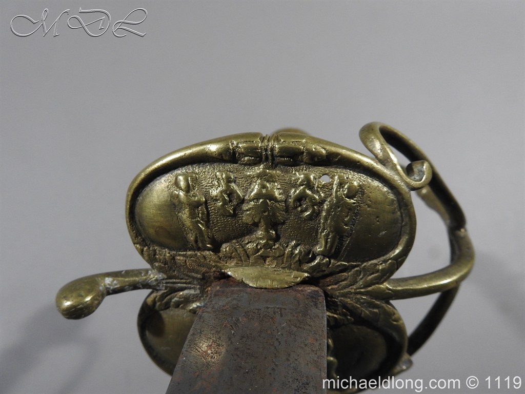

Default correction
Sorry, that was the wrong shell image; here is the correct one.
