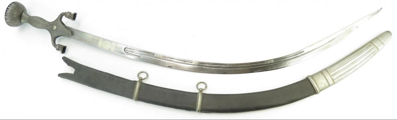

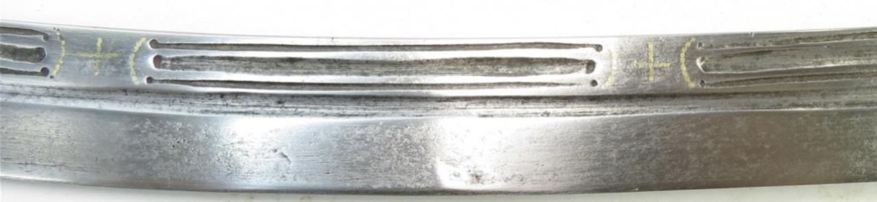

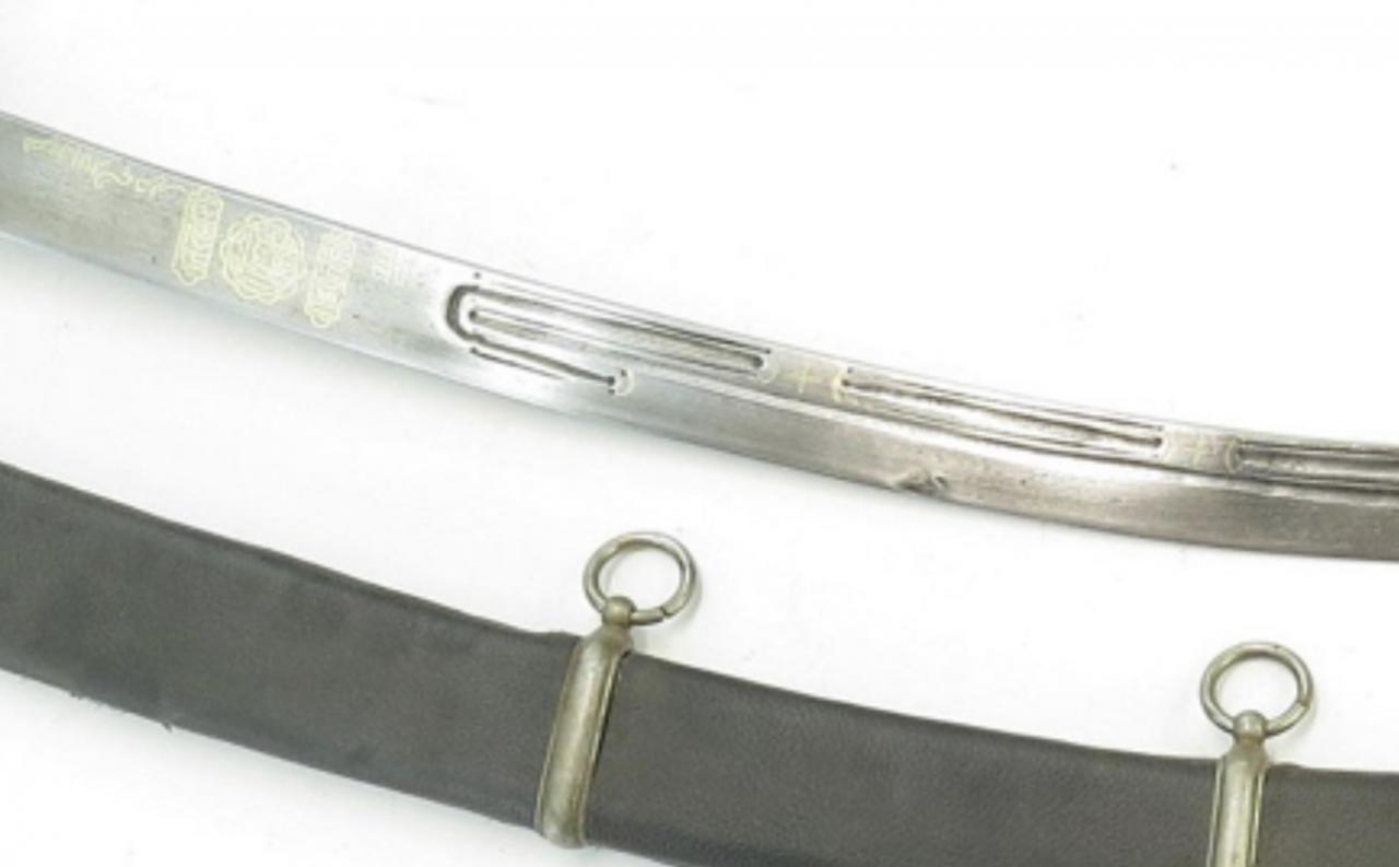

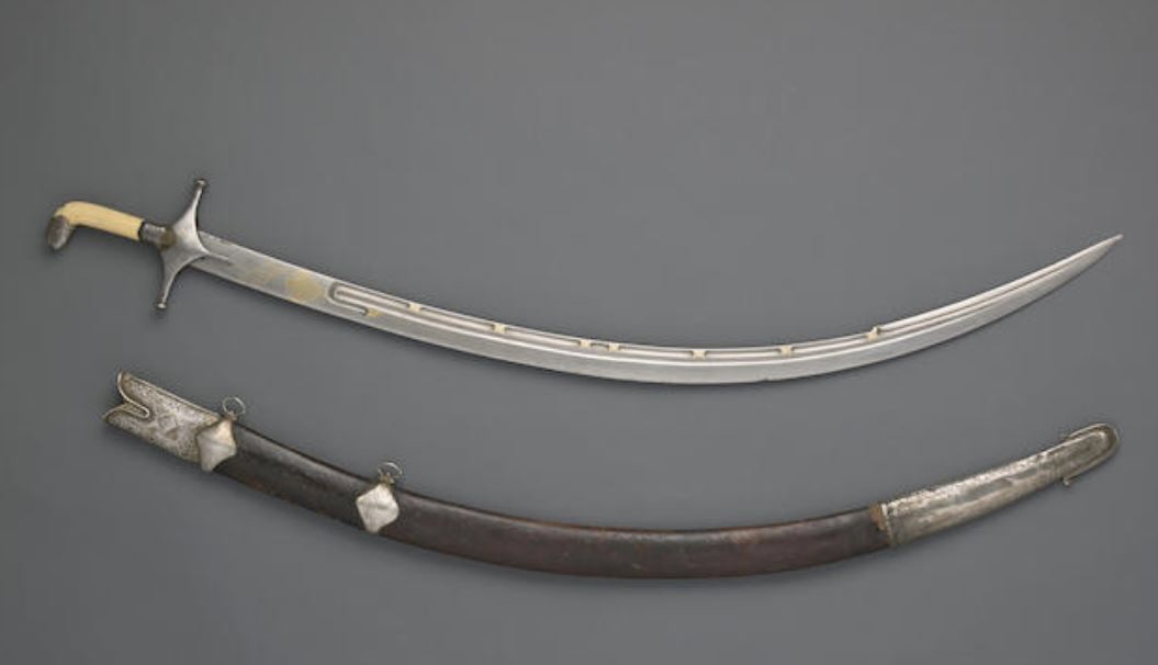

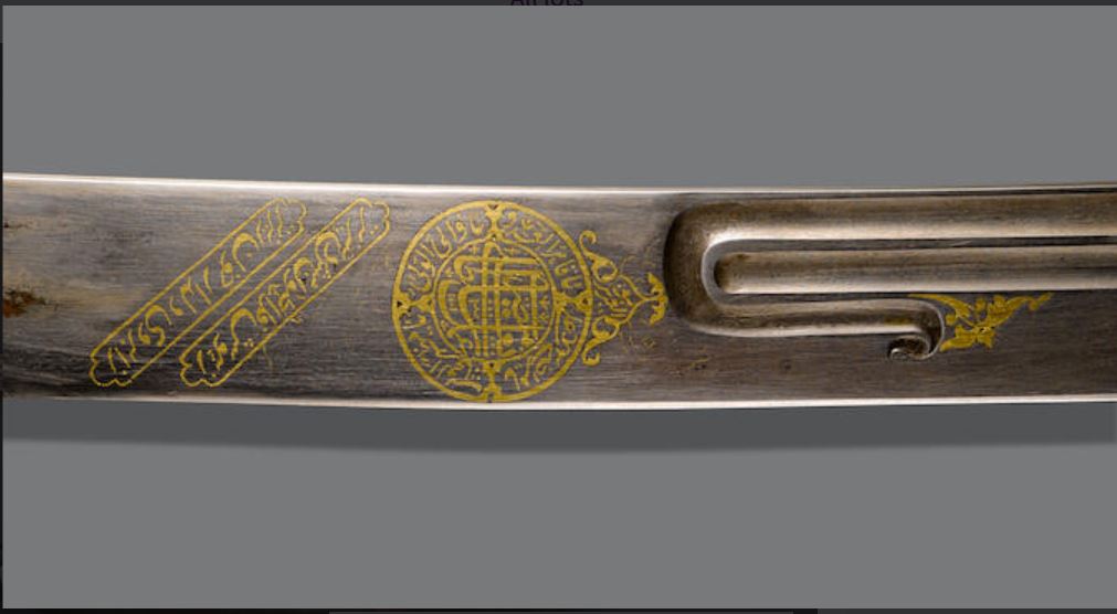

It’s interesting to compare the Persian blades that have the interesting “U-Turn/Segmented” fullering style which was created in Persia, to the examples which was then copied by Afghan and North Indian smiths to varying degrees of accuracy. I wonder if the Persians were inspired by the fullers on German/Italian export blades, because it it certain that the fullers on Indian blades were often inspired by the many European blades imported into India.

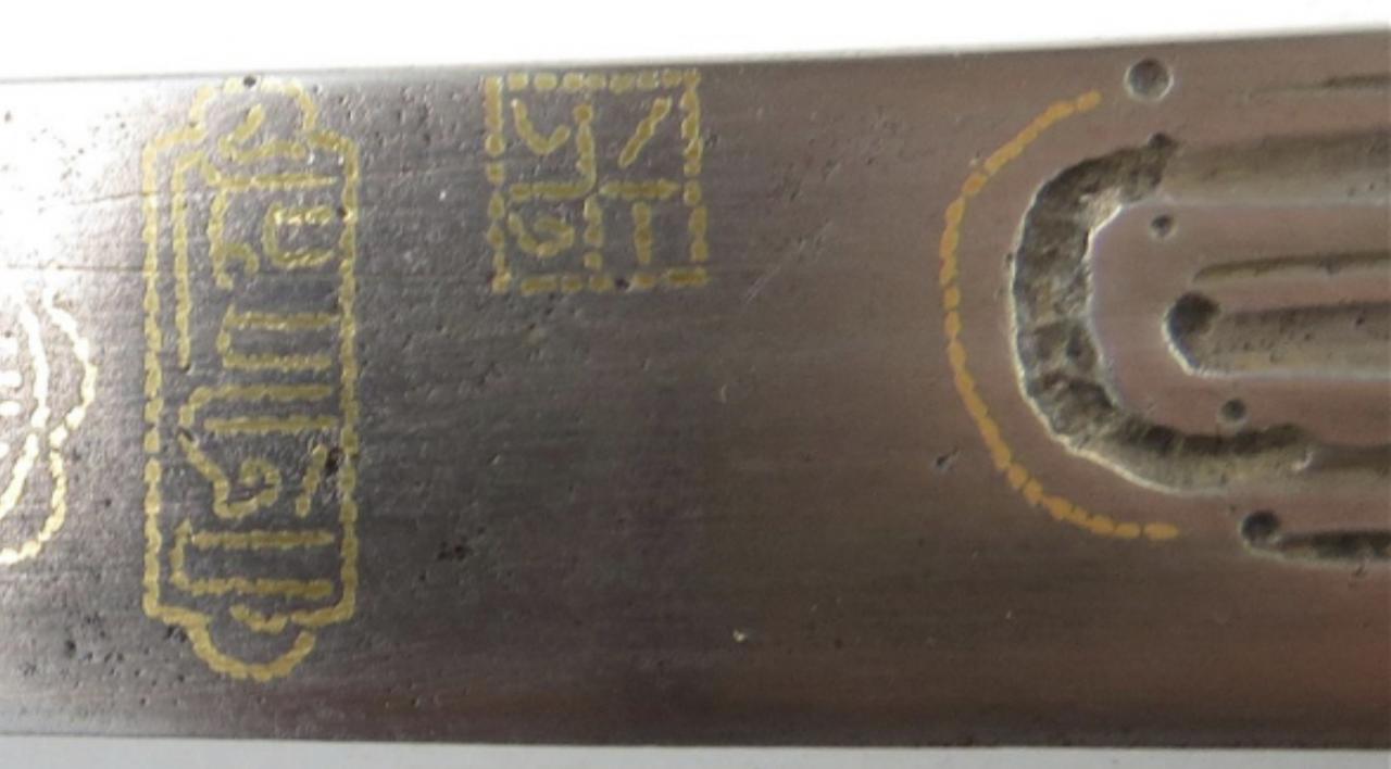

The Afghan copy here imitates a similar Persian blade, however the fullers are much cruder. The Afghan smith likely wasn’t familiar with the exact technique the Persians used to create the fullers, and unlike Persia Afghanistan did not have a massive blade manufacturing industry, it was just individual smiths or small operations making blades for the local population, and this particular smith likely didn’t find it worth the time to spend hours trying to precisely imitate a foreign design like these fullers.

Regarding your blades, I believe the first one is late 19th century North Indian, because of the style of the damascening cartridges, and because of the fullers. Also the fact it is not wootz (apparently) and the configuration of the scabbard with European style chape appear to indicate later production.

Were you able to ascertain whether there was any similarity if the inscriptions between the two swirds?
Insofar as the Afghan example seems to have copied, rather than originated, the fuller design, and with the disparate origins and levels of sophistication between the two, I wonder where/how an Afghan bladesmith might have had access to an example to copy.
