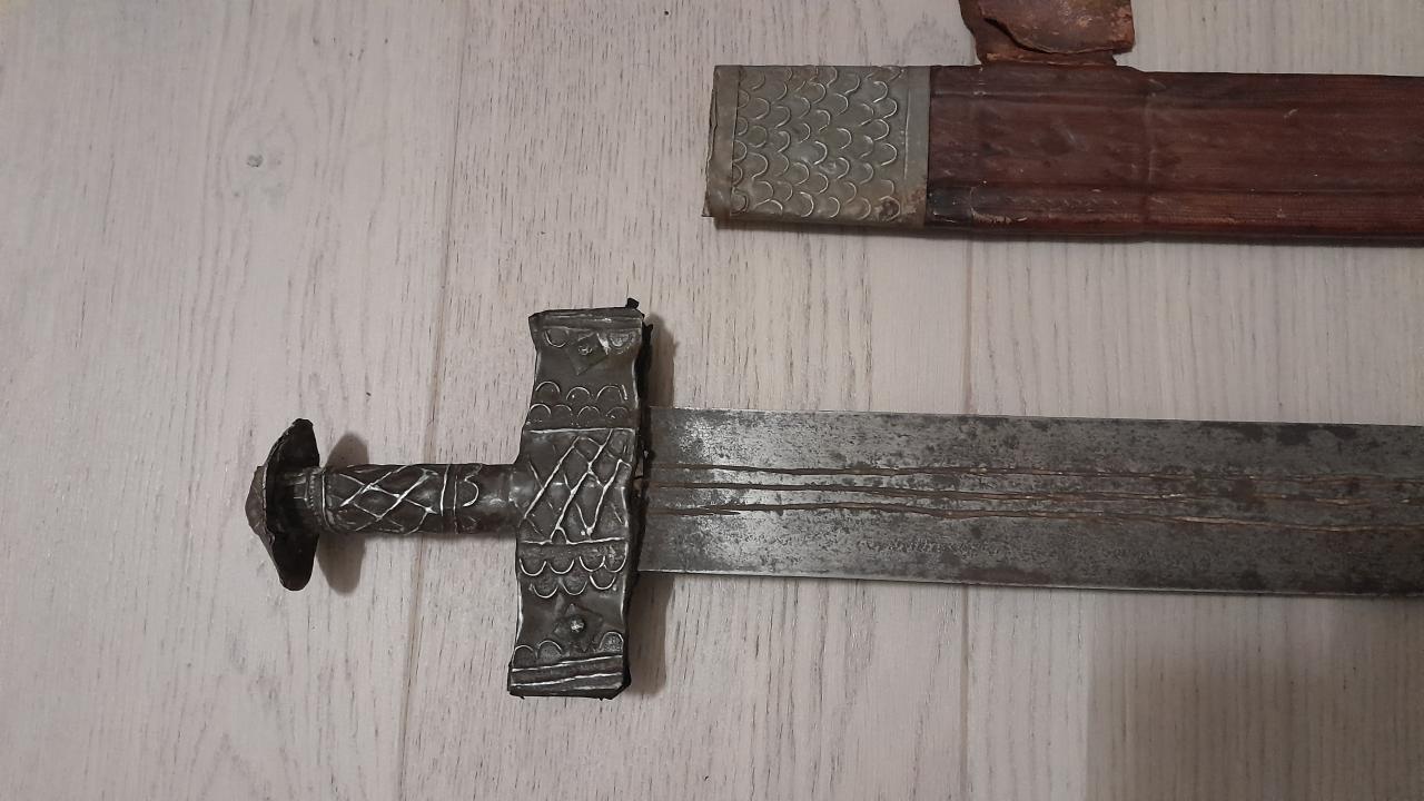

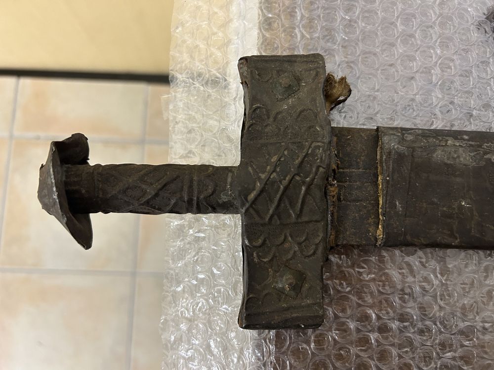

Hello dear members,
I just bought this old takouba sword for few pennies,
Sadly for the moment the blade is completely trapped in the scabbard and the pommel is totally folded / hammered
( thats why it was cheap...)
I first thought the hilt was covered with embosser leather but it is metal, I know that ''southern'' takouba have metal covered hilt, often made of brass.
Good news !!
I wonder first what kind of metal the hilt can be made of ? ( non ferrous/magnet don't work )
Brass oxydation can turn black-dark brown ??
Has someone good clues for clean it and for remove the blade from the leather scabbard ?
I was thinking about a thin and flexible metallic ruler to
introduce step by step in the scabbard ...

Thank you for your message,
I will post pictures of the blade 🤞, first find the thin steel ruler.
For the hilt has someone a ''magical trick'' for remove oxydation without sanding...
Here it is almost black , 19th century item ?
and I wonder if baking soda and a toothbrush can solve the problem...
Marius66 is offline   Reply With Quote

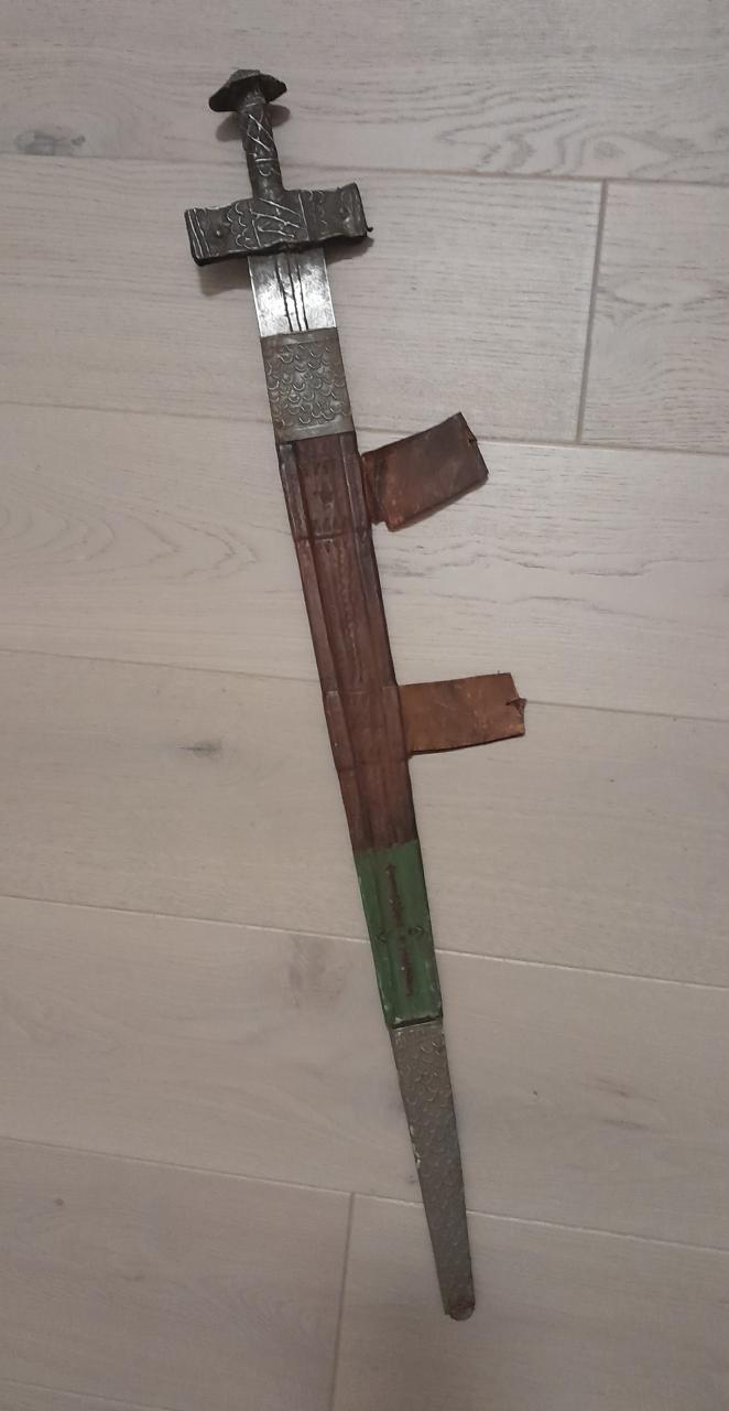

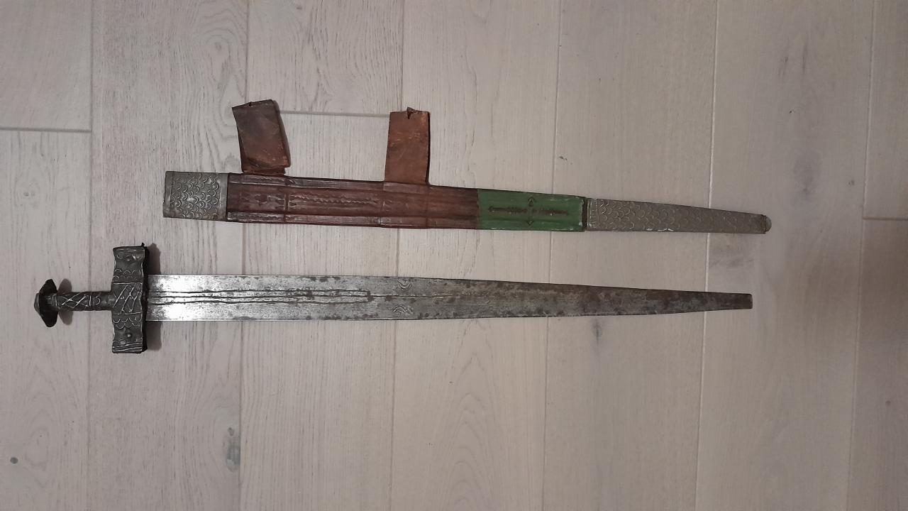

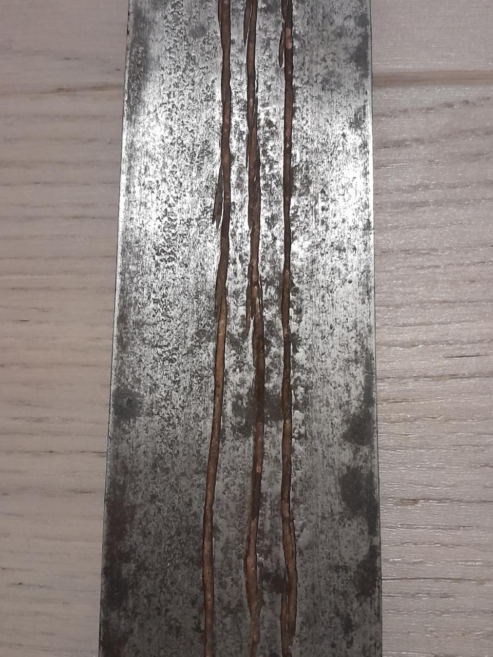

Hello dear members,
I finally got it ! and cleaned it
Sadly not the graal or excalibur, 😐
The blade is unsharped ans local made of poor quality I guess.
It fits to just in the scabbard
that's why it was trapped when all rusty !
I hesitate to sharp the edges so it can fit better in.
A DECORATIVE ITEM , FOR TOURIST EXPORT OR A PARADE. PRESTIGE'' SWORD ?
I DON'T EVEN THINK IT IS NIGERIAN ??

Ps: the hilt is not made with brass ,
Don't know what it is...
Zinc maybe?
Marc

I don't think it is a tourist item. They are worn as part daily dress in some parts.

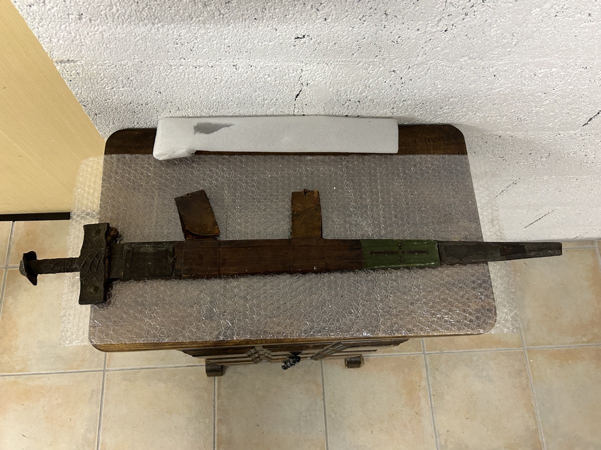

Hello all,
I first placed the metal ruler (without penetrating oil) gradually moving from left to right;
with the leather there was no problem, but it was still stuck at the maximum,
SobI tried to place the sword in the cold for a few hours to contract the metal (winter here) again the ruler about 40cm then I used a small wooden block and a hammer to get everything out by tapping on the brass trim delicately and gradually of course 1-2 mm
Again the ruler then again the wood block and hammer...

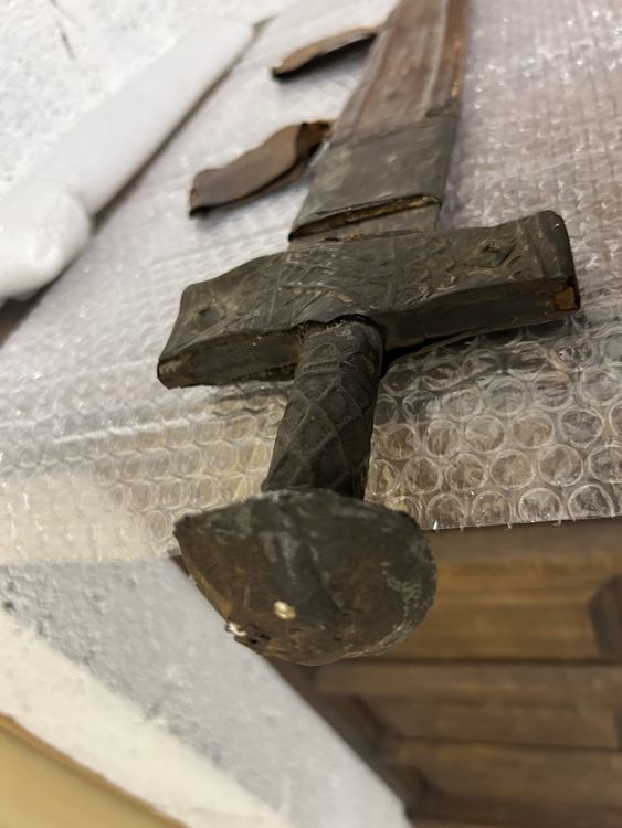

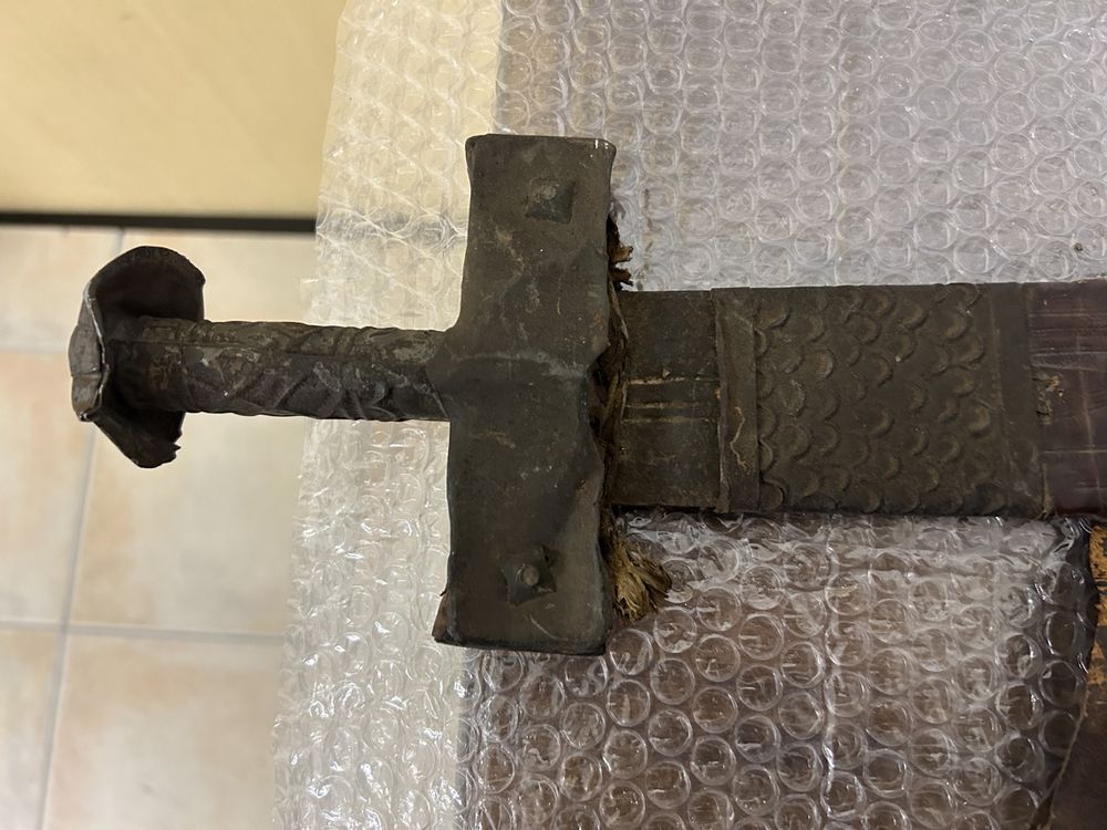

I corrected-adjusted the pommel idem :
hammering on a
small wooden piece that I shaped as a bouterolle and use small rounded pliers
Patience...
Old 17th February 2024, 06:01 PM   #18
Posts: 10,872
Great work on retrieving that old warrior out of its shroud!
While obviously this is not an old weapon (still a venerable age) and it should be noted that with ethnographic weapons, their study is not necessarily of items of any particular antiquity, but of traditional forms still maintained.
Briggs (1965) is a most valuable reference (one I use endlessly it seems) but though mostly it is remarkably reliable, Im not sure if the 'southern' and 'central' classifications are hard and fast.
The takouba is widely used outside its Tuareg associations with other contiguous tribes, and with trans Saharan trade caravans and the typical nomadism of these tribes, there cannot truly be geographic classifications. The predominance of certain features does offer some rule of thumb however.
These swords were significant to tribesmen not only as weapons, but as marks of status and often. worn by chiefs and their officials or retinue.
Typically of course trade blades were used, but there does seem to have been the concept that wider blades signified power/status so many blades were fashioned in this way.
This blade seems likely of sheet steel, with crudely drawn fullers and the 'dukari' (moons) though terribly done. It is doubtful such a clearly one off product would be intended as a 'tourist' souvenir, but created as a 'sword' following tribal tradition to be worn in the sense following those traditions.
Even though not worth a lot collectibly, it is still an intriguing piece of ethnographica, probably from areas around Mali, Burkina Faso, though as noted, northern areas of Nigeria into Niger are also possible.
