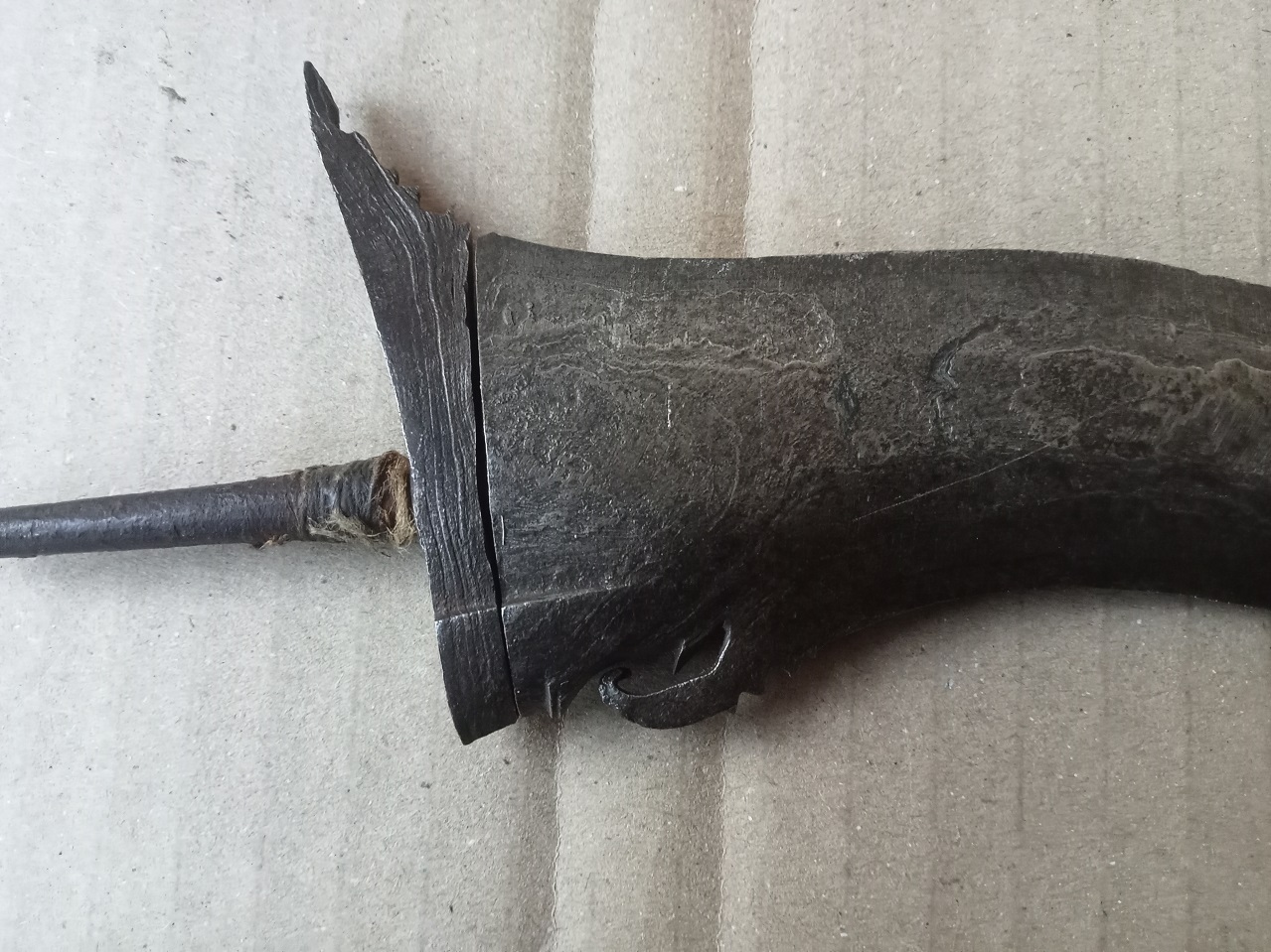

Thank you for this very informative post, answers a question and points me towards a solution to a problem I have.
#14 |
Posts: 7,229
What is the problem David?
I cannot see any real problem in the photo. Yes, there is a gap between the blade body & the gonjo, this is not at all unusual in older keris, and even in recent keris which have not been carefully made. By dismounting the gonjo & refitting it this gap can very probably be reduced, but this is not a job that should be undertaken by somebody who does not possess the necessary skills. In Indonesia, the modern approach is simply to fill the gap with two part epoxy + black artists powder + iron filings. This is not an approach that I approve of or recommend. |
#15 |
Join Date: Jan 2011
Posts: 1,164
The gonjo has actually become loose, separated even. I will not rush into dealing with it, but concentrate on getting the blade dressed for now.
#16 |
Posts: 7,229
David, the gonjo needs to be fixed in place before you try to get dress for the keris.
You're not looking at a big job just to fix it into place, ten, fifteen minutes tops. To demount and refit in order to eliminate the gap, you are looking at serious time & committment. But that gonjo must be tightened up before you think about dress, finding suitable dress could take quite a while, depending on where you are. |
