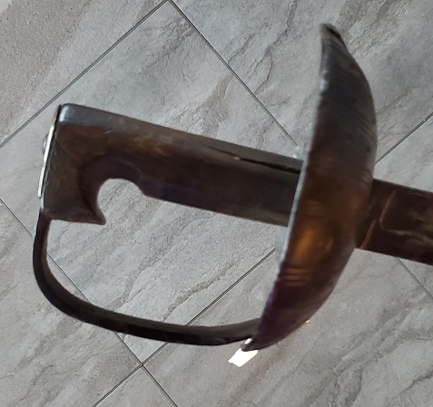

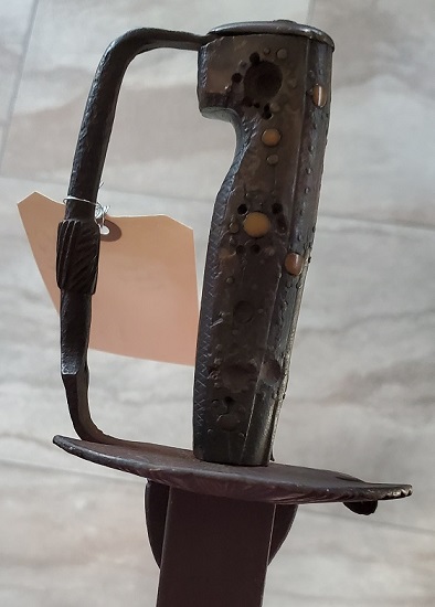

I have two Montagnard dha said to be collected in the Central Highlands between 1967 and 1969 by a US serviceman active in that area.
Are they documented on the forum somewhere? If not, please add pictures!
I haven't gotten around to proper photos yet, so a couple of quick workbench photos will have to do.

Thanks for the info Iain! And thanks for sharing your examples JeffS. Nice that they both retain their scabbards. Makes me wonder what the scabbard on mine would've looked like.
