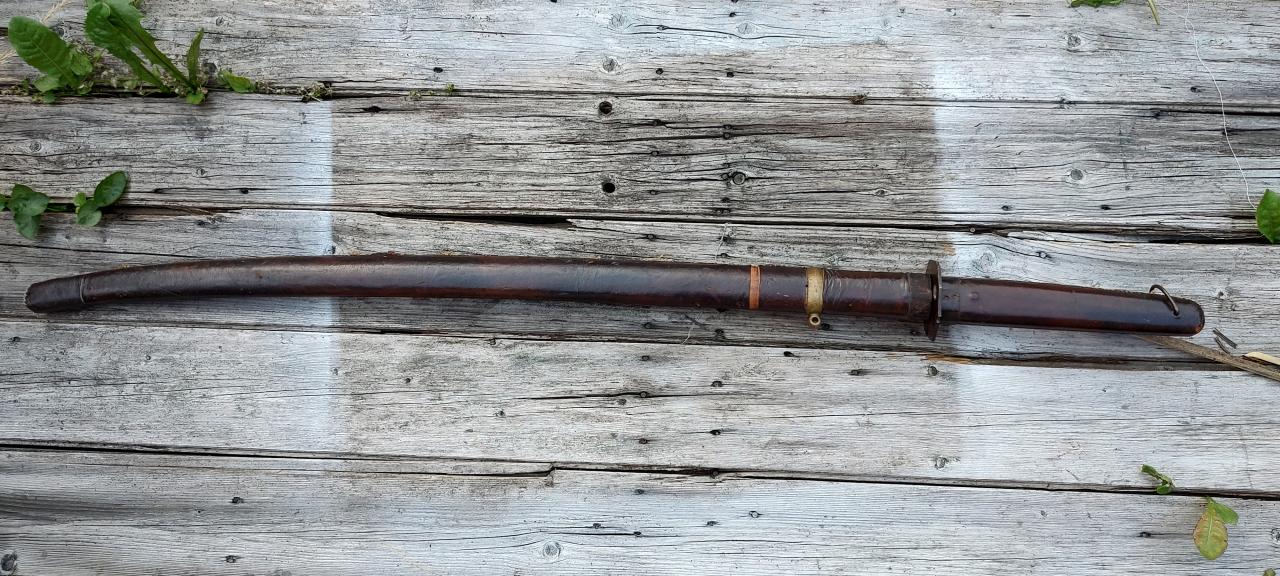

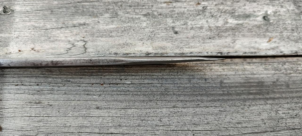

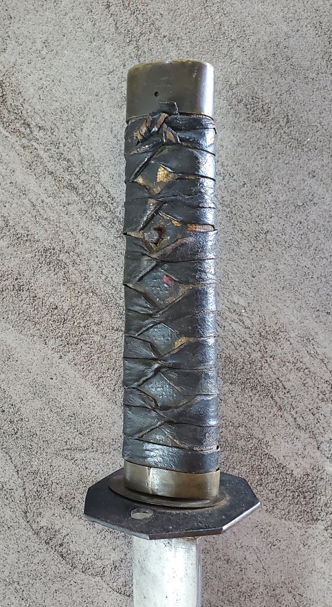

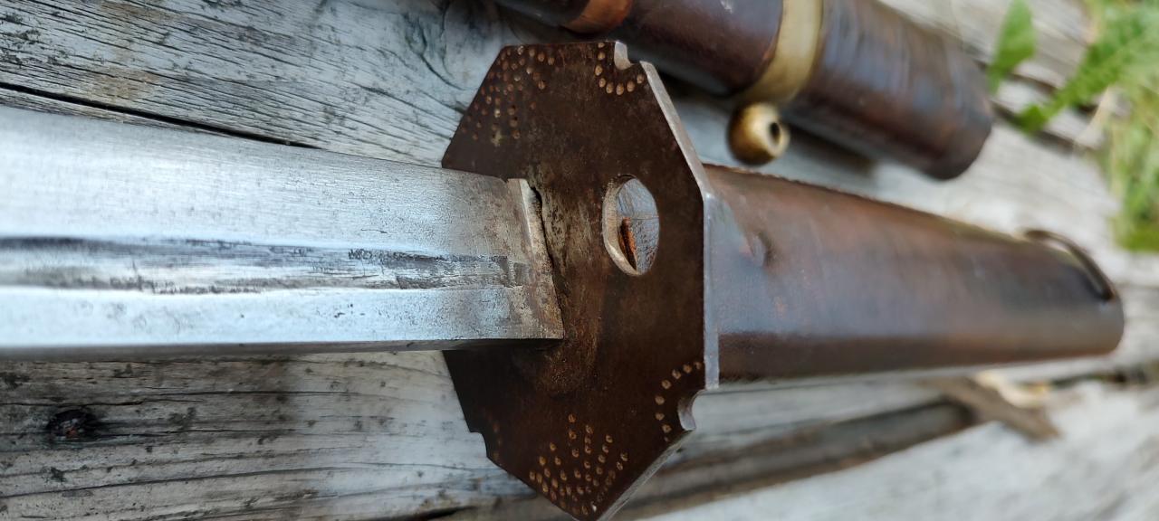

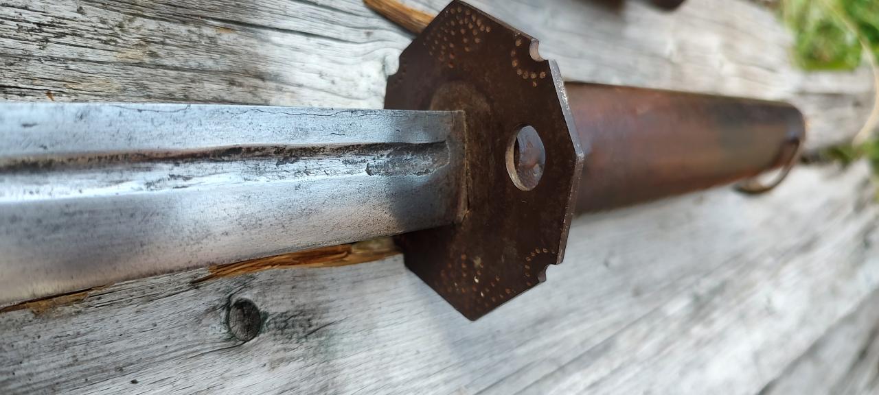

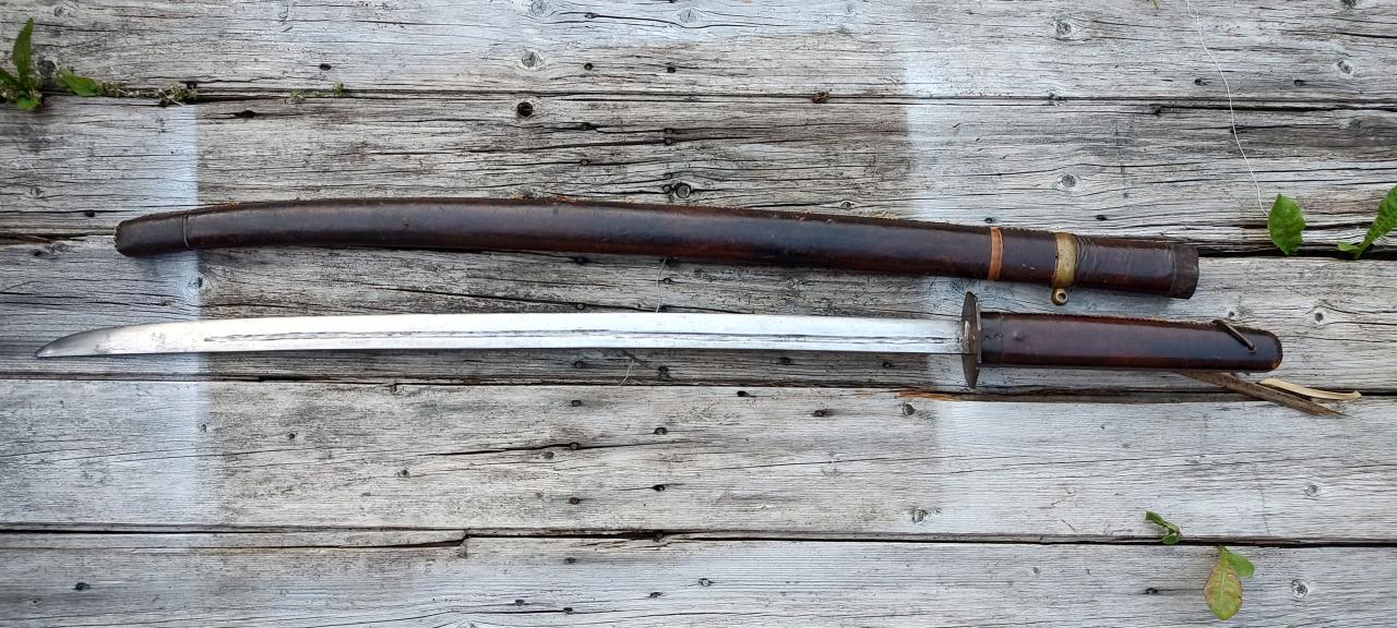

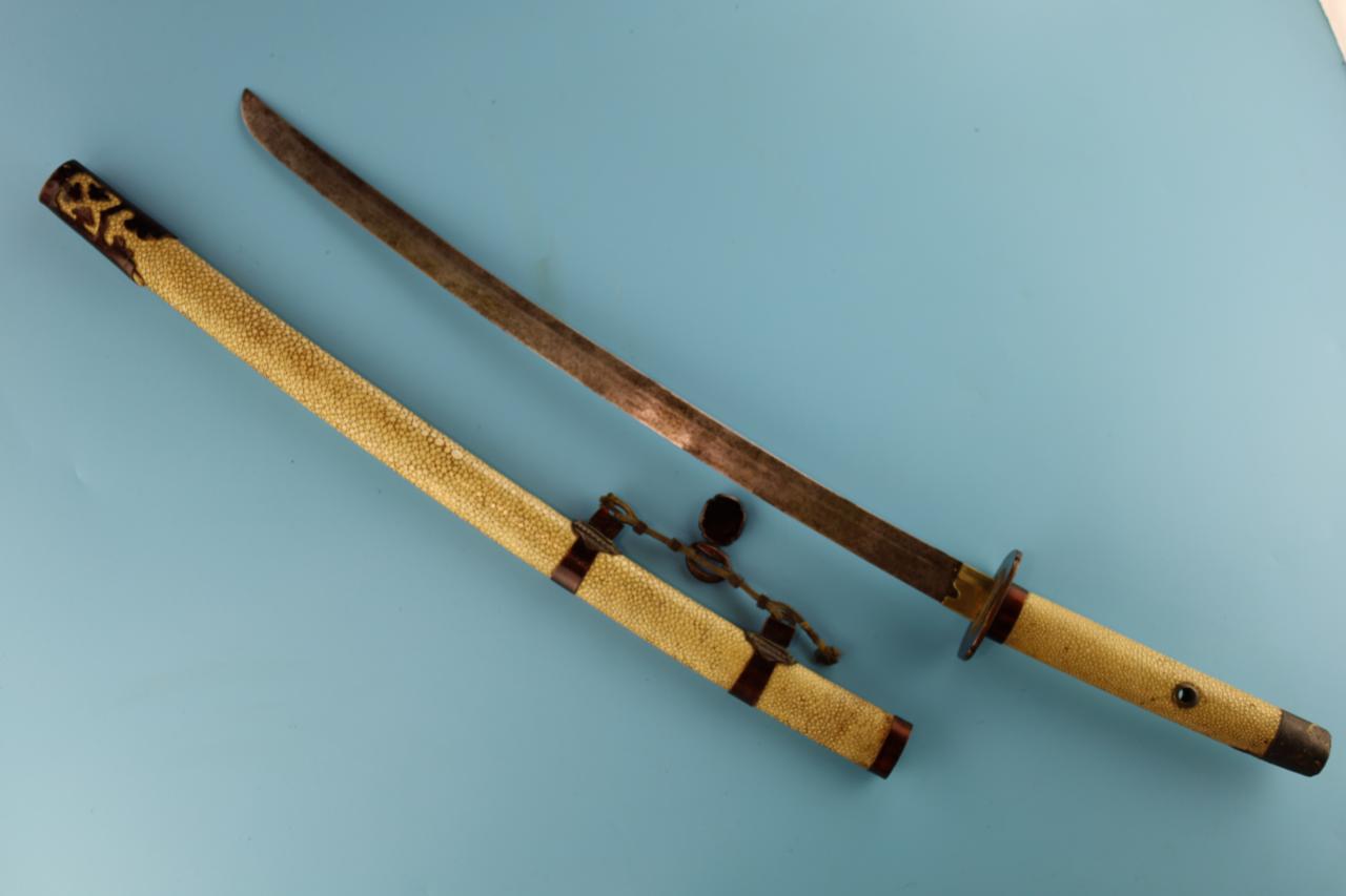

Hello All,
Please see below pictures. Is this a Korean sword? Definitely not a katana.There is little information on Korean sword. Online examples of Korean swords are diverse.

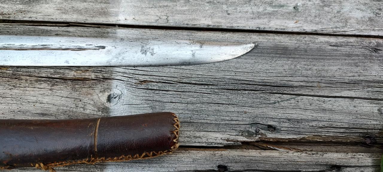

This also unlikely a Vietnamese or another South East Asian Japanese inspired sword. The tip of the sword is a Korean and central asian feature.
I am really tempted to inspect the tang.

Not Korean... looks to be based on a Japanese WWII blade given the pin in the tang showing under the leather hilt wrapping.

The appearance reminds me of a gunto.

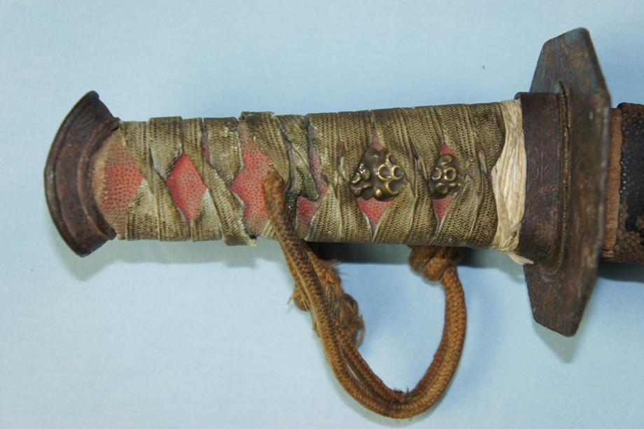

My Korean saber, as per Scott Rodell & Philip Tom, seems quite similar.

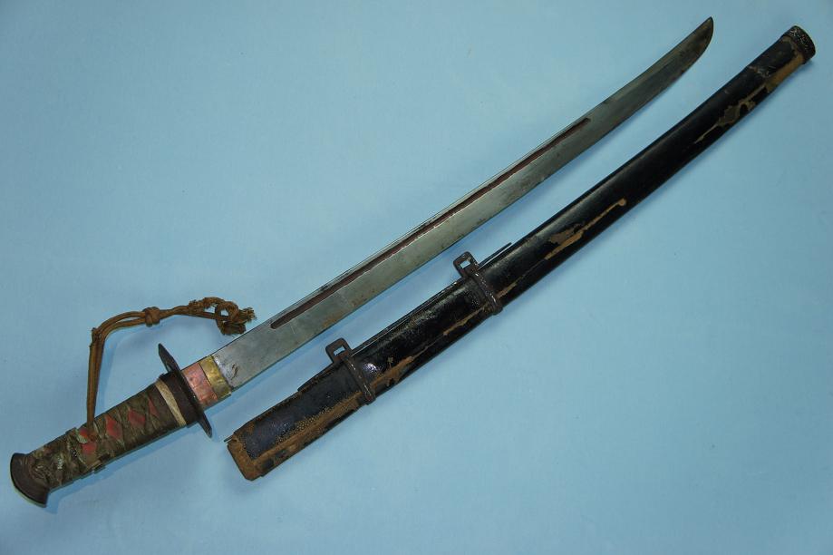

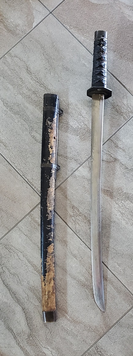

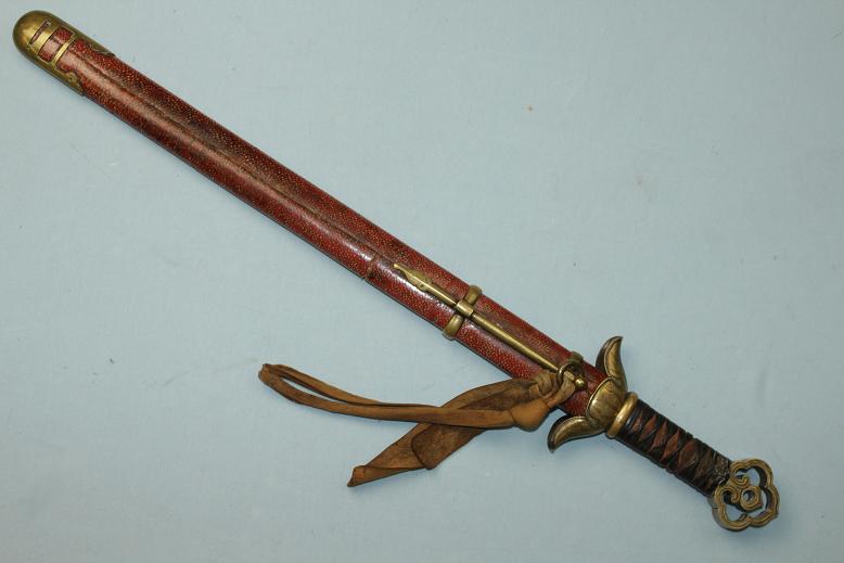

A few of the Korean swords I've sold are seen below. they show some of the variances I note.
The sword you present looks Japanese to me with the images there are to work from, in appearances, style and aspects like the pin and the leather coverings.

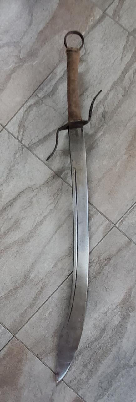

Maybe the knife was a wrong example. The other link has Korean swords With pins too.
Jim also posted a lovely example with a pin. This saber is also Japanese in appearance. However, it's absolutely not Japanese or Japanese influenced.
Your example looks more Chinese in appearance, but this does not mean it's Chinese or Chinese influenced.

Copycat, thank you so much for recognizing my post and the kind words on my Korean saber. As I mentioned this was confirmed Korean when I got it from Scott Rodell over 20 years ago, and Philip Tom agreed. I consider these guys to be the highest authorities on the swords of China, Korea,and Asia,in the 30+ years I have known them.
There is a certain and notable friction between the Japanese and Koreans, however the influences of Japan (and clearly China) cannot be disputed in the Korean weapon forms. I recall meeting a Japanese gentleman once who was traveling the US to purchase and repatriate Japanese swords taken as souvenirs in WWII. This is a prevalent circumstance in Japan with the families who are charged with the identification and preservation of the famed swords of the Samurai.
In talking with him (through interpreter) he showed me the astounding examples he had acquired that day, some over 600 years old, and looking almost new in some cases.
I showed him a photo of my Korean sword, but his face almost twisted as he looked away and handed the picture back disdainfully. The mood and character of the meeting quickly changed, the interpreter said, 'he has no idea what THIS is', and the exchange ended.
As I understand the Japanese destroyed countless numbers of Korean swords during the occupation in WWII. This is apparently the reason for the rarity of examples. When I was beginning my search for a Korean sword nearly 40 years ago, there was virtually zero information on them in the west.
Japanese sword influences traveled widely through the Orient, as often did the blades. Even the Ainu people known in Siberian regions into the northern Japanese islands used Japanese blades in their edged weapons. I have discovered even examples of Japanese katana in Indian regions in the east, and of course they existed through SE Asian countries.
The same conundrums in specifying whether a sword is from one provenance or another when these influences are present presents difficulty, but that distinctive hole in the 'tsuba' (?) seems characteristic in Korean examples as does the octagonal shape.

Indeed, there are Korean swords with pins, I also shared one in within the three images to add further context.
Jim's sword does have a pin. It is not at all Japanese in appearance though, that is evidenced when considering its dimensions, fittings, relevance of blade type to the period of the sword itself, the differences in grip wrapping, the scabbard suspension.
You reference my example being Chinese in appearance... are you referring to one or all three of them?

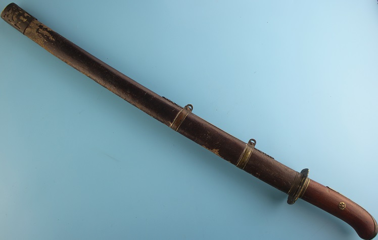

Below is another I sold many years ago, it is a rather standard arsenal type of which I've seen dozens over the years. It is with a peened tang and lanyard hole. No hole in the guard. I think the hole is a feature in the swords of rank and the guard becomes more decorative as the ranks go higher.
Although I have not handled Jim's sword, I suspect from the images that is likely an NCO or low-ranking officer's sword, potentially one helping with or presiding over such an arsenal that the below sword came from. I do not say this with absolute certainty, simply what I feel when I look at defining characteristics and the little I have learnt about the rank system.

The overall design of the first one looks like a tachi actually. However, he fishskin on the scabbard, the fittings and the hole in de hilt are similar to Chinese swords.
The overall design of the others are similar to a dao and jian.
Point is, the details or the combination of details makes it different.

Back to your sword though, and with consideration to the complexities of details that you are aware of, what specifically leads you to think/feel that it maybe a Korean sword?
Old 15th July 2023, 10:37 AM   #13
Copycat
Join Date: Apr 2023
Posts: 42
Hello Gavin,
Yes. back to my sword. Please excuse for my use of terms.
The details which suggests Korean origin:

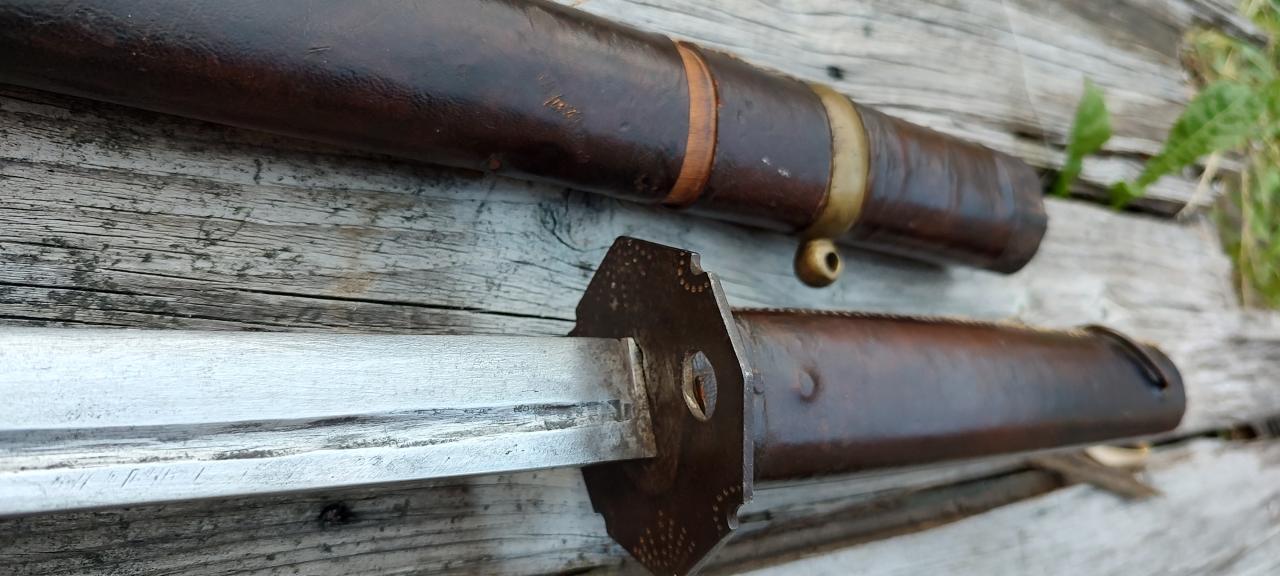

- the guard / tsuba
- almos double edged tip / false edge/ yelman

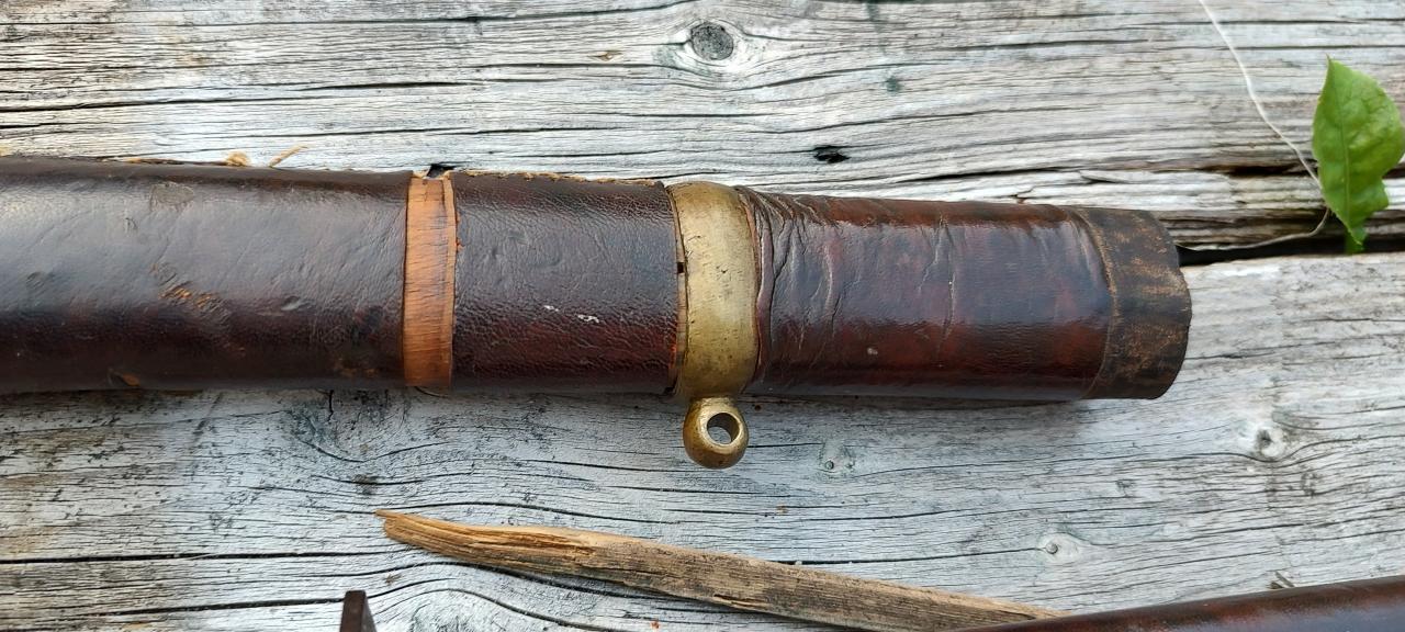

- two hangers on the scabbard. I think it is missing one.
More ambiguous details:
- crude lamination. I also can't see Harmon nor traces of San mai.
- really crude fuller. Not crisp.
- no fittings like habaki and seppu
- all leather wrappings
Thank you for your interesting posts and pictures by the way.

One key element I have noticed is the 'tsuba' ( noting the variance of term for these guards on Japanese and Chinese swords with varying terms)...in the case of my example and Copycat's with the rounded aperture in the guard. This seems a feature which in my limited exposure to Korean swords, seems to be characteristically Korean?
Also the octagonal guard shape, again seems common to Korean swords.
Can anyone say more on these distinct holes in the guard? what is it for? It seems I have seen similar on a Japanese tsuba, but more of an anomaly.

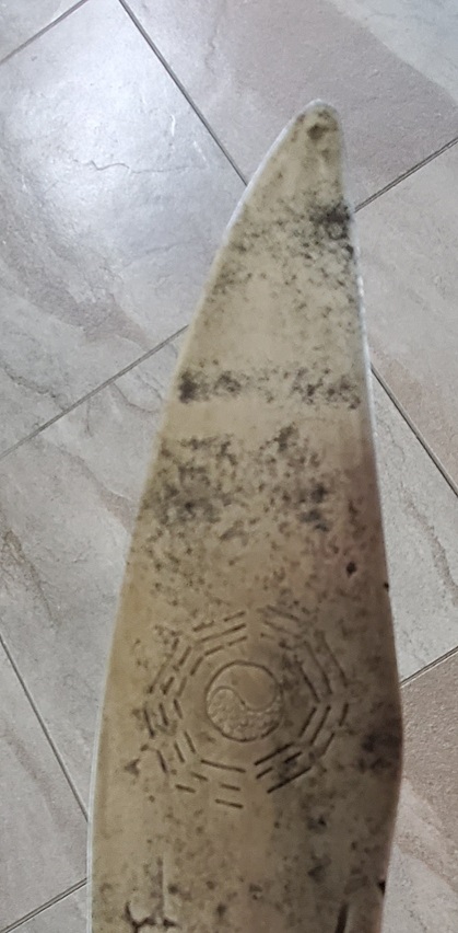

That was what I was suggesting regarding the Eight Trigrams symbol, as seen on this Ba Gwa dadao with this symbol.As China was occupying Korea in years 1910-1945 this seems to carry out the connection, though this dao is of course far earlier, probably to that rebellion in 1814 (Rodell).
