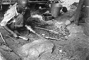

I've been trying to obtain information about the techniques of blade/sword smithing in Africa....but have discovered little. Limited resources in some areas, such as fuel for the forge, suggests that perhaps shortcuts were taken in the forging process. Spring states that the African blacksmiths had a very good knowledge of metalwork and forging. I found these black and white photos which are of interest.
The cultural customs and beliefs that surround African blacksmiths are also very interesting....many were segregated from the main tribes as 'unclean' and often feared for the 'powers' they possess.
Has anyone any information they would like to add ...or any book references they know about..........thankyou

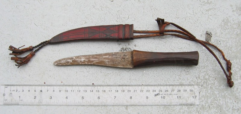

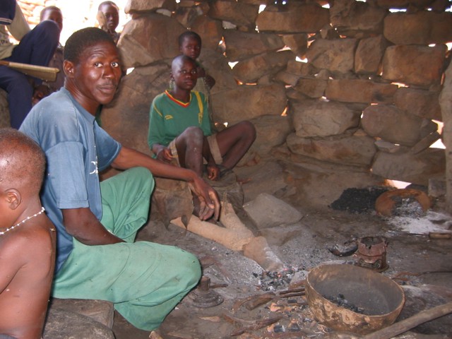

Here is a picture of a Dogon blacksmith in Mali (2005). I found him in a tiny village near a great cliff. The other picture is a knife bought to him (but clearly not new !).
The working boy is his son. His father learned his art from his own father. The young fellow is activating a typical forge made of two "drums", a "Y" pipe and a charcoal fire.
The Dogon are no longer using their own iron ore found by mining : they buy it in town from time to time.
The village's blacksmith is mainly forging utilitarian things, but occasionaly traditional knifes. The Dogons are not a warlike people, so swords are not made by those workers.
