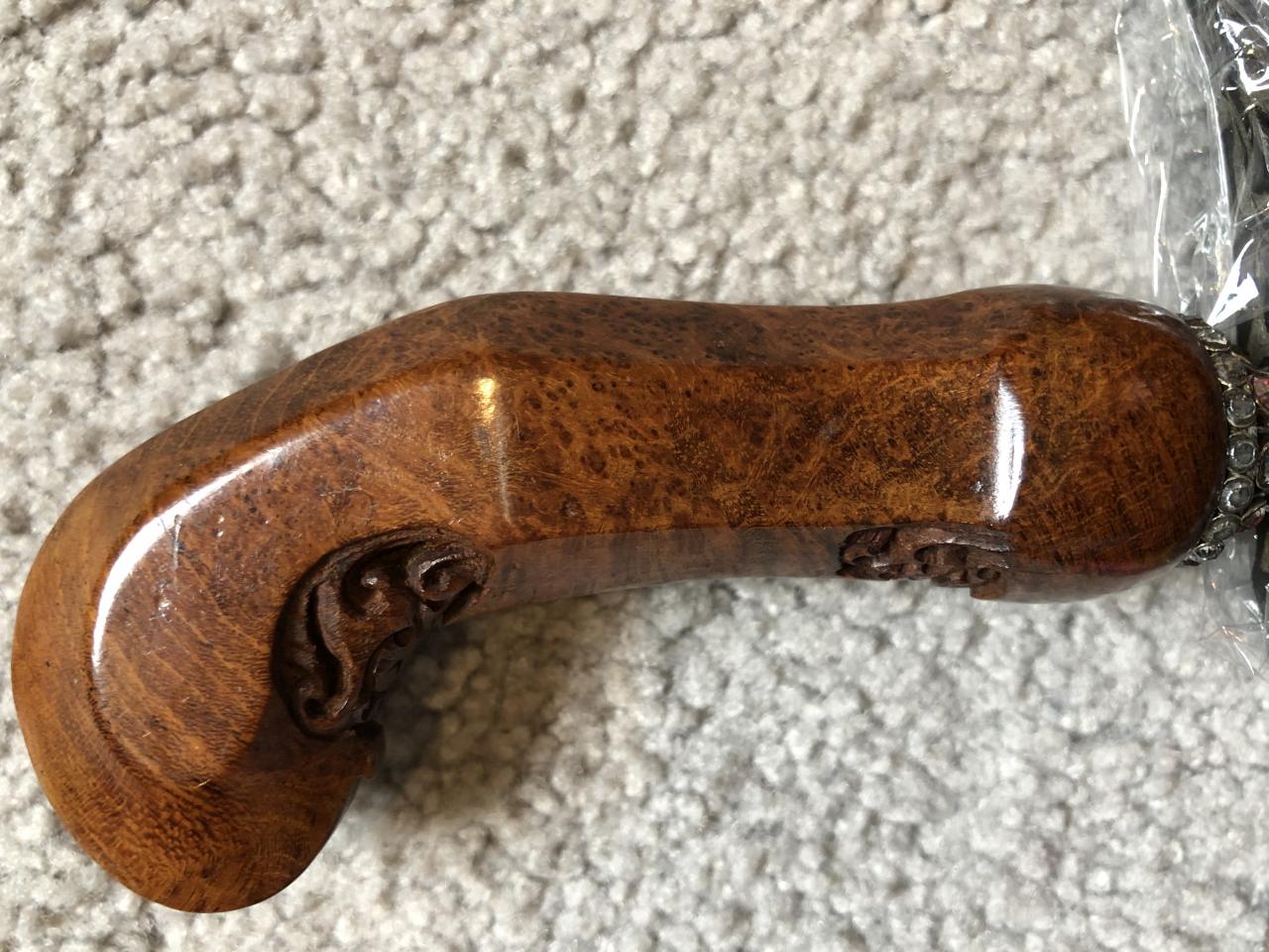

Anybody knows the type of the wood for the atasan?

Jati gembol, jejeran also.
Thank you Alan.
In English is it called burl teak?

Posts: 7,230
Yes, that's correct.
Has that jejeran been cut to give us a kendit?
I don’t know Alan, I acquired it as is.
I don’t see any kendit:

Neither do I now, it was just the light.
