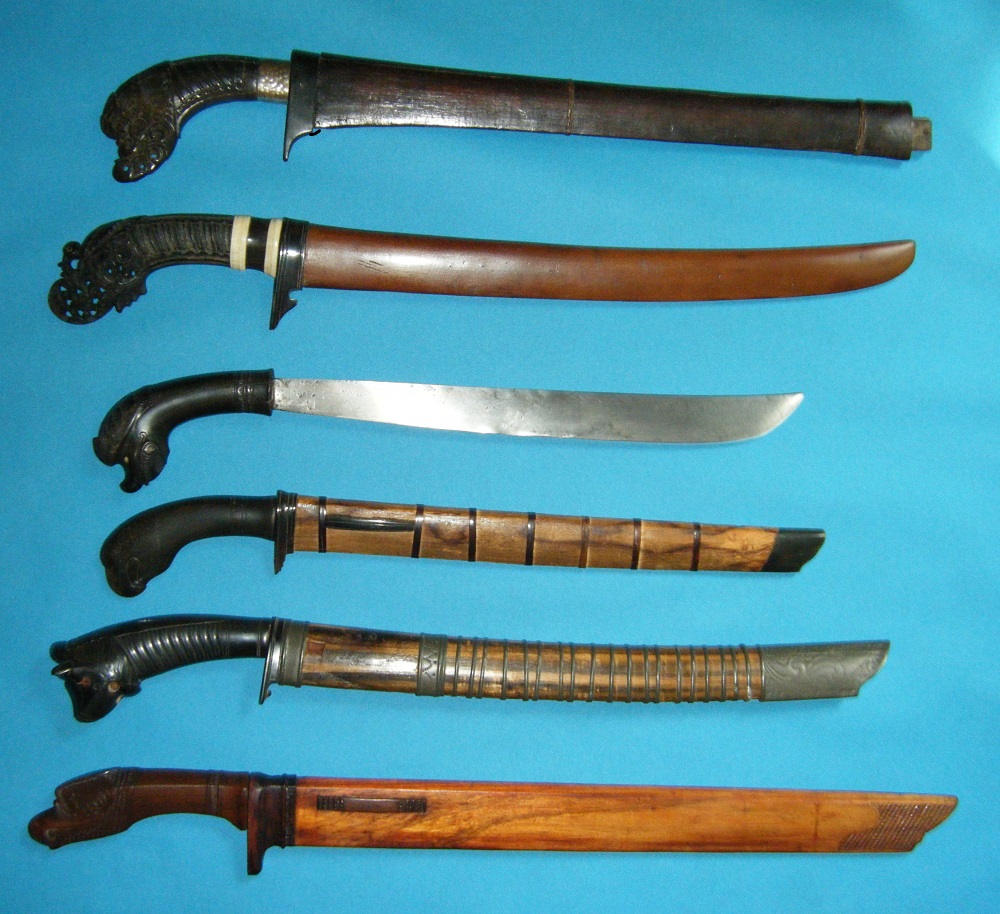

Hello dear members,
I have assembled some Sunda golok in the last few years, in the past they don't have been from great interest for me.
I have to state that this are very well worked blades and I doubt that only one of the shown examples are worked for those who travel.
I will show them piece by piece with a short description.
Sajen is online now   Reply With Quote
Old 10th May 2020, 01:32 PM   #2
The possible oldest example in the collection, I would guess last quarter of the 19th century. Laminated blade, handle horn, carved as stylized makara, pierced through carved, low grade silver or mamas ferrule, scabbard two wooden slabs, two fine wooven rotan bands still present, scabbard mouth horn, foot (possible form from gobang scabbards) is missing.
58,5 cm inside scabbard, 55,8cm without, blade 42,5 cm, 9 mm thick at the base.
Old 10th May 2020, 01:47 PM   #3
Second example I would place to the first quarter of the 20th century, very well worked example in all parts. Laminated blade razor sharp after I've polished out surface rust, handle horn with bone spacers, very fine and pierced through carved, shows as well a stylized makara, note the lying bird in up!, scabbard wood from two glued parts, scabbard mouth horn.
60,5 cm inside scabbard, 58 cm without, blade 41,5 cm and 7 mm thick at the base.
Old 10th May 2020, 01:58 PM   #4
An example without scabbard, a piece which has seen extreme use, I would place it also at the first quarter of the 20th century, not sure about the blade but think it's laminated, very nice carved horn handle show makara. Bone inlayed eyes.
49,5 cm, blade 37 cm and 5 mm thick at base.
Old 10th May 2020, 02:10 PM   #5
An example wich I would place to the second quarter of the 20th century. The surprisingly very well worked blade seems laminated, handle horn, simple carved as parrot head, wooden scabbard halfs hold from horn mouth piece and foot, horn bands around and a belt loop also from horn.
50 cm inside scabbard, 46 cm without, blade 33,5 cm and 8,5 mm thick at base.
Old 10th May 2020, 02:21 PM   #6
An example either from second or third quarter of the 20th century, well worked but rough finished blade, unsure about the material, marked, note the spanish notch, handle from horn show a makara form, inlaid eyes, wooden scabbard halfs hold from several metal bands and foot, scabbard mouth from horn.
57 cm inside scabbard, 56,5 cm without, blade 42 cm and 6,5 mm thick at the base.
Old 10th May 2020, 02:39 PM   #7
An example in the style which is most desired, easy to date, it's from 1909, handle and scabbard from wood, handle some form of makara, very well worked blade.
63 cm inside scabbard, 55 cm without, blade 40 cm and 8,5 mm thick at the base.
Old 10th May 2020, 02:41 PM   #8
Overview!
