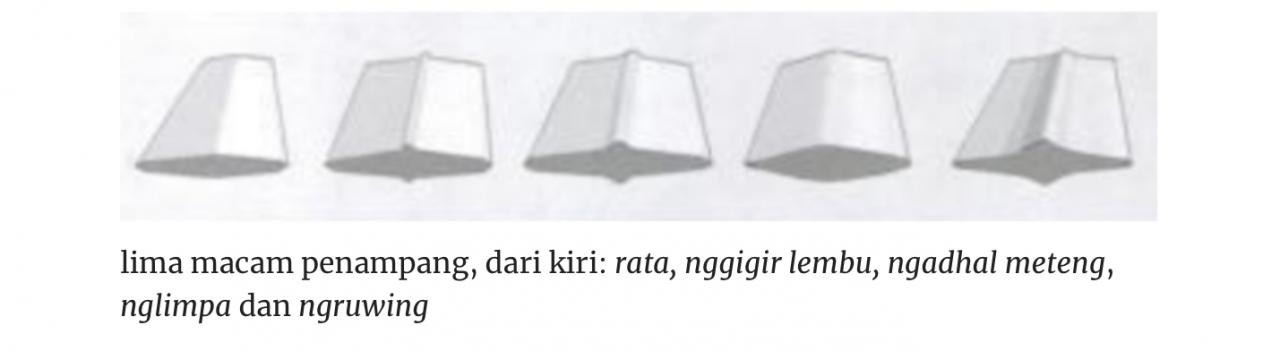

Since the only links (which i deleted because they were commercial links) that you posted were from dealer sites, that could tell us about the origins of the term under discussion, so it was not necessarily a poor assumption on the JustYS's part? But the term does pop up in some non-commercial sites so it is probably something that has some more legitimate usage. Of course this tells us absolutely nothing about when in might have first appeared in the general keris lexicon. I, myself, am not a linguist and know very little about the Javanese language (we can assume that any terminology applied to keris that is Bahasa Indonesian is not in fact old. When this post first appeared i googled the term and did not find anything that could really answer JustYS's question. My online translators translated the term to mean "Denial of Pregnancy", but these online translators are notoriously bad at transcribing these languages into English. So i had hoped someone like Alan Maisey might come along with some information as he has a much better grasp on the language than i do.
I did find one source that gave the following description.
Ngadal Meteng: Ada-ada tonjolan besar, gemuk, dan tidak menonjol.
Again, bad google translator makes that "There are large, fat, and inconspicuous bulges." Though it translated Ada-ada as "there are" when i am sure that was indended to mean the ricikan of "ada-ada" which we probably all know by now as the central raised ridge of a keris blade.

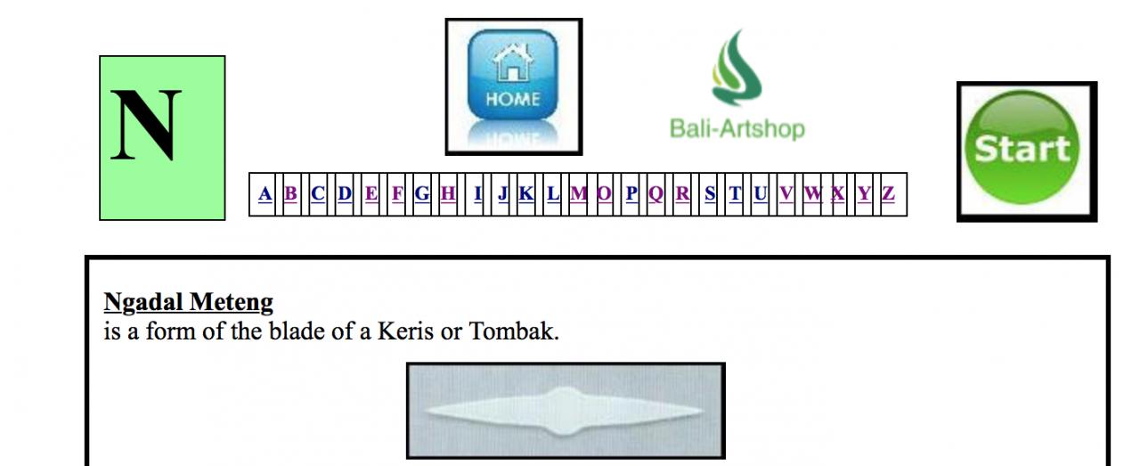

I also found a brief definition and a diagram in an online Keris Lexicon. This seems to imply that JustYS had the wrong impression of the meaning of this term and that it refers to the cross-section of the blade, not the shape of the length of the blade. This is another page that also implies the term is in reference to cross-section of the blade.
https://bambangkhusenalmarie-wordpre...n&_x_tr_pto=sc (scroll to the bottom of this page)

Our most senior and knowledgeable members here will tell you that they encounter terms that were not used or known to their teachers and other keris-literate people (the most literate, even) in their time of learning. The fact that some sellers use it nowadays might not mean much at all.
Anyway, we've established that ngadal meteng refers to a particular blade cross-sectional shape, one that is similar to closed curly brackets {}. It was not that difficult for me to find this on Google.
I doubt that it has an originally intended meaning or significance behind it. Given that we are talking about the keris I'm sure someone has come up with a meaning for it. And if enough people believe in that meaning then it is true. Retroactive continuity. I haven't encountered any of these meanings myself.

Thank you David for the link and also clarifying that it refers to cross section.
I did not know that there are so many different cross sections.
Regarding the intended meaning and significance behind it, I’m not sure jagabuwana, but if you click the link from David you’ll see that the terms is used in Serat Centhini although using different words: ngadhal busung.

I did not previously comment, largely for two reasons, firstly I cannot recall having heard the term used in reference to a weapon blade, and secondly because it is listed in alpha order in EK.
Briefly, the EK entry just says that if the face of a blade of a keris or tombak is domed & looks like the back of a pregnant lizard (a small lizard, grass lizard, "kadal") then it is referred to as "ngadal meteng".
This can also be spelt as "ngadhal meteng".
As above, I did not know it as a keris or tombak term, however, I did and do know the word "ngadhalmeteng" (ie, one word, not two) in general usage as referring to something/anything as being big/swollen in the middle. My understanding is that this is Javanese but also occurs in BI.
It is not the name of a dhapur, & if used it should only be used as a descriptor of the blade face, not the full blade.
