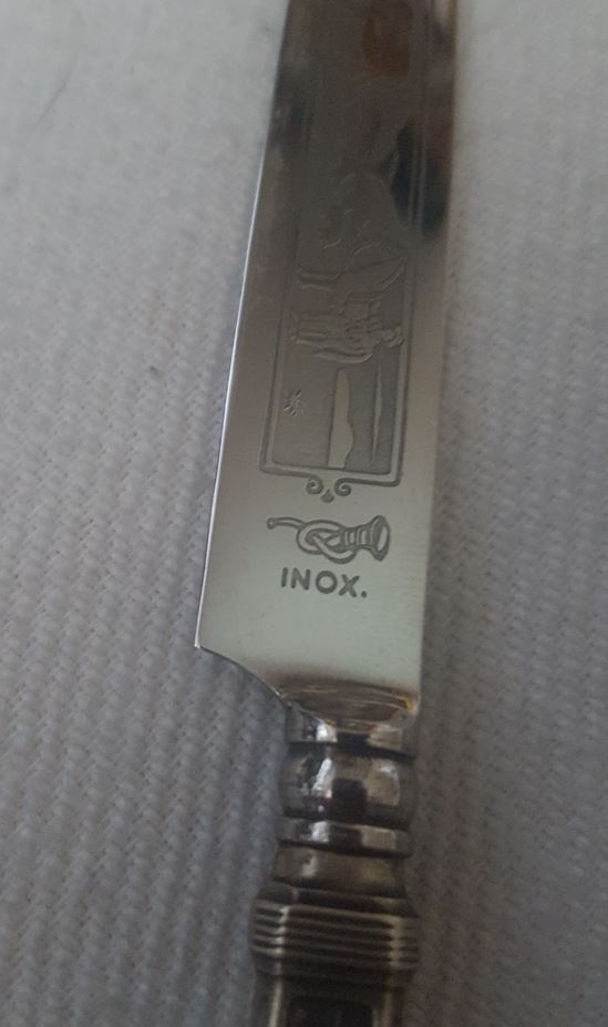

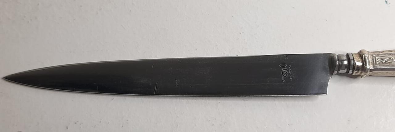

I just managed to buy a facón from Uruguay from a seller in South America. See enclosed pics . Details:
Cuchillo de acero inoxidable hoja Trompeta con mango y vaina de metal blanco
Cuchillo con botón Uruguayo vaina trabajada con flores y arabescos , en las fotografías se aprecian los detalles del trabajo
En buenas condiciones
Medidas largo total con vaina 23,5 cm aprox
largo total sin vaina 22 cm aprox
largo de la hoja 12,3 cm aprox
ancho de la hoja en su parte mas ancha 1,7 cm aprox
ancho del lomo 2,5 mm aprox
Now I am awaiting the arrival and having several ones from Brazil and Arginentina, this is my first from Uruguay.
My question to you forum guys:
are the ones from Uruguay rare or hard to find ?
as I never stumbled on an Uruguayan before in the last 5 years or even more

gp,
Hopefully Chris Evans will weigh in. Until then, I will tell you what I have read. Because it is stamped "INOX" (stainless), your knife was made after the first quarter of the 20th century. FANACU (Fábrica Nacional de Cuchilleria) in Uruguay made these type of knives under the trade name of "Franz Wenk Solingen". I would imagine that there were other Uruguayan cutlers making similar knives.

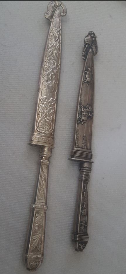

Old 19th March 2023, 04:16 PM   #5

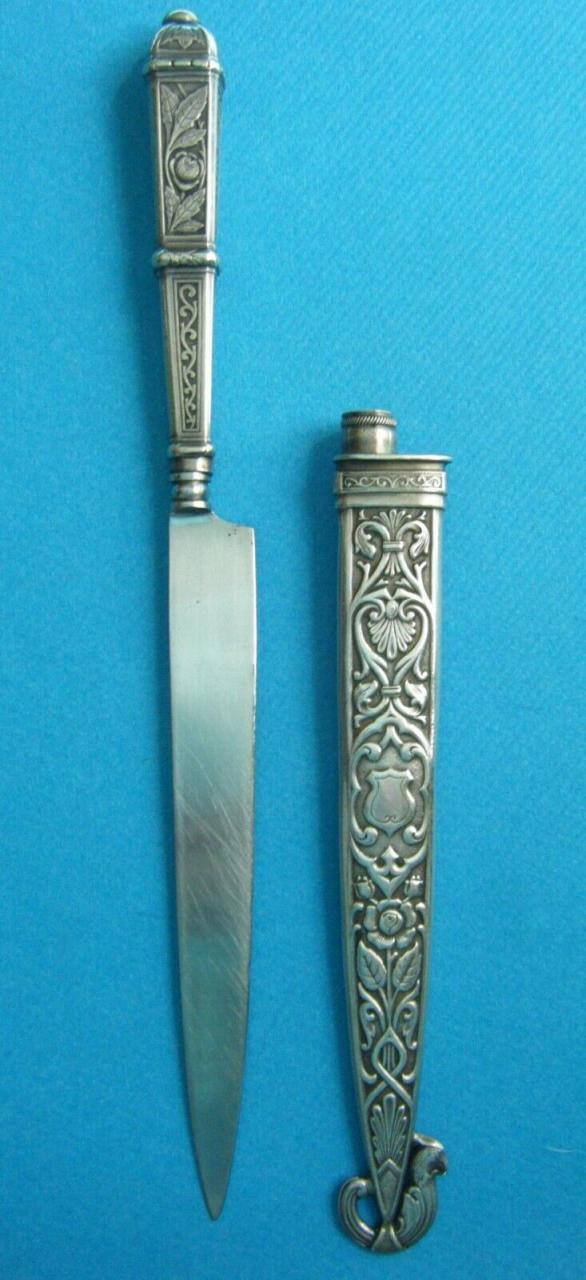

Hi Gunar,
Is the scabbard and handle silver plated or from German silver? I guess that your example is from the mid. of 20th century. I have a very similar example which I guess is a little bit older, scabbard and handle are thick silver plated, I have shown it in this thread: http://www.vikingsword.com/vb/showthread.php?t=28632
Compare the bird at the scabbard foot.

Yours is indeed beautiful, Detlef !
To answer your question on silver or alpaca silver or silver plated, I have to wait until I hold it in my hands (which may take a couple of weeks as it just left South America and was send by Fedex; hence going first to the good ol’ U S of A as point of transshipment).
In my opinion mine might be made between 1950-1970, but it definitely originates from Uruguay. What I also noticed that one hardly see longer gaucho knives than 30 cm on offer for sales ; the long( er) ones you see on the pictures in the wide leather belts of the men .

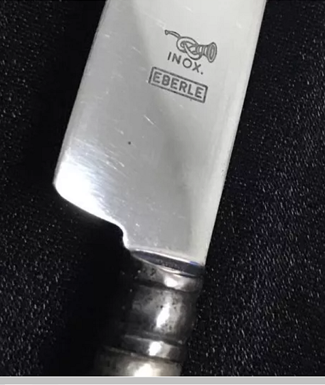

Hi `gp'
Going by the maker's brand and the `boton', I have the feeling that your knife was made by the Brazilian cutler Eberle which went out of business in 1984, being taken over by another company.
My guess us that the logo Eberle was polished out of the blade.
I looked around in Spanish and could not find anything on Trompeta brand.
Cheers
Chris

Old 12th April 2023, 03:05 PM   #12
gp
gp's Avatar
Join Date: May 2020
Posts: 1,039

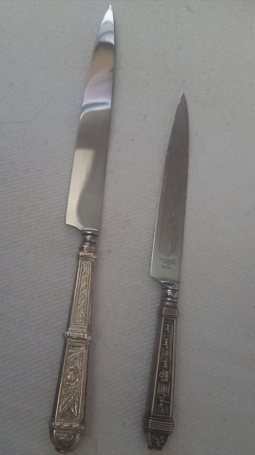

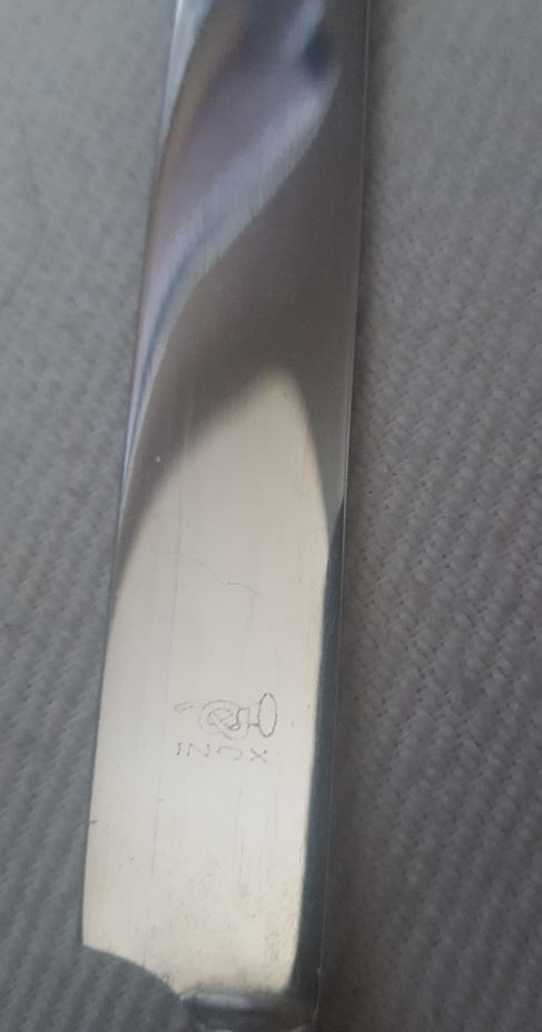

Hi Chris,
they arrived ; the seller offered me a 2nd one, which I gladly took.
Unfortunately no "Eberle" sign on both of them or trace that it ever had been there...
best regards
Gunar
Old 14th April 2023, 03:52 AM   #13
Chris Evans
Join Date: Mar 2005
Location: Australia
Posts: 685
Hi Gunar,
Thank you for posting details of the knife and congratulations on your new acquisition.
The horn seems identical to the one with the `EBERLE', so my guess is that it was marketed by the company that took over that firm.
Cheers
Chris

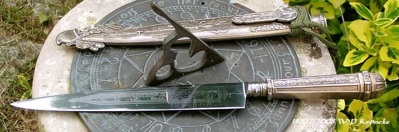

My knotted bugle one and a couple more EDC, less formal ones, not Uruguayan. Both are Argy ones if I recall.
