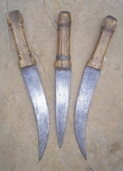

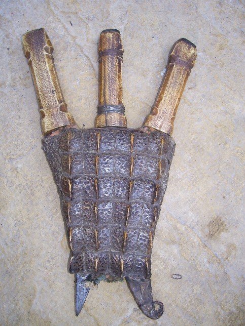

Recently acquired a set of triple daggers , tempered steel blades with Arabic (Thuluth ?) script. The handles seem to be horn and the set have definate age....but how old ..I have no idea.
Straight dagger... 15cms blade...26cms overall
curved daggers.. approx 19cms blade.....approx 30 cms overall.

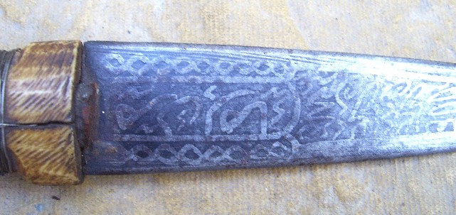

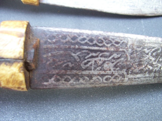

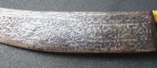

It would be very much appreciated if someone could translate the script for me....pretty please...However, the script isn't to clear in the photos and will try to enhance the script so it can be more easily read, and will post later.
I would also like to repair the missing 'tails' of the scabbard, any suggestions? or should I leave it 'as is' ?
Please comments, suggestions etc gratefully received, thankyou

Old 27th July 2006, 04:04 PM   #2
A NICE SET THERE IS A OLD POST IN THE ARCHIVES ON THIS TYPE OF ITEM WHICH DOES GIVE A TIME FRAME OF WHEN THEY WERE MADE. UNFORTUNATELY I DON'T REMEMBER WHAT WAS SAID OR WHAT THE TOPIC WAS. PERHAPS A SEARCH UNDER 3 DAGGER SET AND CROCODILE MIGHT TURN IT UP. THE SCABBARD TIP WOULD BE DIFFICULT TO REPAIR AS RAW CROCODILE SKIN WILL BE DIFFICULT TO COME ACROSS, YOU CAN SOMETIMES FIND A OLD PURSE OR SHOES AT A THRIFT STORE OR ESTATE SALE TO CUT UP AND USE BUT THAT LEATHER IS TANNED AND WILL NOT MATCH. SEARCH ON EBAY UNDER TAXIDERMY, CROCODILE ECT YOU NIGHT TURN UP SOMETHING. YOUR EXAMPLE IS INTERESTING IN THAT IT MAY HAVE ACTUALLY BEEN USED NOT JUST SOLD TO A TOURIST, IF THE REPAIR TO THE MIDDLE DAGGER HANDLE IS A NATIVE REPAIR IT MAY HAVE BEEN CARRIED AT SOME TIME. IT ALSO APPEARS ONE HANDLE HAD TO BE REPLACED AS IT DOSEN'T MATCH THE OTHER TWO.
By what I can tell, the repair is very old and definately looks 'native'. The knives are sturdy and still fairly sharp, doubled edged on the straight dagger and single on the curved versions. The Islamic script is 'worn' which suggests that the knives have been removed/replaced in the sheath on many , many occasions.. They 'feel' used....the handle of one is slightly larger, interestingly the blade in this one is lose, ....suggesting replacement?
How can I identify the handle material i.e bone or horn?

ALL THOSE I HAVE SEEN HAVE HAD BONE HANDLES LIKE YOURS. NOTE THE WEDGE DRIVEN IN BY THE BLADE OF THE DAMAGED HANDLE, THE BLADE MAY HAVE BEEN LOOSE AND DRIVING IN THE WEDGE TO TIGHTEN IT MAY HAVE CAUSED THE SPLIT WHICH IN TURN HAD TO BE FIXED WITH THE WIRE. OR THE SPLIT MIGHT HAVE OCCURED FIRST, THE BEST WAY TO FIX A LOOSE BLADE IS WITH SOME PITCH OR EVEN A FOLDED PIECE OF PAPER NOT A HARD WEDGE.
You are right, the wooden wedges are an old repair and not consistant with the curved daggers which seem to have pitch or resin to secure the blades.
I am wondering whether the bone is from a crocodile...perhaps from the leg.
Failing that I suppose it could be camel, goat or cow.... without DNA anaylasis I suspect I will never know.......
