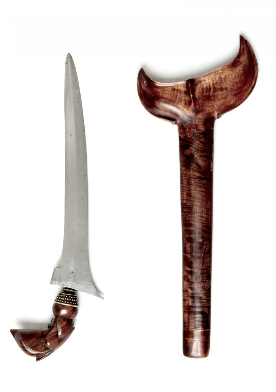

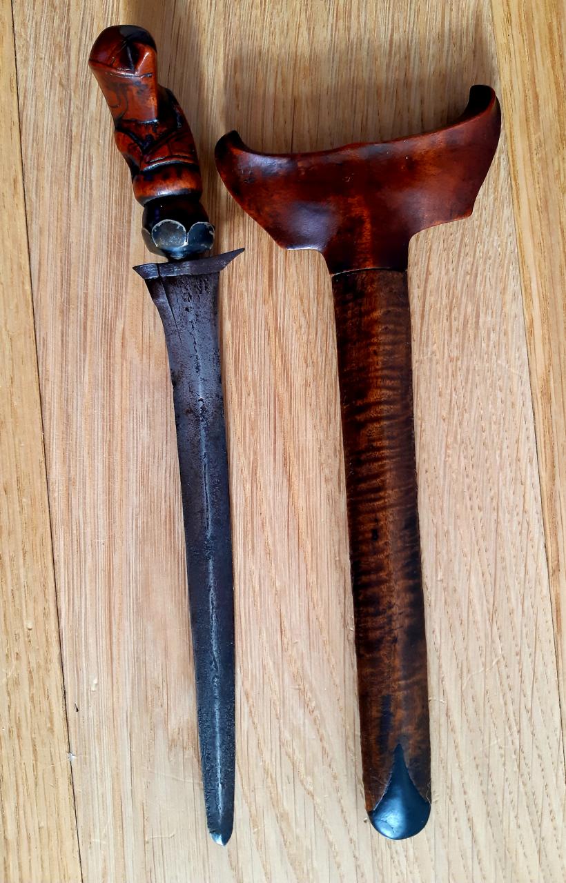

Hello
Please could you advise me on this keris? 18cm long blade length including ganja. The scabbard reminds me of the Tajong keris type. There is no pamor on this blade. Any age estimate? This is one of the first keris that came my way and I am quite attached to it.

Interesting and unusual small keris, my best guess about its origin is Jambi or South Sumatra (Bengkulu), and my age estimate about 100 years old. Is the blade fitting neatly into the scabbard? Other opinions are welcome

These small and simple blades do pop up once in a while. Often they are from modern monosteel while a few sport laminated blades; the gonjo of yours is definitely laminated.
I'd like to see more close-ups: A top view of the scabbard and all sides of the hilt might help.

The scabbard definitely seems to be from Sumatra as that inserted toe of horn is a common feature. Lovely wood on the stem which i assume displays chatoyancy.
I see no reason to assume the blade is modern monosteel. It seems to have some legitimate age as well.
While it's difficult to place the origins of blades like this, that are obviously made far outside the standards of any court, it seems somewhat safe to place it in the same area as sheath if indeed it appears the sheath was constructed specifically for it. So South Sumatra is at least a good starting point.

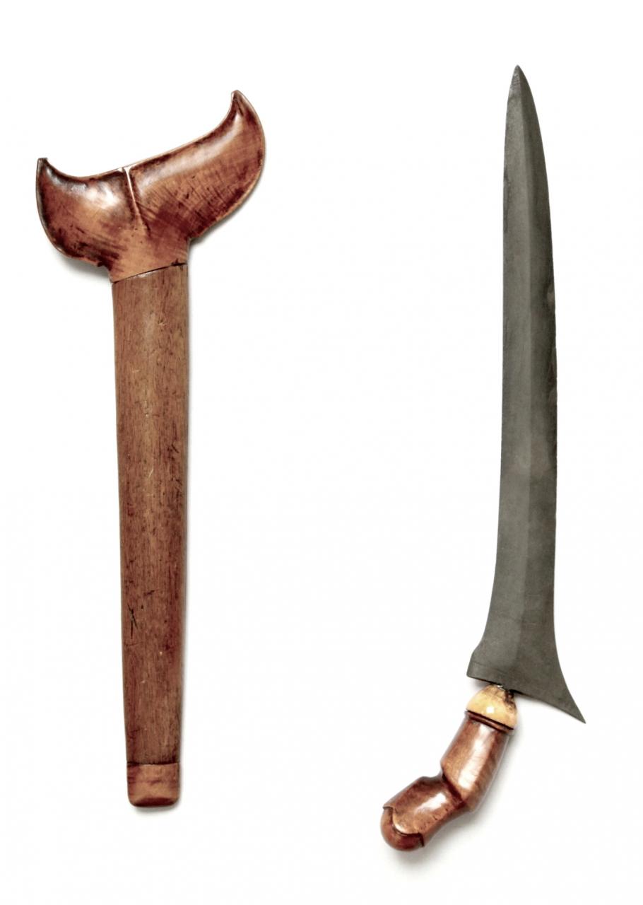

Two somewhat similar blades for reference.

Yes, my blades are more refined than SidJ's one (work from a village smith?) but they bear some similarities IMO.

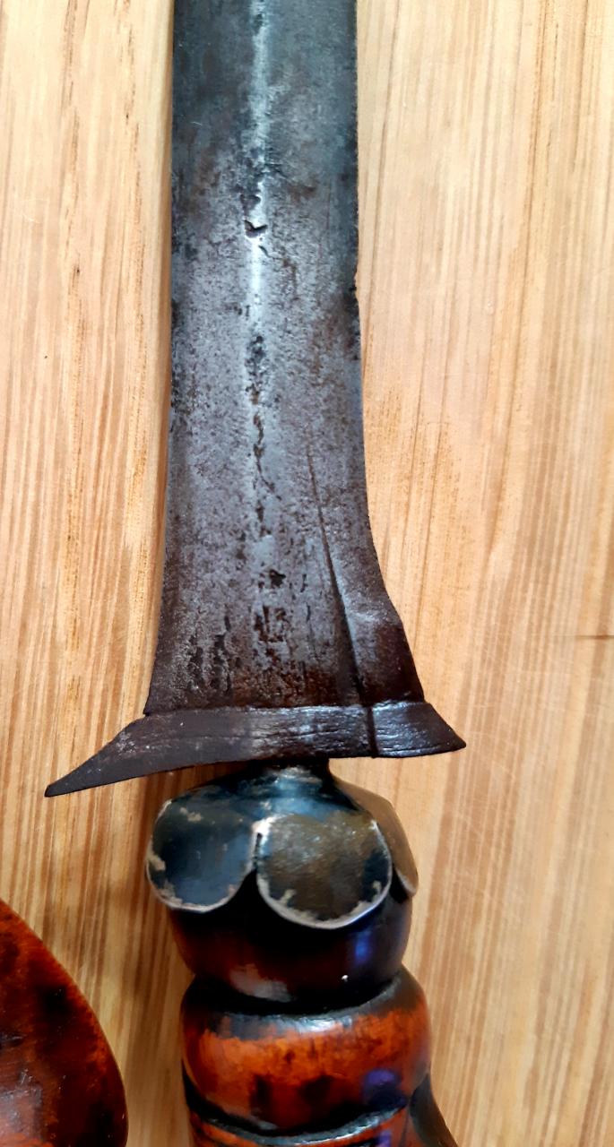

I do own my fair share of 'villager keris' though I am not sure what this term means and if it is to be contrasted with more sophisticated ' city keris'. But in this case its worth pointing out that the ganja appears to be a different composition than the blade. The scabbard is also very well made of very good timber with a buntet. The hulu too is well carved and of good wood. It seems to me to be fairly decent overall with attention to detail in its manufacture. I am not therefore clear in which area it lacks refinement.
Could you provide the pics, please? It's really tough to discuss missing evidence...

Sid, could you please add pics of all sides of the hilt as well as a top view of the crosspiece (without blade)?
