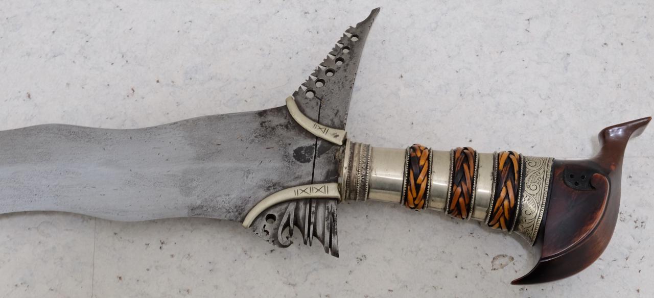

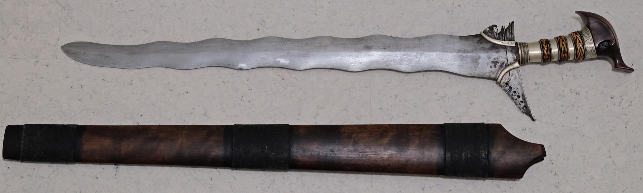

I have acquired this Kris some time ago, it is one of my favourite pieces in my Kris collection but the only kris from the Philippines.
I believe this is a Maguindanao kris.
It is a large blade, measuring 62cm the blade alone (77 from tip to heft finial ).
It has 13 luks and shows signs of laminations ( which may be brought to show more but I am unsure on how to go about staining this kris).
Weight about 1,1Kg (without the scabbard)
It would have required a warrior to be well built to wield this sword.

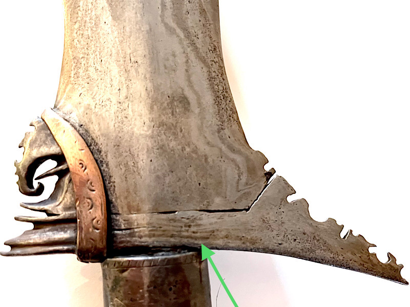

Does this blade have a separate gangya? In the photos it appears to just be a well incised line.
If you want to try to bring out the lamination i believe most folks use vinegar for a light etch.

Posts: 4,736
Milandro,

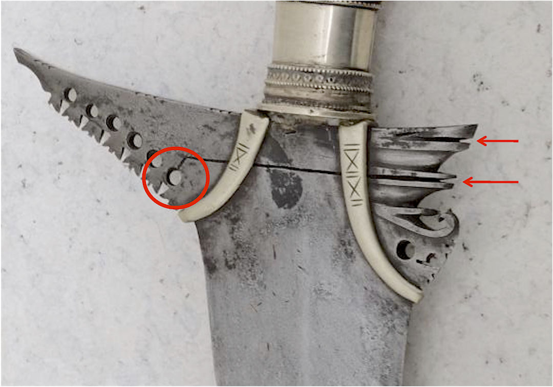

I think you will find that the gangya is, in fact, separate. It can be hard to tell without taking the piece apart. Almost all of the ones I have seen without a separate gangya were made of monosteel and the asang asang were either missing or very crudely made--definitely lower grade examples for the most part. Your kris is a nice one, and first half 20th C. IMO.

Can you confirm this one way or the other. To me i see a dark incised line on one side of the first hole in the "greneng" area, but it does not seem to continue on the other side of the hole. Close-ups of the area would be helpful.

I'll agree with Ian, with one addition - at the mounts appear a little more recent that that, and might even be later Maranao (Marawi) made mounts on this Maguindanao piece.

The " cutting" line appears to go through the last hole too, but this may be completely vestigial (I will ad up a picture at some point). Certainly cannot figure how to detach it , and the hilt is firm in place. So, I'd go with a vestigial line.
If this was made into two different pieces fitting it together with such a precision would have been a work of art in itself.
While researching this kris, on the forum and elsewhere, I found a large number of krises such as mine (or so they look to me) all indicated as Maguindanao from several auction houses (although the style of the picture taking appears to be very similar).
Most if not all seemed (to me) to have some age to it and showed what appears to be a vestigial incision of the ganja. (am I at liberty to post pictures of these krises since all the auctions seem to have been completed?)
I have seen that on previous thread here too there is a debate on the meaning of this cutting line ( real or vestigial) in terms of timeline.

I would refrain from taking it apart just to find out if has a separate ganya. It’s difficult to put it back together properly.
Have you tried pouring hot water on it, sometimes that would reveal the welding pattern on the blade and ganya. As an alternative, warm household vinegar.
Welding pattern will differ (in my experience), with the blade proper and ganya.

I agree with Albert that reading the grain of the metal is the least intrusive approach to ascertain a separate katik/gangya (in most kris blades).
It's usually not necessary to fully clean the blade or even do a gentle polish (if only a window across the line). A gentle etch with hot water or some weak acid often enough does the trick. A good magnifying glass (10x loupe) is one of the best investments for avid collectors.

Your blade does strike me as certain 20th century blade: the waves are quite pointy and the base features with no apparent wear; also stylistically the thick gandik side does look quite modern (at a high level of craftsmanship for any later period though!).
If I had to guess, I'd expect this to be an engraved "separation" line rather than real: The bold line (of consistent width and wide even for worn blades) and an invisible line at the distal greneng is a bit much to swallow, I'm afraid. As already pointed out, this is not a definite time indicator though.
All fittings are typical for what got exported from Mindanao during the late 20th and early 21st centuries (often via Davao or Manila); presumably mostly Maranao work. They did this restoration/upgrading with whatever pieces became available: Certain antiques, vintage, more recent and apparently also new blades. The wooden pommel looks pretty good - while I tend towards a modern origin, I can't rule out a fully refurbished older piece from the pics. I understand that quite some of these pieces were for local use and not only export.

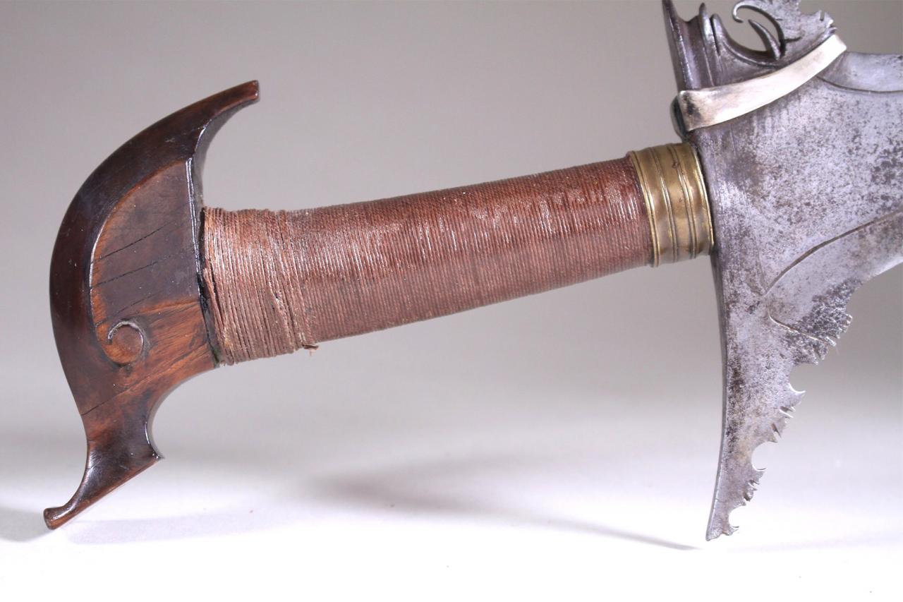

I took one of your pics, cropped and enlarged it, and rotated the pic to orient the gangya horizontally (as we usually view it). This is a good quality picture to consider whether the gangya is separate. The red arrows on the right indicate two areas that have been filed similarly. The top one is clearly not detached, so the bottom one is consistent with it also not being detached (although it may still be). The red circle on the left highlights the down-turned line that may be engraved or a line of separation. To my eyes it does not appear to pass through all structures, and is therefore not a line of separation, although cleaning off some of the oxidation within the small circular area (that a line of separation would have to pass through) would give you a definitive answer. Just some rolled up 220 grit sandpaper worked around in there would be sufficient to get a better look inside that drilled hole. You might also look to see if the lines on each side meet the greneng in the same place.
Old 2nd February 2023, 09:23 AM   #21

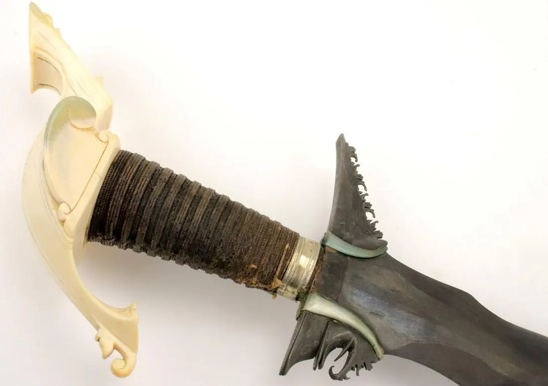

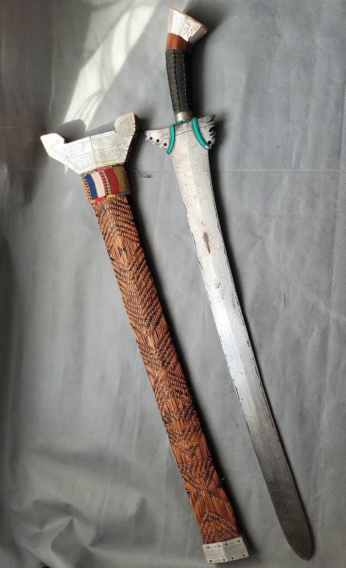

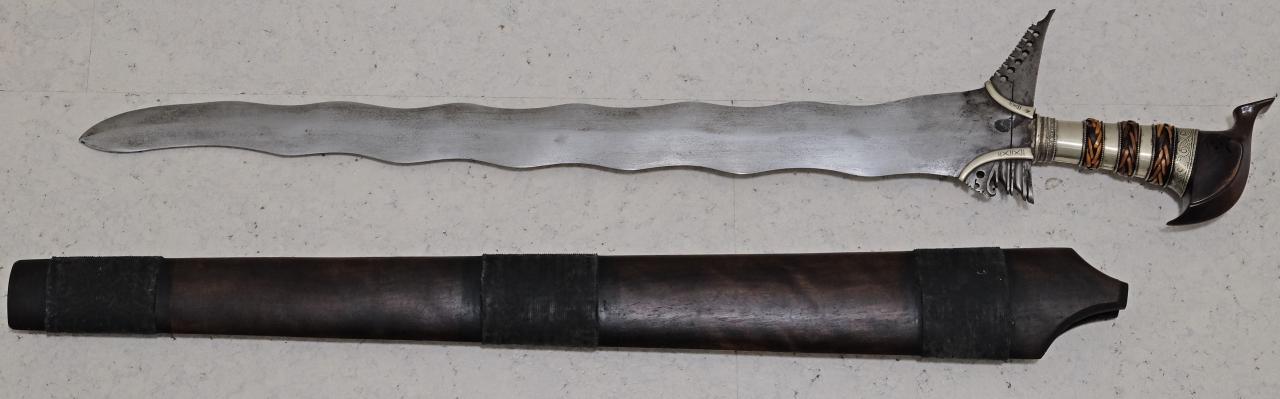

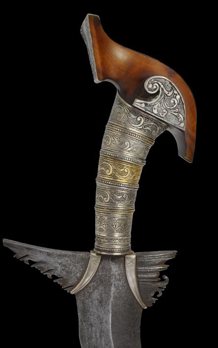

milandro
Join Date: Jan 2022
Location: Netherlands
Posts: 500
I won't try to detach the hilt or anything else on my kris.
This is a 20th century blade, well , so be it. I just don't think this was made yesterday (in fact it was in the previous owner possession for over 50 years and the person wasn't a dealer and I know him to be a reliable person) and regardless of its age , I like it.

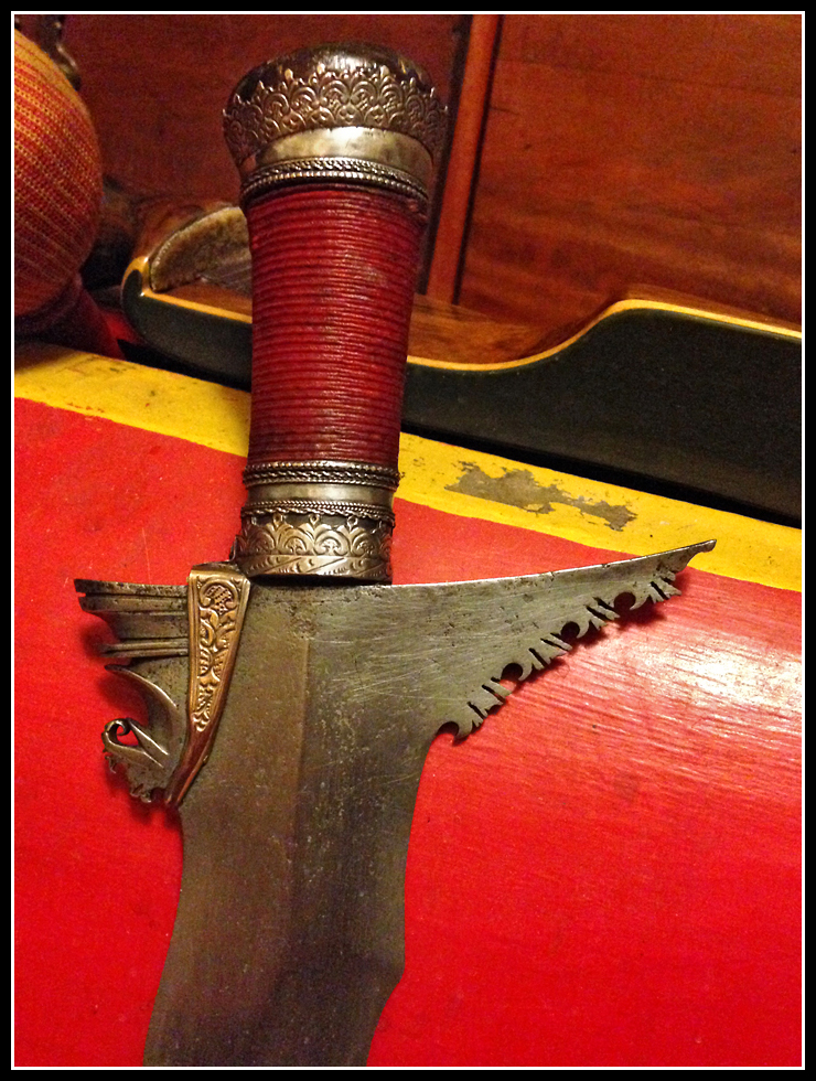

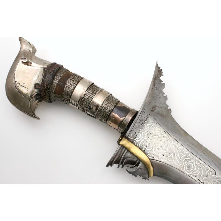

Having said this, I would show some of the pictures of Moro krises (only/ the Ganja for the purpose of this discussion over ganjas and age), which seem to have some age to it and no obvious separation.
I am not saying that my blade is therefore older, I am just showing what I've talked about and which was part of my research on such swords.
The first and last picture look like the the ganjas are made of different metals compared to the rest of the blade BUT the separation (not just a line) is invisible, at least , to me, the other two don't have it or have just a vestigial separation while looking like krises of some age.
Old 2nd February 2023, 04:28 PM   #23
I can understand it and I wouldn't do it as well.
Nothing wrong by this, it's a nice kris and very collectable.
I am sure that the first and last one has a separate ganja, it's just a perfect fit. Also the second example will have a separate ganja, it's just difficult to seen. By the third example I am unsure.
Old 2nd February 2023, 04:37 PM   #24
werecow
werecow's Avatar
Join Date: Sep 2021
Location: Leiden, NL
Posts: 679
It's very thin, but I can see a definite line of separation on the third one (and the first and second as well) on my monitor.
Old 2nd February 2023, 05:43 PM   #25
Posts: 7,297
Milandro, while you will indeed sometimes find an actual gap of separation on old Indonesian kris, i must say that i have rarely, if ever, seen a Moro kris where there is physical separation of the gangya causing a space between the blade and gangya. I would say that on a well made Moro kris you will not see any space between these parts. This may be because the blade and gangya are held together by the asang-asang or it may be because the size of the parts on these larger blades makes the warping of the steel less prevalent. Or perhaps a bot of both. So showing these older keris and speculating that the lines are merely incised into the steel rather than there being a separate gangya does not really provide any evidence of anything in particular IMO.
That said i would say that at least two of these examples are deftly separate gangya and the other two most probably are.
I agree with other statements made about the somewhat pointy luk and the newer looking fittings on your originally shown kris. This is indeed a nicely made sword and indeed worthy of collection. I hate making full assessments without having the weapon in hand, but if push can to shove i would place your kris as post WWII. No, it isn't new. But remember that 50 years ago is 1973. So i don't doubt that your friend could have had this kris that long and it still be a post WWII item.
Old 2nd February 2023, 09:28 PM   #26
Post
Hello Milandro,
I'm with David and the others here: All your examples with a high likelihood of having a separate katik/gangya with #3 being the only one leaving room for some doubt.
As mentioned, Moro kris in good shape often have a hardly visible separation line. Those with an engraved line are actually often way too obvious! OTOH, those with separate piece hardly exhibit more than the example in Albert's post (#14) - the line then usually showing uneven corrosion/loss.
