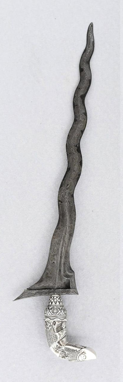

Default Sumatran keris
Do you think this is a Javanese keris bilah, despite being in a Sumatran keris dress.

Despite the Lampung (or perhaps Palembang but I believe is the first) hilt and selut , this is a think, a Javanese or perhaps even more likely Maduran blade.
I have had a couple of similar blades in the past but I din't keep pictures

I'll offer an opinion, with a disclaimer that you probably shouldn't put much stock into it because I'm hoping to use it an opportunity to test myself and see what more experienced members have to say to compare.
I say Javanese based on:
- the long-ish gonjo with the tungkakan and spur ricikan (is this ari pandan). I don't know these to be Sumatran features.
- the boto rubuh blumbangan, which might lend evidence to more specific Javanese classifications like West Jawa/Sunda, except I think maybe the gonjo does not support a West Jawa claim.
jagabuwana is offline   Reply With Quote

In my opinion this type of blade style spreads throughout West Java up to Palembang in Sumatera. There is very little reliable guide can be used to differentiate accurately the origin of the blade. It could well be a Sumatran piece as well as West Java piece. Style indicators can be mixed with pieces from this area.
In my opinion, what is important is that this blade has good quality and the overall blade style and dress matches the possible geographical origin of the keris. No point arguing on the origin of the blade.

That’s a lot to determine from a single over all photo viewed on the internet. Also, I am currently looking at this on my phone, so I don’t have the best view. We all know that certain in areas of Sumatra such as Palembang keris were greatly influenced by Jawa.
I might change my mind later when I can see this photo more closely, but this could very well be a Sumatran blade.

I will also say that if we are to look at a photo and try to assess a keris that the best orientation to do that is with the keris pointing upwards.

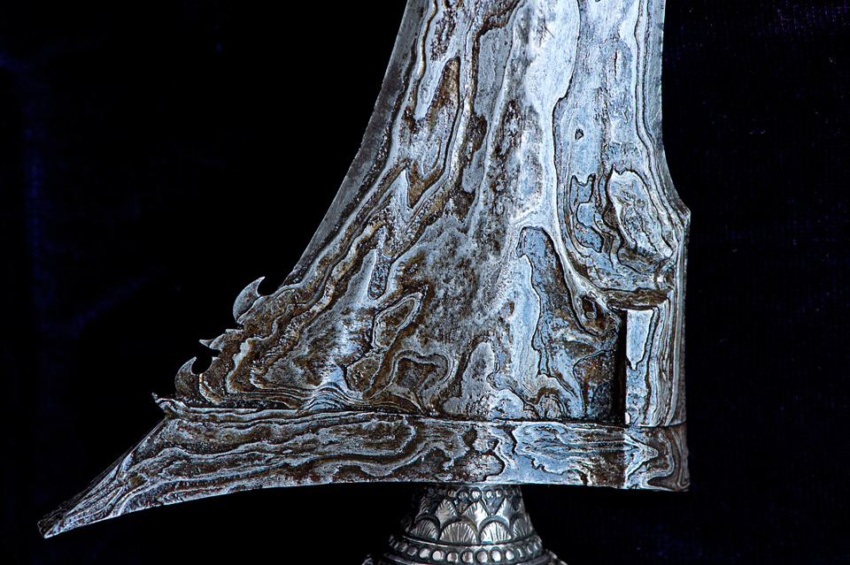

Anthony, has the gonjo been made as a separate forging, and is that forging a complex pamor miring?

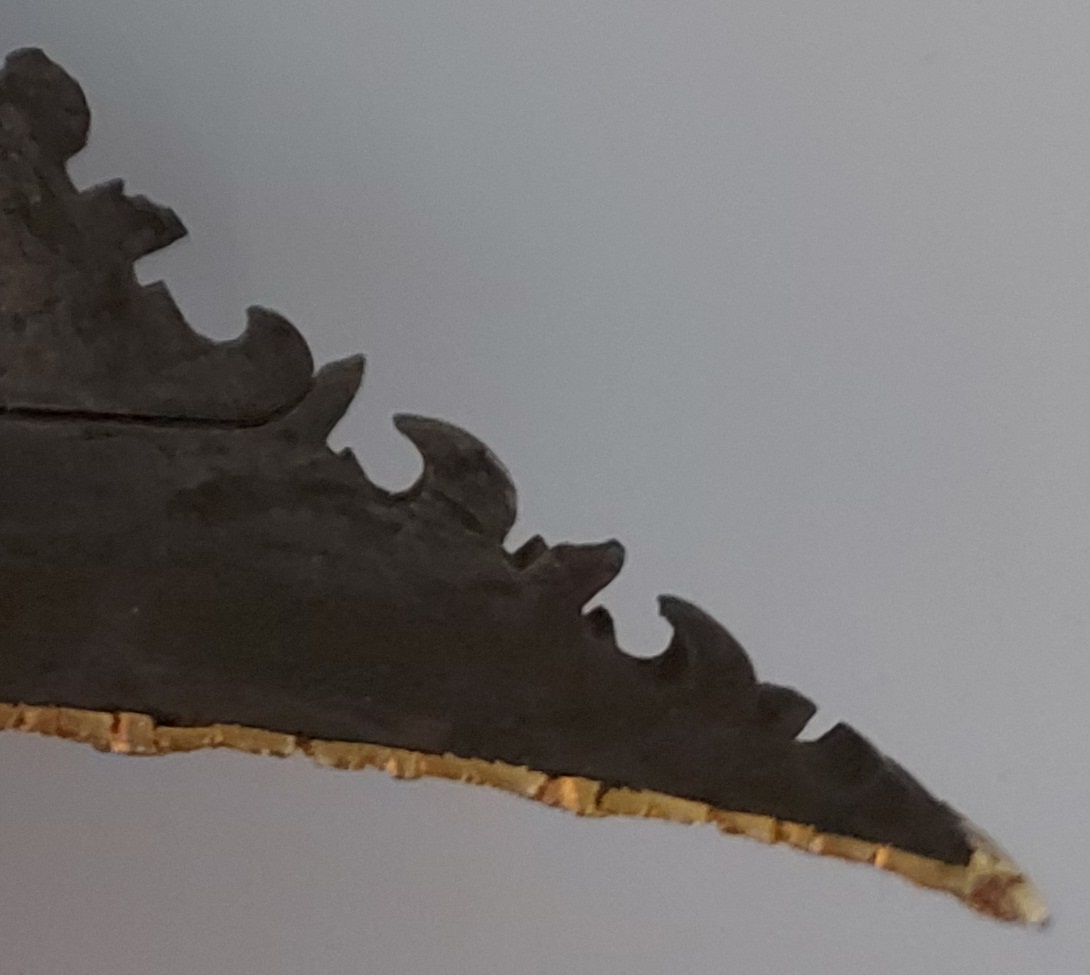

Below is a photo of the greneng of my Palembang keris. The keris has a square blumbangan, and the greneng is Surakarta. The blumbangan is cut in the style of this keris uploaded by Anthony.

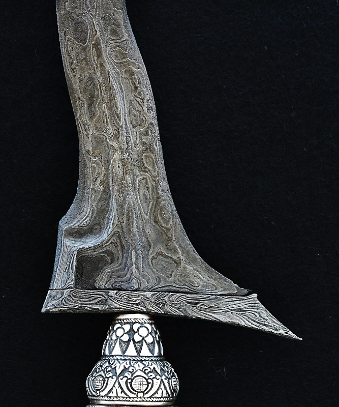

Old 21st January 2023, 11:59 PM   #17
Does the close-up help?
Old 22nd January 2023, 12:07 AM   #18
Hi Alan
Good day. The gonjo is indeed a separate piece and left a bit of gold marking. It is a well forged pamor miring.
Gorgeous!
I agree with Gustav. Blumbangan is actually boto rubuh. So now I think it is West Java.

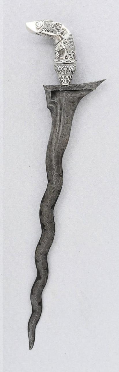

Posts: 7,230
This is what this keris looked like when I had it.

Posts: 470
Yes, that is correct and it is a wonderful piece. Someone told me it is not Sumatran but Javanese keris bilah and that kick me start wondering.
