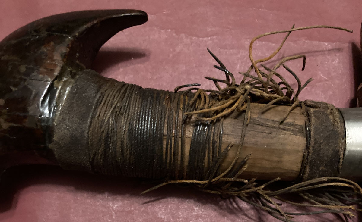

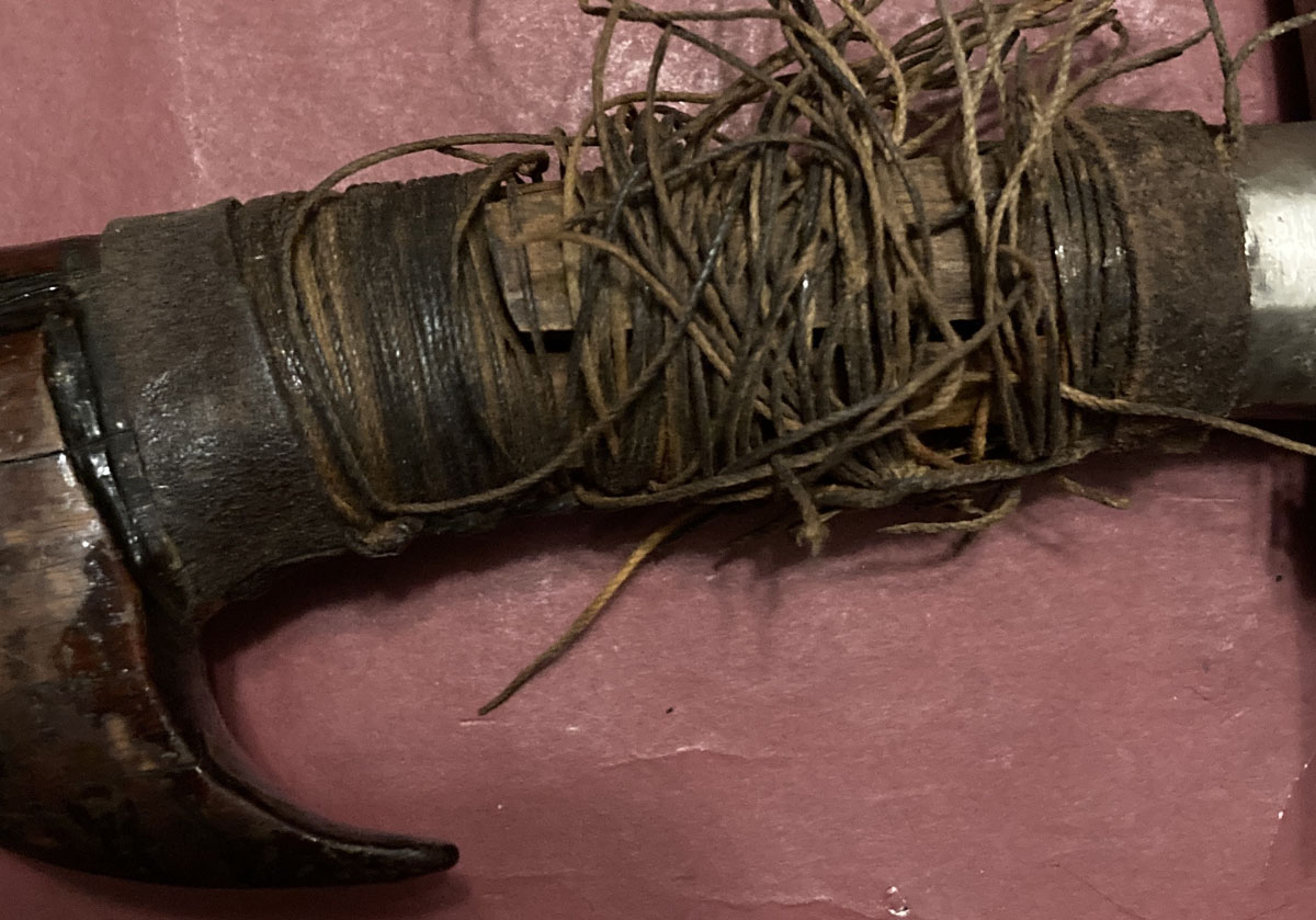

I will either restore (or more likely) replace the hilt cording
It looks like a lost cause: If you decide to go for a re-wrap, make sure to keep the original grip binding with the piece for future reference.
but will leave the leather bands
This leather most certainly is not original. Please post close-ups.

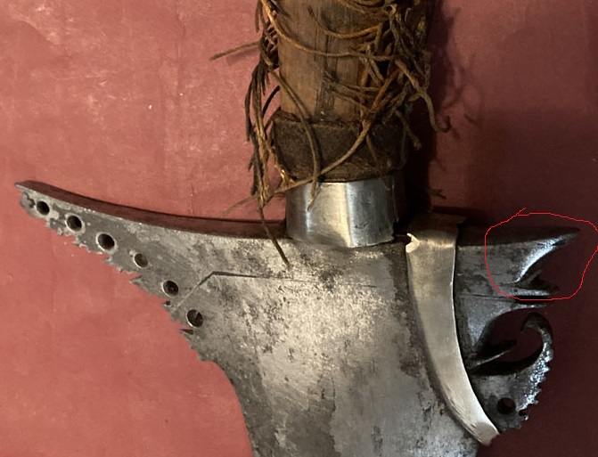

Xasterix you bring up a good point of the fittings. I agree that they are later. You also reminded me that I saw a Maguindanao kris with the exact same shape of wranga and overall scabbard shape. So I stand corrected on the scabbard.
Would you be willing so show what you mean a out the mouth cavity - I can't seem to envision what you are saying.

Here are the close-ups you asked for and they show just how bad the cord wrap is. The cord goes under the leather bands and the bands (made of rough hide) appear to be glued on. I know that leather bands aren’t traditional on kris hilts but I’d be willing to bet that whoever did the cord wrap was Filipino and also added the bands. For that reason, I would like to leave them as part of the blade’s history but I don’t know if I can get them loose to rewrap the hilt without destroying them. If I can’t save them, I’ll replace them with wound or braided rattan because I am sure that the band next to the pommel is needed to hide a join between the pommel and hilt.
Hello sir, sorry I wasn't clear- it's this part, supposedly.
